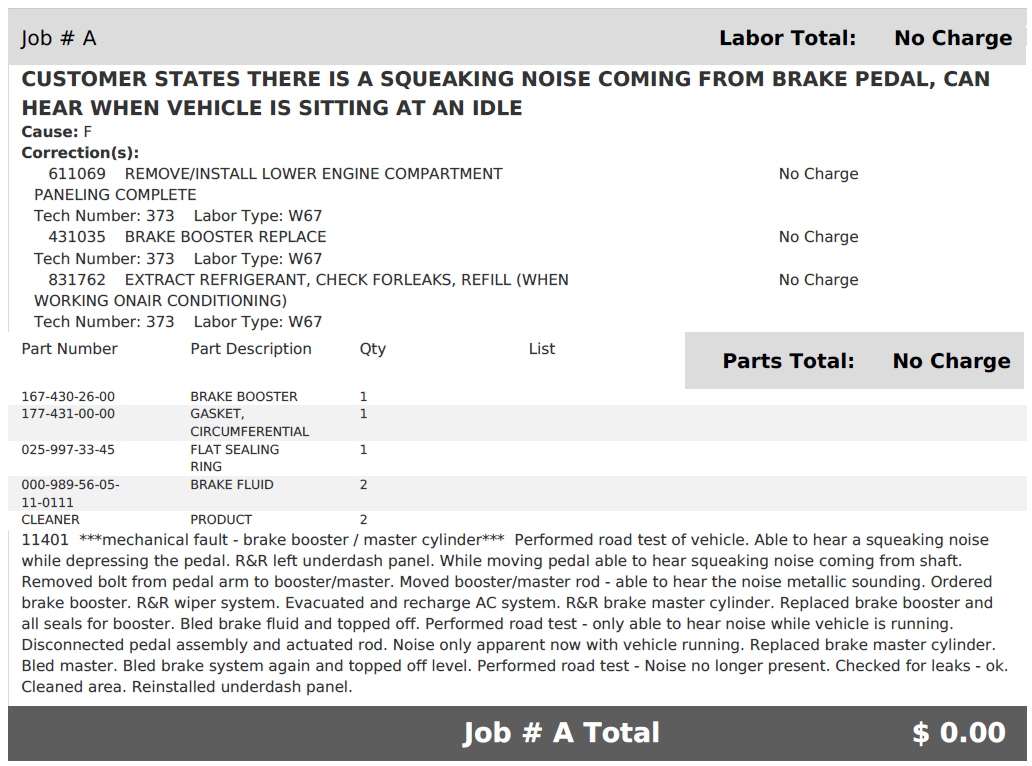

Originally Posted by zaidar61s!
do you by any chance have a document to show what mercedes did to your vehicle under warranty? Would help me as my mercedes dealership have still got my vehicle and are struggling to identify the issues even though i have advised them to look into the booster and mastercylinder
This is what is on my work order. For some reason, the part for the master cylinder wasn't listed, but the note from technician indicated that it was replaced also.
Old Mar 21, 2022 | 08:27 PM
zaidar61s!'s Avatar
Joined: Mar 2022
Posts: 33
Gle 350d
thank you very much mercedes have ordered the booster and master cylinder thanks to this
A update for everyone else. The squeaky sound was usually noticeable when the car was cold. Apparently the noise wasn't heard by the mercedes techs until today when i visited. tech confirmed the noise was present and after showing the repair sheet from zengshengliu they agreed the master cylinder and booster needed replacing.
