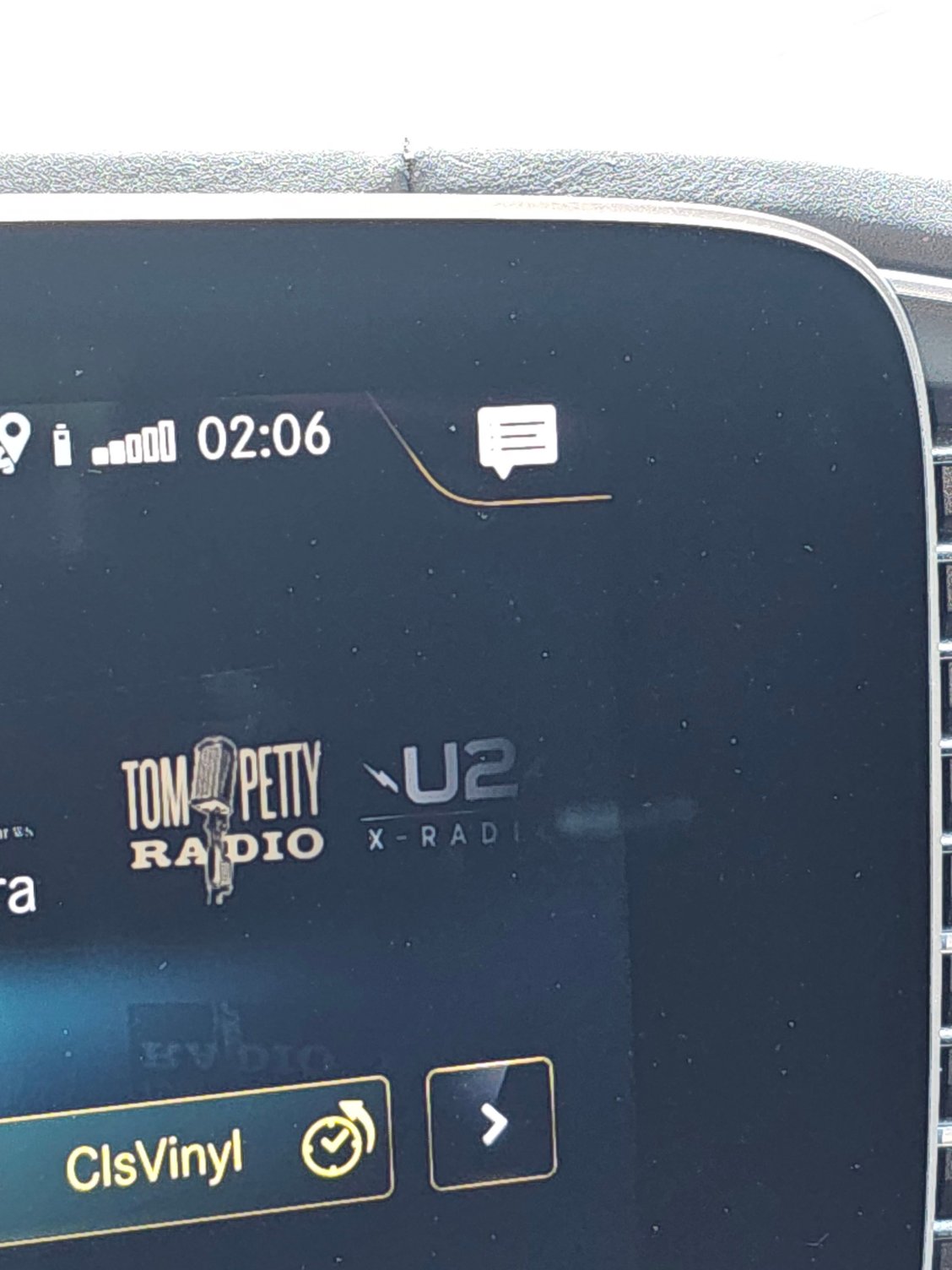

To be clear, it is _not_ this area with the notification icon (to the right of the clock) I was referring to:
But rather the emergency warnings area that is somewhat buried. You have to goto the Radio, then click the list icon at the bottom center icon row on the screen (mine is second in from the left), then click "Emerg. Warnings" and then next screen after that will show anything active. Mine beeps with a tone every time I get in the car if there is something in this Emerg. Warnings list. Once I delete it, the beep goes away. I get the warnings for weather alerts primarily, but I also get a "this is a test of the emergency alert system" like once every 2-3 weeks. Quite annoying but I deal with it.
