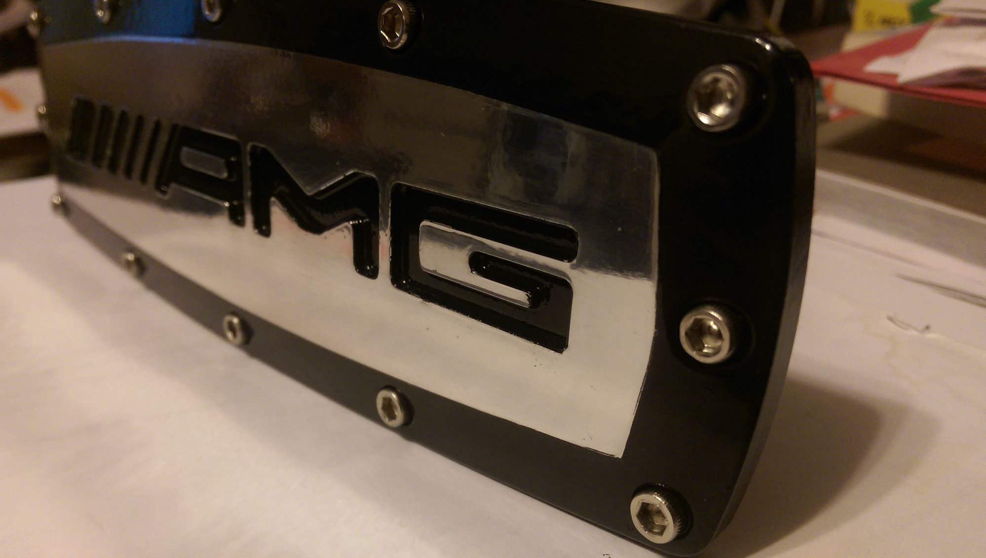

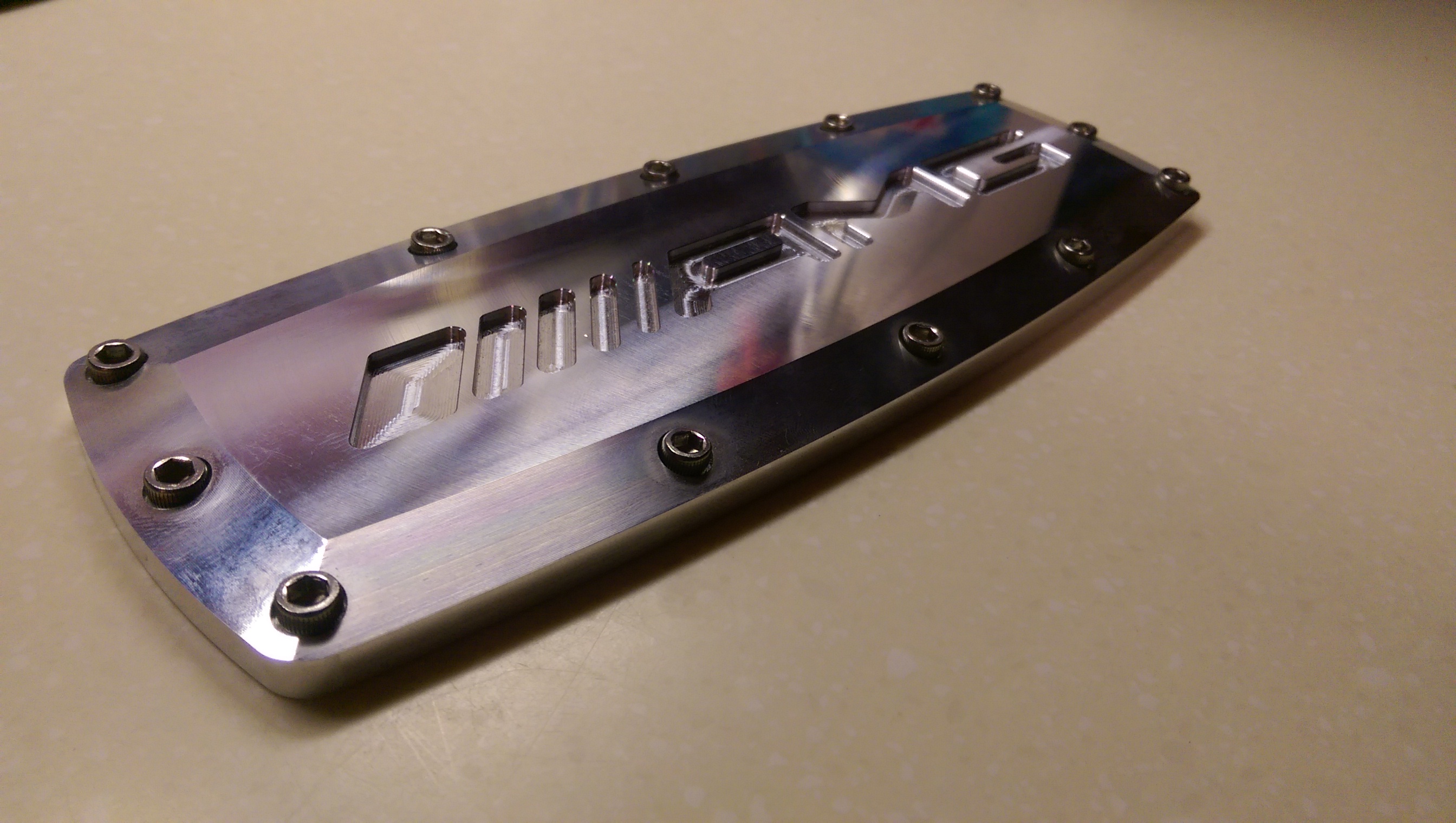

January 19th is the build date for our GLE 43 AMG, and I can hardly wait to pick up this thing!!!
I've actually started on a project that I hope to have completed before we actually pick the vehicle up, which should be next week sometime. I wanted to get an AMG receiver cover, but I couldn't really find anything out there that I liked, so I'm building my own.
Here's some pics of what I have done so far:

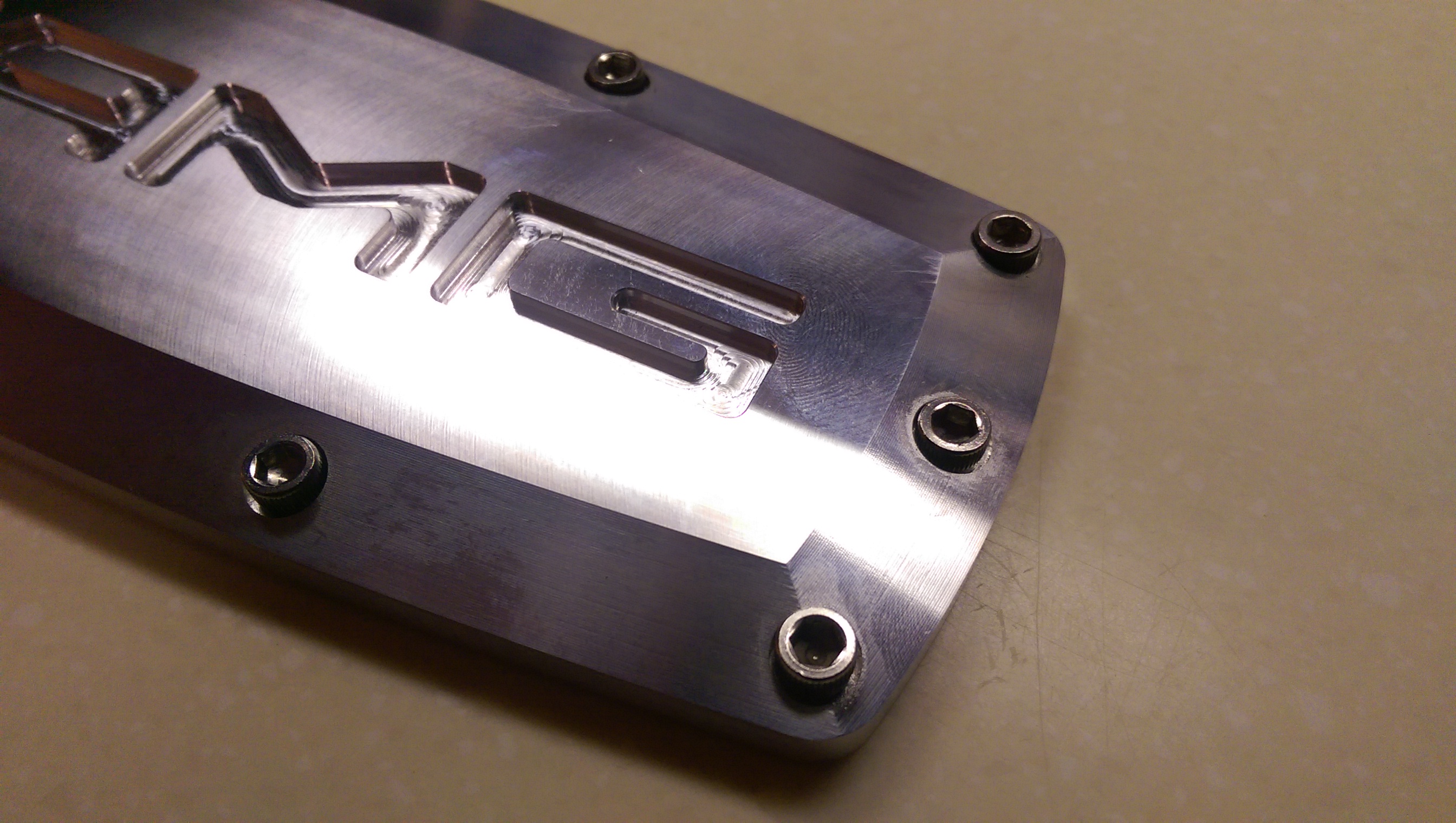

Close up of the machining on the letters:

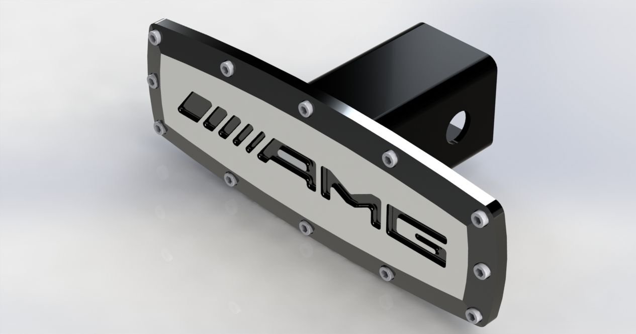

Computer rendered image of what the final product should look like:
Attached Thumbnails AMG hitch receiver cover...-imag0291.jpg   AMG hitch receiver cover...-imag0292.jpg   AMG hitch receiver cover...-imag0290.jpg   AMG hitch receiver cover...-cover_rendered_asm.jpg

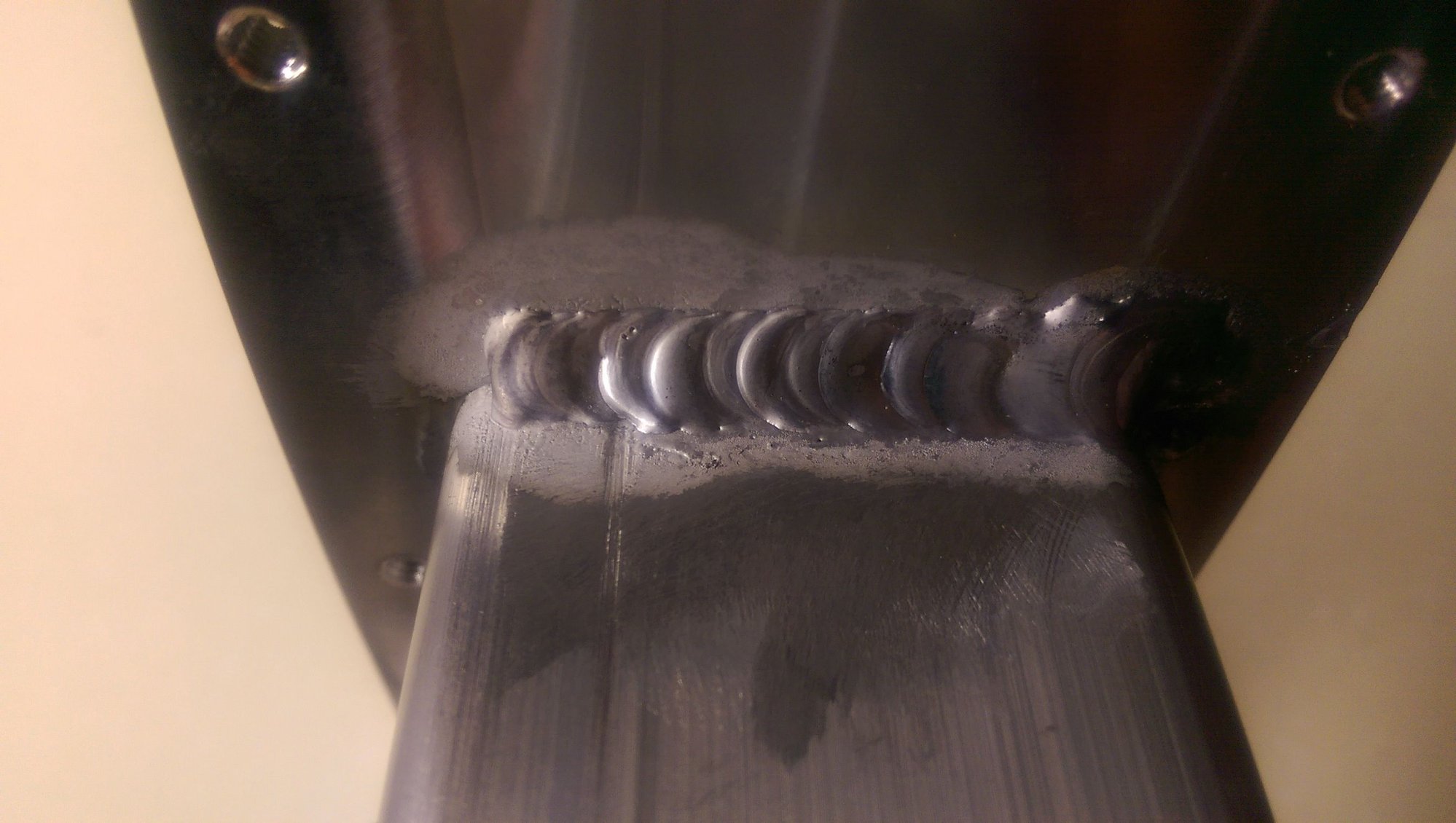

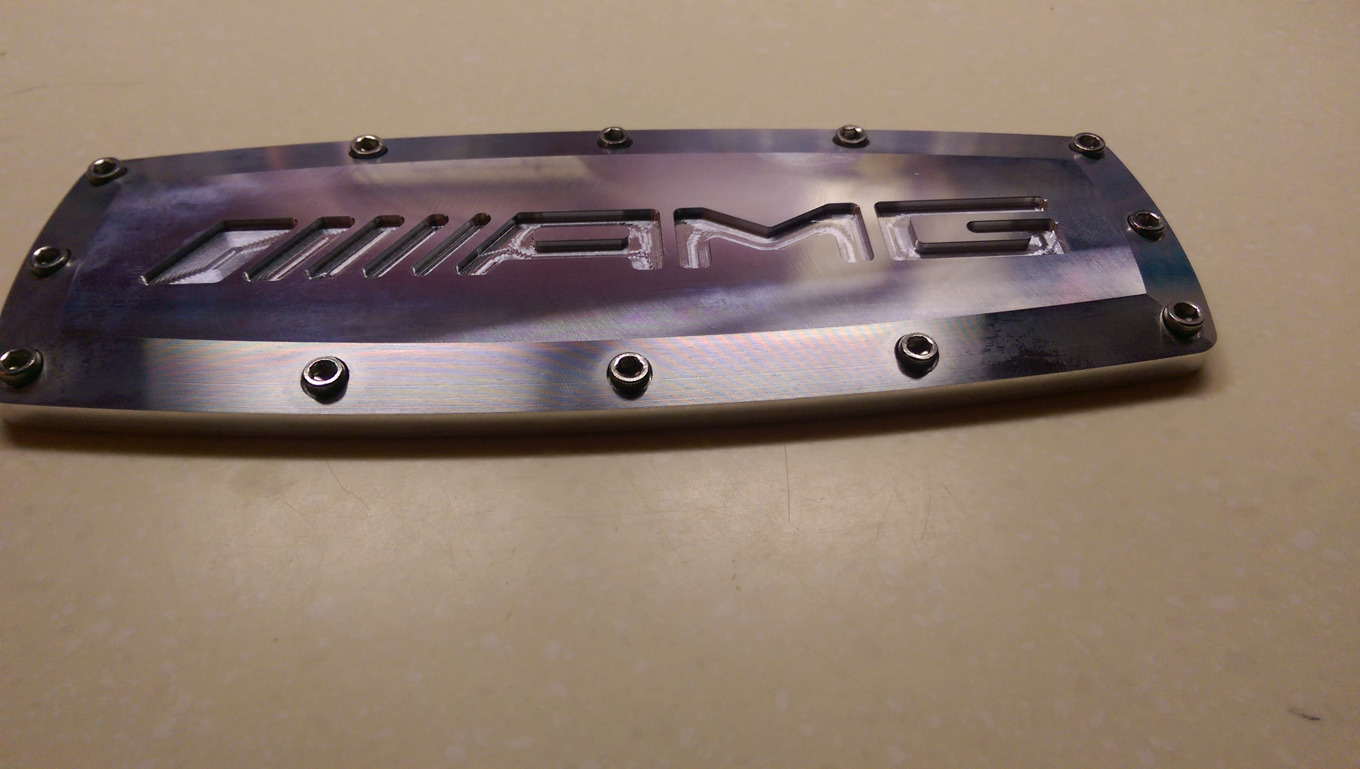

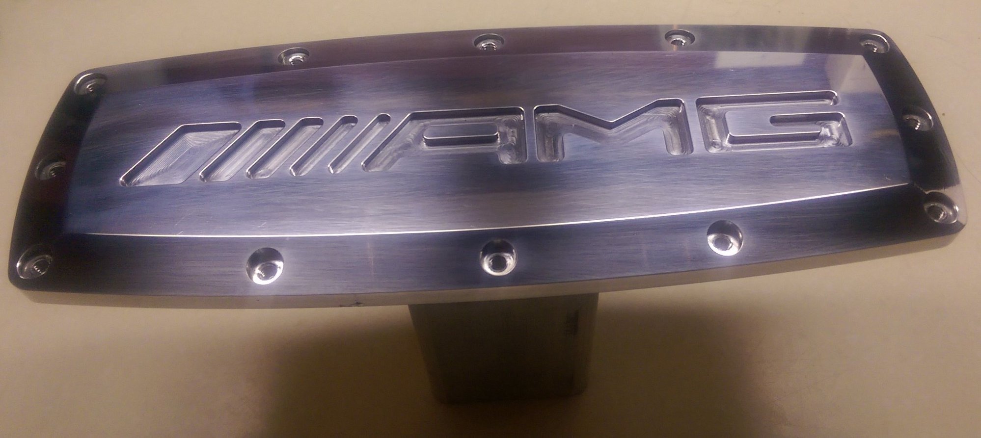

A little more progress today. Got it back from my welder buddy, and he not only did a smash-up job welding it, he polished it for me!! SCORE!!
It's hard to tell in this picture but the face is now polished. I'm hoping that I don't mess it all up when we powder coat it:
Here's a pic of side of the welds that he put on there (I've tried, and I can't do aluminum):
Should get it powdered tomorrow... Fingers crossed...

This looks awesome so far, nice job! Here are a couple "pie in the sky thoughts" ... in your original finished product rendering it appears to be a white "face" around the AMG lettering. You could do one of two things... match that "perimeter" color to your GLE color (not so hard) or have it somehow be bright white LED's that glow red upon braking.... oops it's now a $500 receiver cover!

This looks awesome so far, nice job! Here are a couple "pie in the sky thoughts" ... in your original finished product rendering it appears to be a white "face" around the AMG lettering. ...
While rendering in CAD programs is cool, I can't always make it look like the real thing. Or maybe, I should say, I don't have the patience to jack around with it to make it look like the real thing. Anyhow, that front face is polished aluminum, even in that rendering, it just doesn't display well.
Originally Posted by Boston
... You could do one of two things... match that "perimeter" color to your GLE color (not so hard) ...
Actually for our GLE, the color is matching, at least close. Our Coupe is Obsidian Black, and I'm powder coating the outside in black. Just doesn't have the metal flake. But, it would be easy to change that outside color to match.

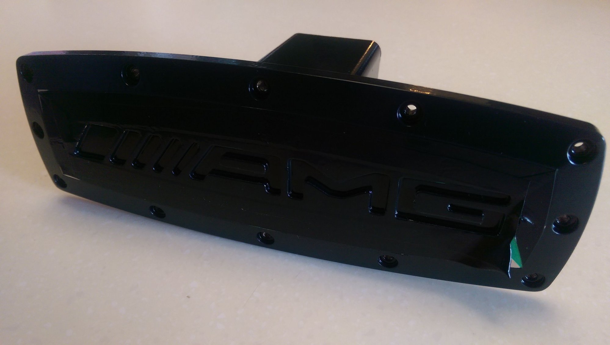

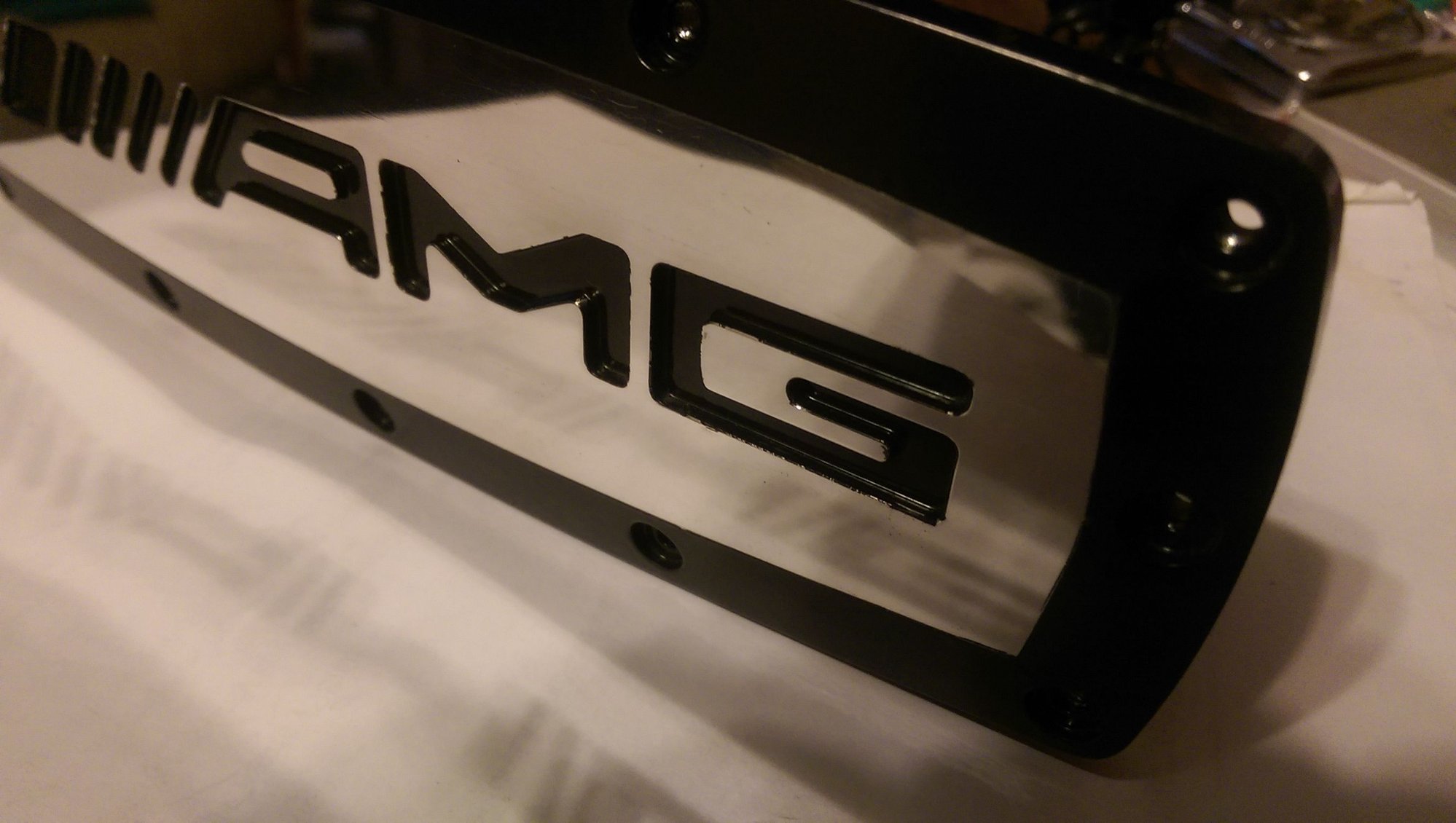

Out of the oven, and appears to be successful! Haven't taken the masking off...
I'm getting pumped!!!

Before removing masking...
Old Jan 21, 2017 | 12:52 PM
cadman_ks's Avatar
Joined: Nov 2016
Posts: 276
Likes: 26
2017 GLE43 Coupe

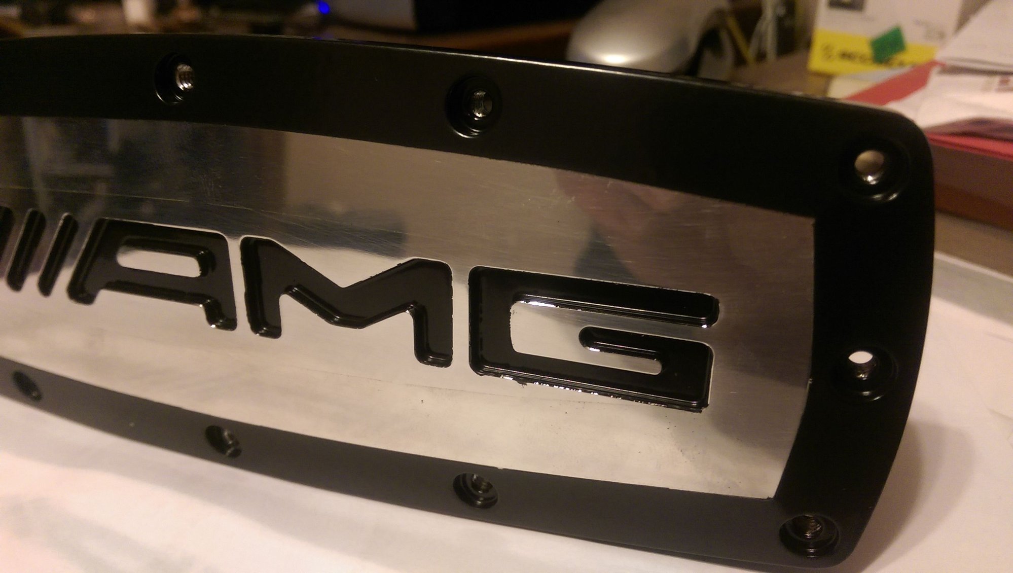

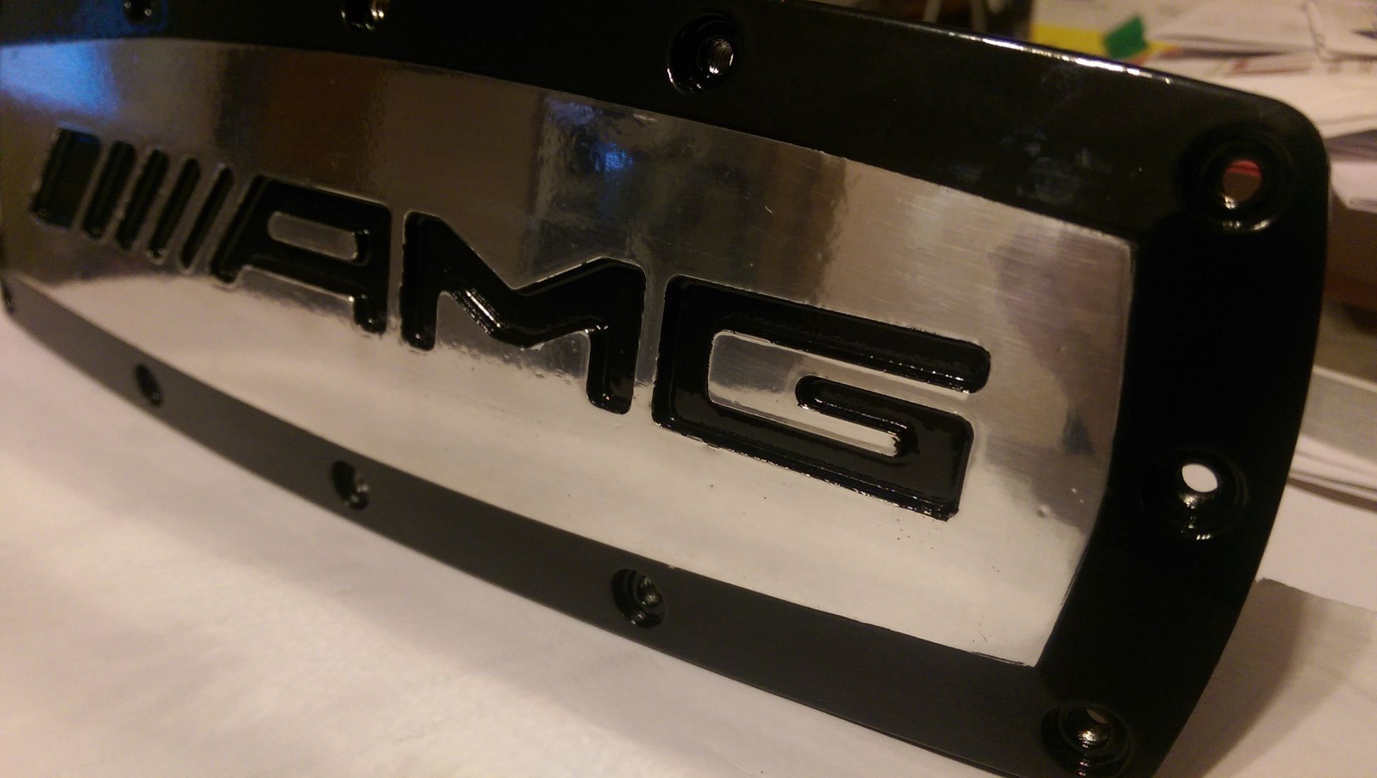

Masking removed, and ready for polishing. I did have a little bit of bleed thru on the letters, and I kind of figured that would happen. I think it will all buff out and be just fine...
Old Jan 21, 2017 | 01:40 PM
cadman_ks's Avatar
Joined: Nov 2016
Posts: 276
Likes: 26
2017 GLE43 Coupe
Same view after final polishing, and before clear coat. Notice that you can see the image in the paper in front.
I have the bleed thru fixed up pretty well. You definitely won't be able to see it from 3' away...

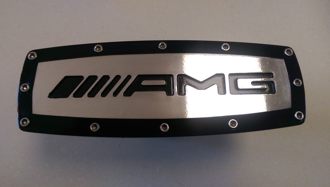

Same view after 4 coats of 2 part automotive clear, and heat soak all night long.
I ended up with a few specs of dirt in the clear coat, and some slight orange peel. The orange peel was a LOT worse after coat 2, but as I put more coats on, it improved dramatically. I was a little bit worried after the second coat. At this point, I'm not going to mess with it. For what the clear coat is doing (protecting the raw aluminum) it's doing a good enough job...
Old Jan 22, 2017 | 12:50 PM
cadman_ks's Avatar
Joined: Nov 2016
Posts: 276
Likes: 26
2017 GLE43 Coupe
Same shot, FINALLY DONE!!!

COMPLETE!!!
Here's a top down shot of what it looks like complete:
IF, I get clearance / approval from MB to make and sell these things, I've learned a couple of things along the way:
  • The milling on the logo will be slightly different. It will have rounded bottoms, as opposed to square cut bottoms
  • I will eliminate the middle hole on the vertical sides. It's too many holes, and they are too close compared to the ones on the horizontal sides
  • The entire thickness will be increased slightly, so that I can use standard socket head cap screws without needing to cut them off. I had to buy longer screws and cut them off, so that they didn't stick out the back. While that worked, that was a TIME consuming process
  • Masking and painting is a TIME consuming process
  • The next ones will be painted completely black, and have the face milled off AFTER painting. Then, I'll make that surface look brushed, and then clear coat
  • All of the tapping needs to be done AFTER powder and clear coat. I've tapped the holes twice
  • There probably won't be any buffing / polishing of anything. Time consuming, and the end product doesn't quite look as good as I had hoped
All-in-all, though, I'm happy with where this one came out for a first try, and it is momma approved, so that's really all that matters!!
I have one final picture to take, and that's with the receiver cover ON the truck. COME ON DELIVERY DATE!! I can't wait!!
