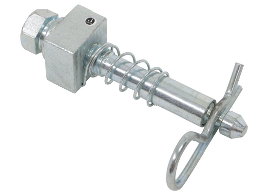

Get an 'anti-rattle hitch pin'. They usually have a spring that allows you to tighten down the hitch pin holding the receiver to the mount, some also include locks. This will eliminate the rattling and noise.
Basic ones look like this, but there are all sorts:
Anti Rattle Hitch Pin

Thanks but the pin is tight. It's the hitch ball carrier square tube that goes into the receiver that's rattling around. The receiver hole is just a little too big for the hitch ball carrier. I bent up an old license plate and stuck it in there as a shim. It seems to be working fine, although I don't use it much. I was mostly interested in knowing whether I was unique or if others had the same thing happening. At least now I know.
This does not address the fact that the German square receiver tube is too large in relation to the North American square drawbar.

Thats exactly what it is for: The anti-rattle Silent Hitch Pin from Let's Go Aero takes the rattle and play out of the connection between your trailer hitch and your ball mount or hitch accessory. The unique design features a sturdy steel block with an attached spring that is designed to sit inside the shank of your hitch-mounted accessory.
Place the block inside your ball mount or hitch accessory and line up the hole in the block with the pin hole in your ball mount. Slide your ball mount into your hitch and insert the hitch pin. To activate the anti-rattle device, just tighten the pin. Doing this will pull the accessory up against the wall of your hitch receiver, thus keeping the accessory from moving around inside your hitch. No more annoying clanking or vibrating.

So it uses friction to clamp the drawbar against the receiver tube. It works if the bolt is sufficiently torqued. Shims or the properly fitting parts (not German ones) are the better solutions.

@Chip Mason , I misunderstood how this worked when I first saw it. While it would eliminate side play I don't see how it mitigates up-down play. The side play isn't what's making most of the racket on mine - it's the up and down play. The device that @Carbon Dated posted would seem to be the better solution. But both of the solutions presented require a lot more fiddling around and tools to install - not really what I would want for the few times when I install/remove the hitch to use the trailer. I have shims made and will continue to use those.
