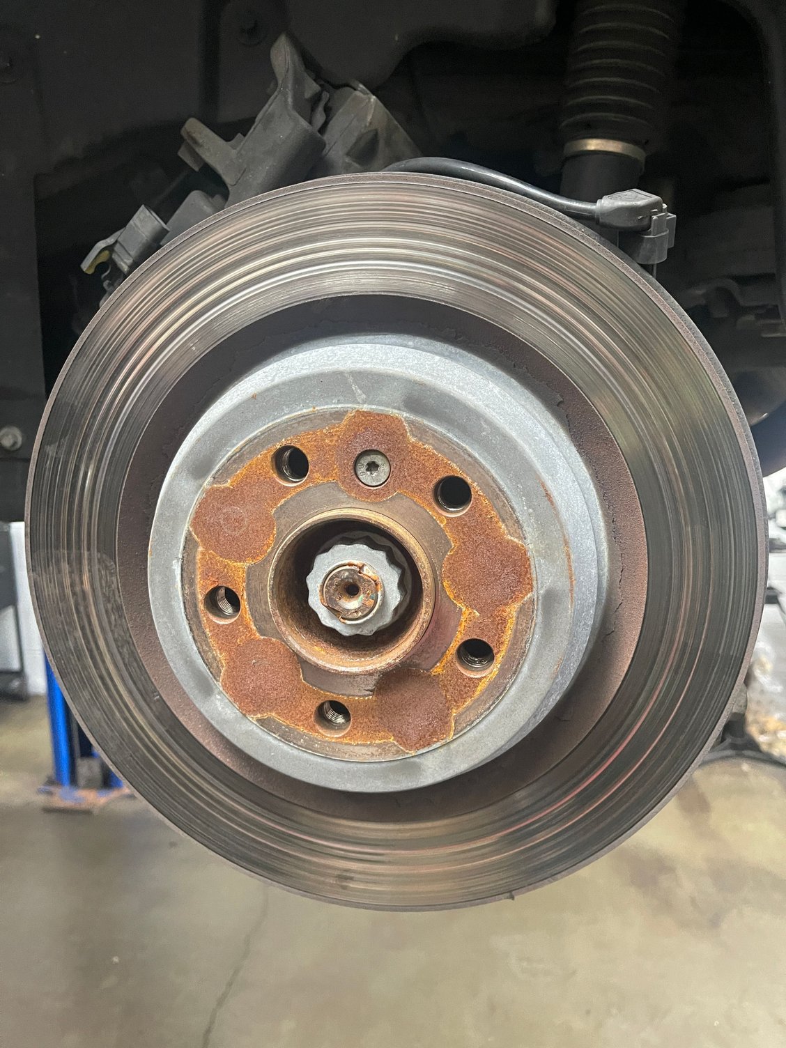

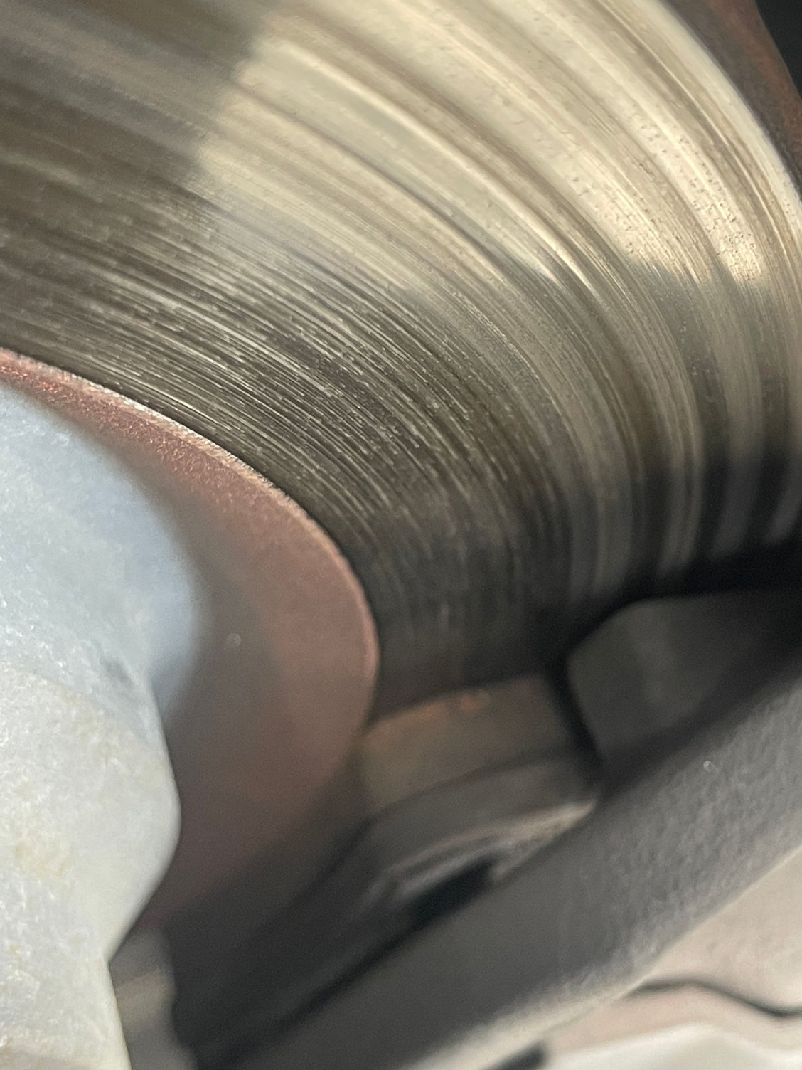

Im now leaning towards a seize caliper
Driver rear
Driver rear
Passenger rear
Passenger rear

I replaced only the driver side rear caliper, rotor, pad, brake hose and cleaned up the brake dust front the hub and dust shield.
Confirm the brake hose collapse because when we try to put air through the brake hose it's being restricted. I'm going to keep monitoring it and if it happens again I be checking the electronic side.

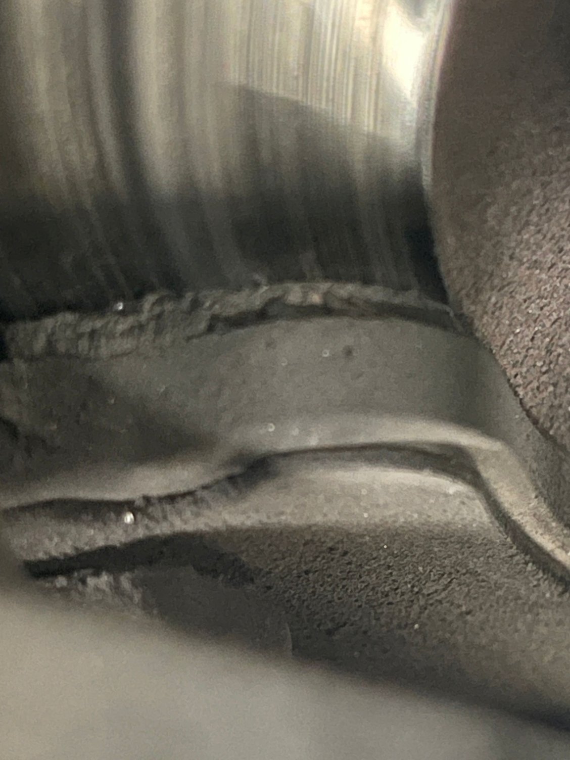

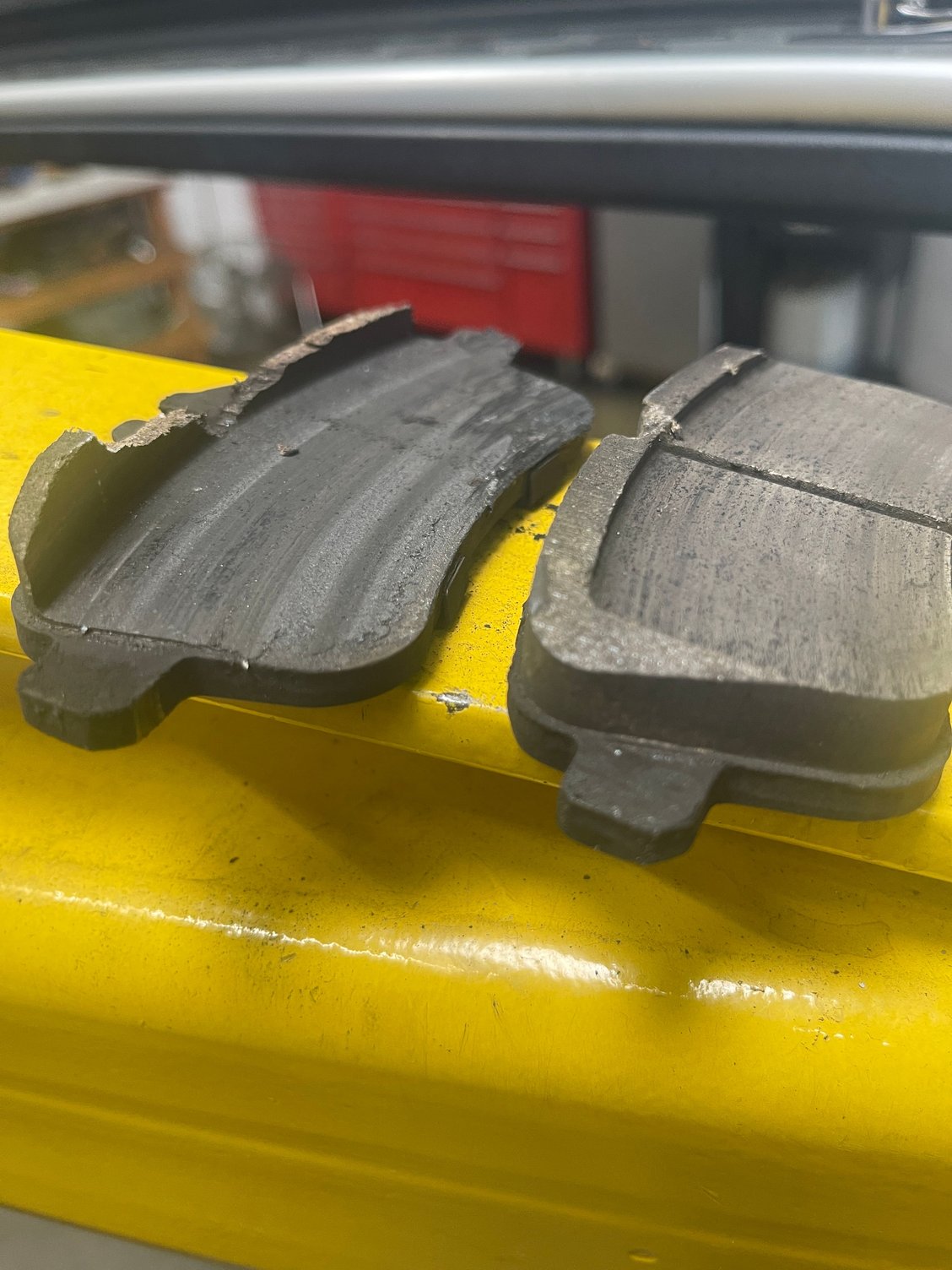

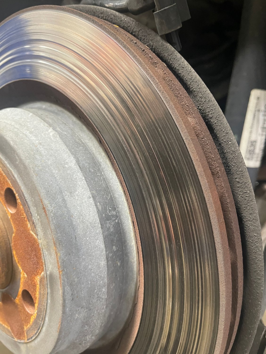

Outer pads destroyed

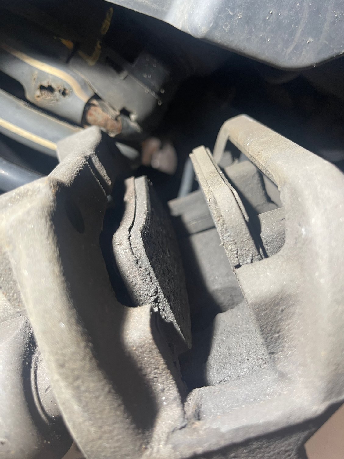

We took so many measurement's and we concluded it was the aftermarket caliper that was installed had the wrong size carrier (mounting bracket). We even order (2) more aftermarket calipers (AMG and non AMG) they all had the same size carrier. I notice the pads had an overhang above the rotor.
We order the correct carrier bought OEM Mercedes out of state since Mercedes in my area only will only sell us a complete caliper.
The GLE is back on the road after being down for 4 days since we were waiting on the carrier to arrive.
Lesson learned check the parts first before installing them. It was the aftermarket manufacture, QA screwed up.
