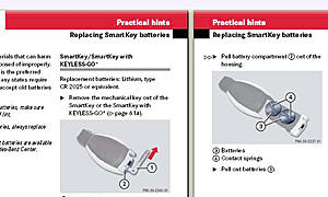

It took me a while to find out that the GLK Keyless-Go equipped SmartKey is different from other SmartKeys as far as changing the battery is concerned:
1. It only uses one 2025 battery instead of two.
2. The cover pops open instead of slides out.
LEFT PICTURE: I have attached below typical instructions (below, screen shot copied from manual) very commonly found on the internet. Unfortunately, they don't apply to our Keyless-Go SmartKey on the GLK. It took me awhile to realize that the battery tray was not going to slide out.

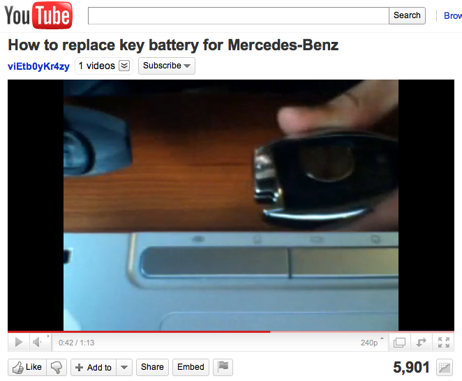

RIGHT PICTURE: Here is the video instruction which works for me:
http://www.youtube.com/watch?v=EkjlX...eature=related
