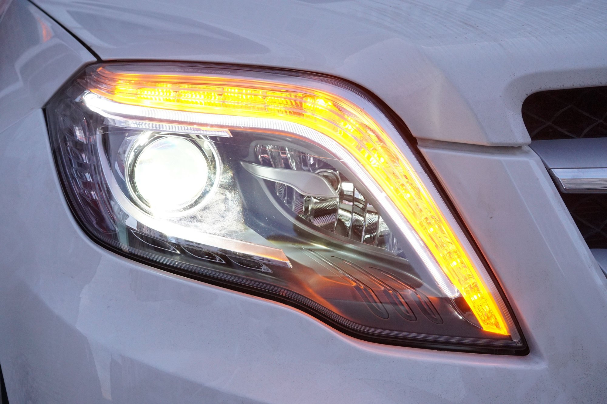

Some Backstory: My wife and I purchased the last model year of the GLK and, at the time, we were unable to find a model in stock that already had all of the packages that we wanted. We ended up settling on a car that had most of the packages, but was missing the lighting package. We were happy with the purchase at the time, but we grew tired of the halogens and honestly, we were surprised a Mercedes wouldn't come with better lighting standard. So my quest to find out what was involved in swapping out the standard halogen headlights for the lighting package projector/hid headlights began. That was unsuccessful as the harnesses were different and would require more work than its worth. I stumbled on the Win Power headlights and they looked almost identical to the lighting package headlights. Knowing how my wife is, I had to do what I could to make her happy, so I bit the bullet and gave them a try. Below are some pictures and hopefully it will help others who ran into a similar issue.
Overall thoughts: The lights are comparable to OEM quality at a glance. They are solidly built and they are plug and play like they described. You won't get the auto leveling features or any of the fancy features that come with the lighting package. These headlights basically only give you the look (LED DRLs, LED turn signals, projectors, and HIDs). Pricing isn't as expensive as the lighting package but it wasn't cheap either. I was relieved there was a good enough quality option as my wife kept regretting not getting it from the dealer. The cut off is pretty clean, but it's hard to tell from the blurry picture. Hope this post helps others that are on the fence. While I'm not sure on the longevity of the headlights, they look and feel solid almost OEM. The only downside so far are the errors I've received below. I haven't had time to look into them too much but hopefully there's an easy fix.

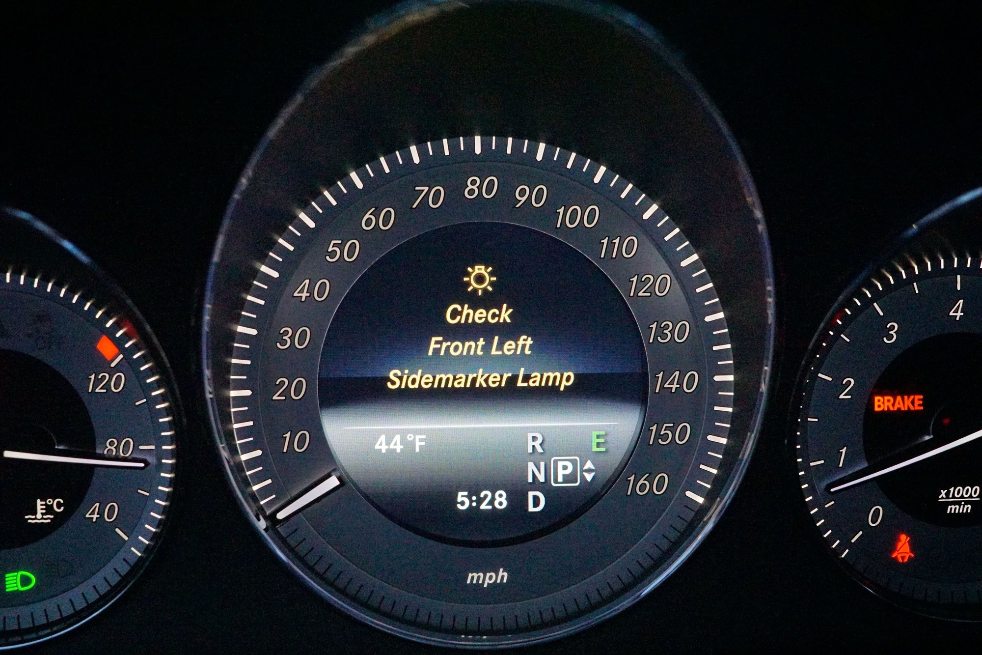

I would assume that the error is due to the change to an LED in the side marker lights. A common issue across pretty much every car forum. You can add an inline resistor to solve the problem. I'm no expert, so I wouldn't be able to tell you which to get, but some googling will probably lead you in the right direction.
I appreciate the tip and that makes sense. I'll look into inline resisters and see if it's something I can easily implement. Thanks!

I just checked a glk with the oem lighting package and it does have the side marker light. Maybe using the one from the old one could help eliminate the error code?
Attached Thumbnails Review: Win Power Headlights (Lighting Package Replicas)-photo555.jpg

I spoke to the build quality in the original post, but it is a well built product and resembles OEM quality. I can't give any feedback regarding longevity because I haven't had it long enough but in the two months I've had them, they've held up excellently.
Regarding the errors, I've had no luck. The vendor has been very helpful and will be sending a higher rated resister to see if that will help. In the mean time, I've tried to reset via an OBDii reader which didn't work because it didn't see the error at all. I tried scheduling an appointment with Mercedes to which they said they could program the car to try looking for the LED bulb rather than the halogen bulb, but I would need the LED part number which I didn't have. They wanted to charge $145 to reprogram it but I didn't want to risk it not knowing if it will even fix the error. Right now I'm awaiting the vendor to send me the new resistor to test it out. I'll update once received. Not sure if anyone else will have better luck with Mercedes but they were unhelpful during my visit.

The thing I notice in the picture is it's missing ng the yellow side marker lights. Would adding a bulb fix it instead?

Sorry I didn't answer you earlier. The LED eyebrow functions as the side marker so there's no additional place to plug in another bulb. I tried looking

If that's the case then you just need to wire a resistor like it is another bulb. Positive to resistor to ground. That should eliminate the error code.
