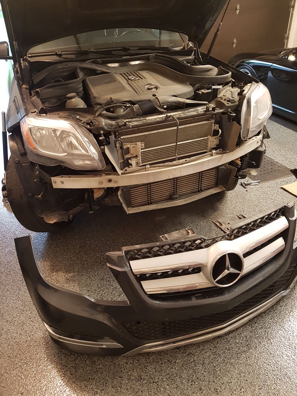

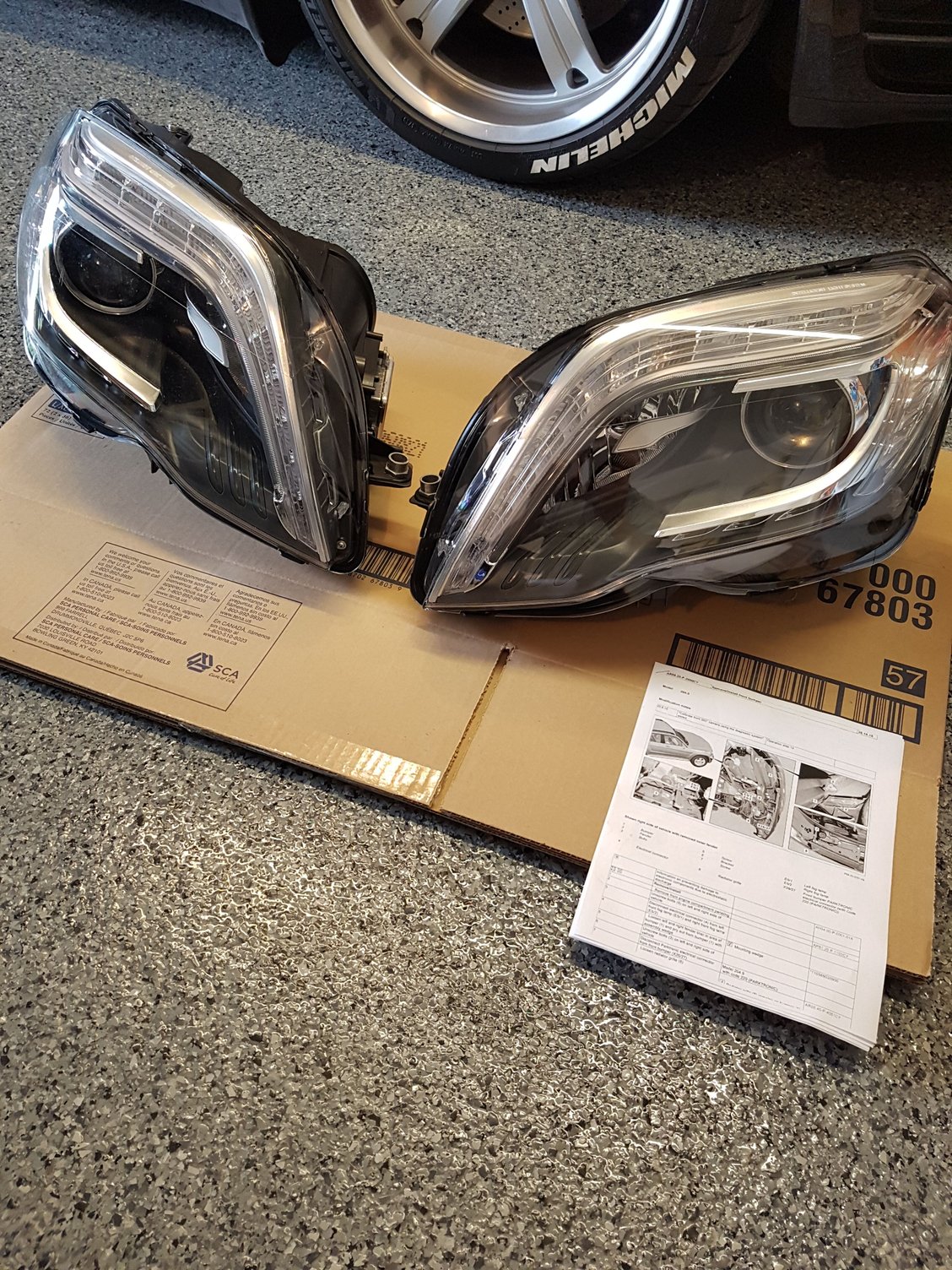

I did it and I'm really happy with results!
BEFORE
NEW HEADLIGHTS (China Copy)
BEFORE
AFTER

That looks great! Did you get the side marker error codes? If so how did you resolve that? Thanks for sharing!

VERY IMPRESSIVE! did it give you any errors, does the active curve work?

I do get error codes when the low beams go automatically on at night but they don't stay on, you simply press the "back" button on your steering wheel and they go away.
During day time you don't get any error codes. It is seriously not annoying at all.

Still working great and I added 50w resistors on each side and no more error codes
