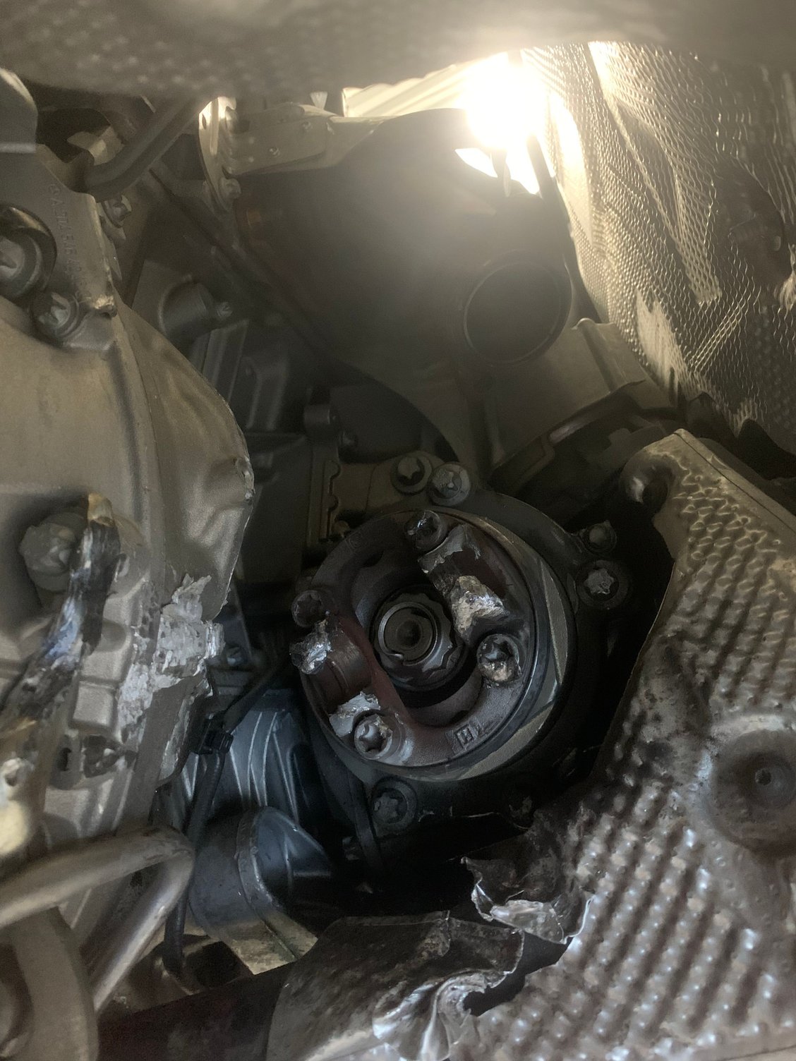

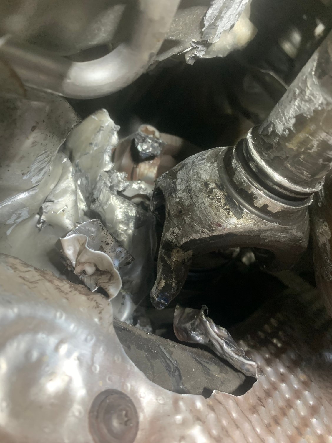

This past weekend, my fiancée and I planned to drive from Las Vegas to San Diego in our 2013 GLK350 4matic. About 90 percent of the way there, by Fallbrook California, driving down I-15, I experienced a short period of whining from the drivetrain, followed by a mechanical shudder. I immediately pulled off of the freeway. I was no longer able to get the car to drive.
Luckily, I have MBRACE and they sent a tow truck to tow the car to MB of Escondido. And, they paid for an Uber from the dealership to my destination.

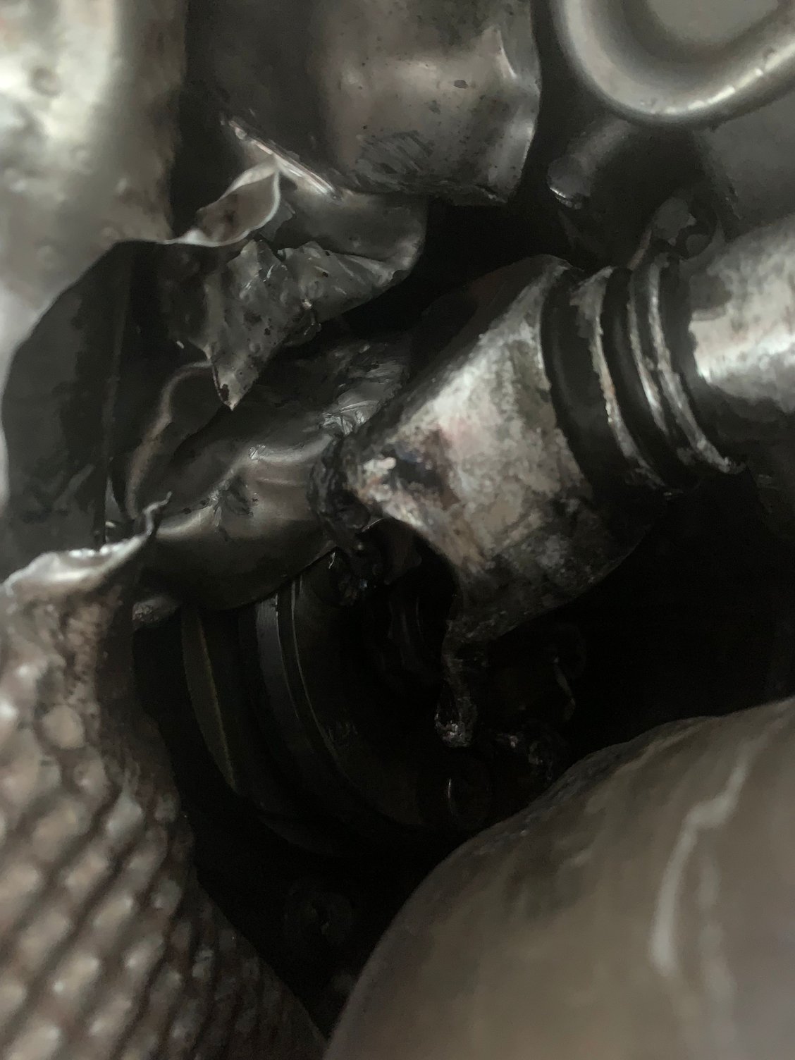

The service advisor called me today to inform me that the propeller shaft broke and also took out an O2 sensor. About $1200 in parts plus labor, for an estimated total of about $3400. Then the logistics of getting from Las Vegas to Escondido to pick my car up.
I enjoy the car, but this was a let down. I could have been worse I guess. Luckily, I wasn’t driving through the desert in the middle of the night.

The Glk isn’t that tough , its lightweight in the drivetrain strength. I messed up the front u joint at 70000m but instead of being able to replace a cheap U joint the front driveshaft needed replacing , like you, mb wanted about 3500$ for a few hours work , I got mine done for a total of 600$ With a lifetime part warranty from fcp euro. Besides not being easy to fix or cheap .MB dealers probably charge 1000$ an hour. Your u joint was probably making noise long before it let go, maybe you ignored it.

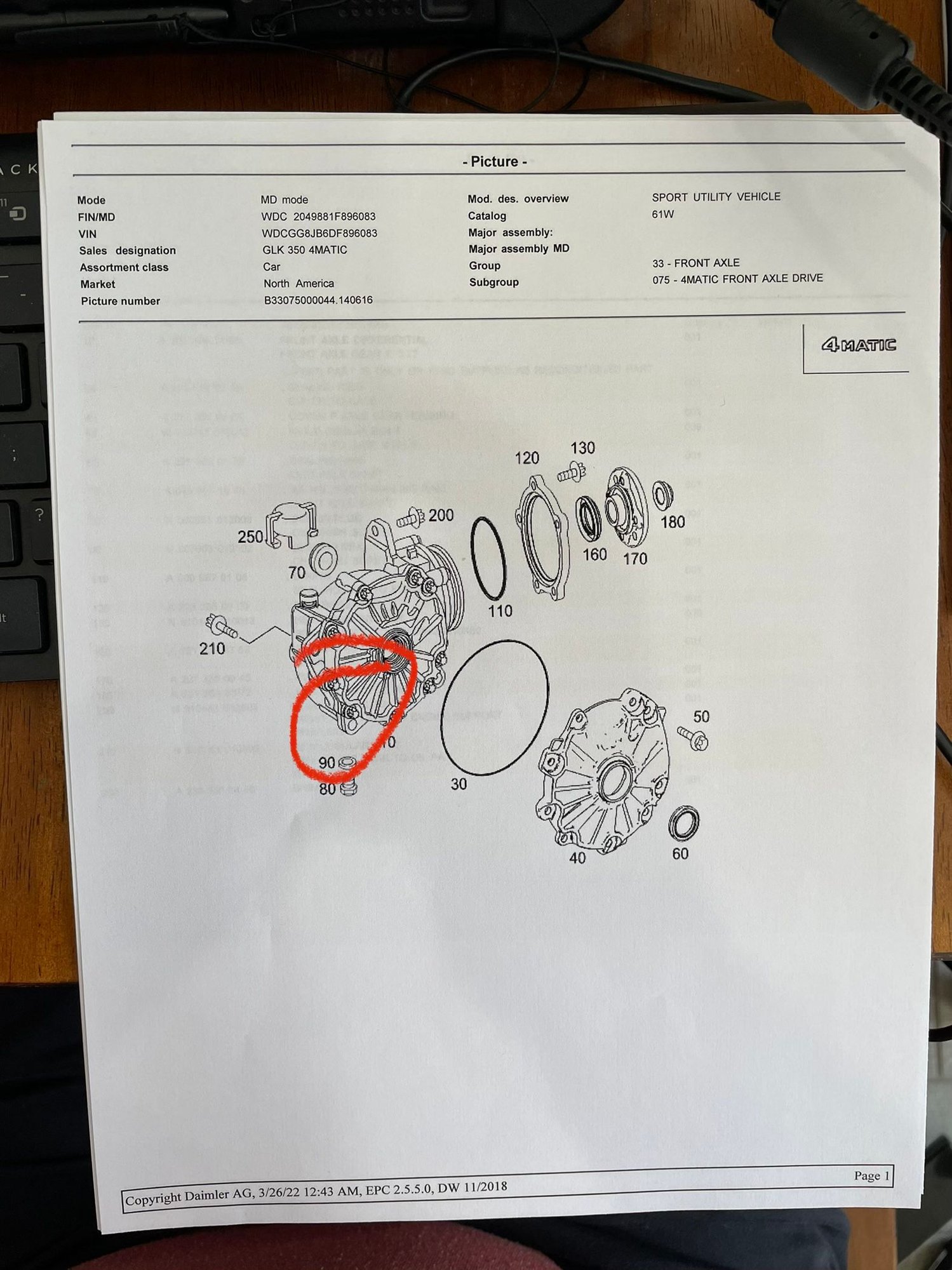

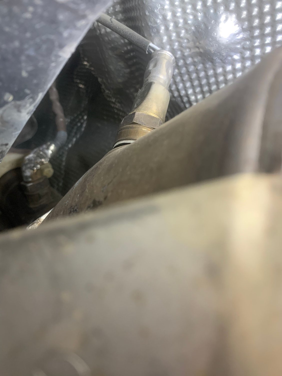

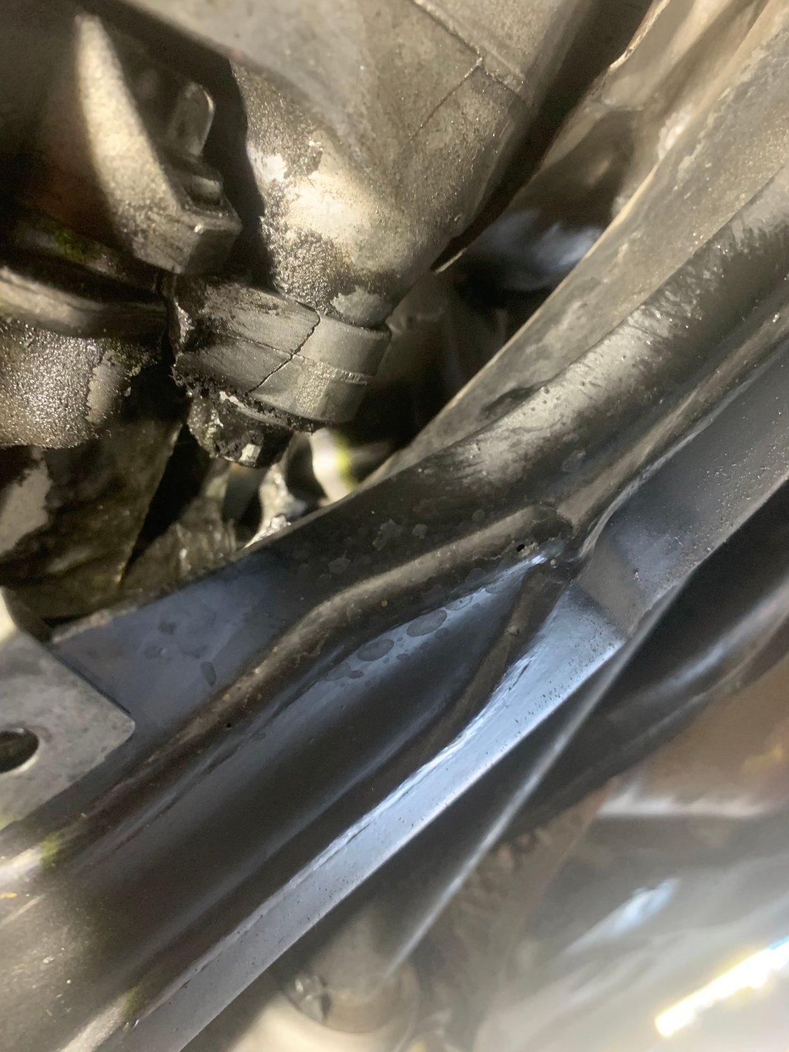

UPDATE: Upon further inspection, MB of Escondido says that I need a new front differential because of crack in the lower case by the drain bolt area. It requires dropping the front subframe, and a new alignment after completion. The new estimate added $7000 . Stay away from 4matics !!!!!

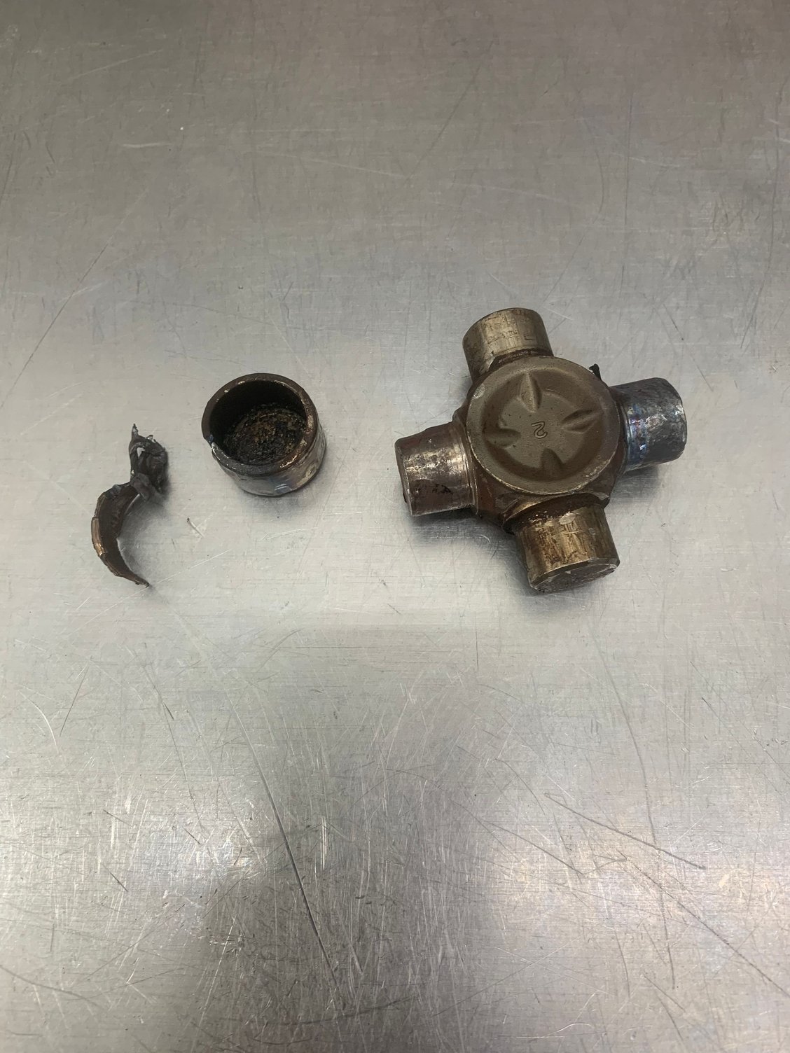

Yeah, was there any warning or vibration? That U-joint didn't go from fine to what's in the photo in a minute or two.

Yea that’s what happens when your ignorant of noises you car makes and you ignore going to a mechanic. And you deal with a MB dealer . I had mine fixed before any big isle for about 650$ total .

Your first mistake was ignoring the noise that the bad u joint made, your second mistake is having an mb dealer stick it in your ***. I heard the noise and fixed it for about 650$. You are being charged maybe 3-4x what the job is worth.

Looking at U-joint and a bearing cap picture it’s been happening for awhile. I don’t think one can hear any noticeable noise when it just starts wearing out - cabin is very well insulated in GLK.
It had to have an audible clunk when shifting from Drive to Reverse or at least chirping/grinding when driving with windows down.
The best way to detect these is to get your hands dirty and inspect car underneath once a year. Prop shaft is easily checked for excessive play while parked AND you’ll hear that clunk right away.
