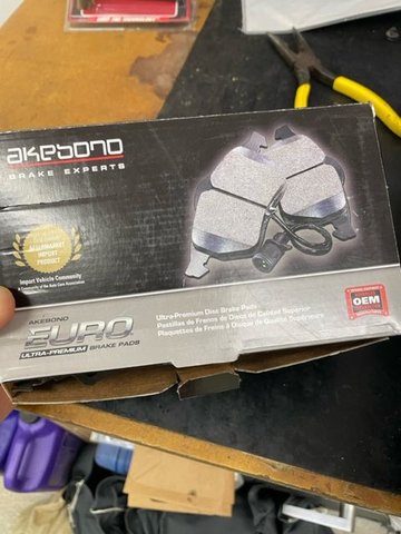

Hey all,
I recently bought a 2015 GLK 350 with low miles, (23,000).

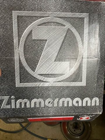

Obviously one of the first things I noticed was the notorious brake dust that these give off, so with a little research I came across people doing Akebono ceramic pads for both front and rear. I did read a few conflicting reviews but I thought what the hell, I'll try them.
Along with the ceramic pads I also went with Zimmermann rotors, this combo is absolutely awesome! very little brake dust and stops just as well as the originals. I was able to compare between the factory and aftermarket as my mother in law has the same 2015 GLK 350 so I drove one right after the other. highly recommend!!!

I have Zimmerman Rotors also.
Your test was with one vehicle with new rotors and new pads, against one with old rotors and old pads? How can that be a fair test?
The other GLK had new OEM rotors and pads installed as well, roughly 600 miles since replaced

Zimmerman rotors work well. New Brake fluid makes a big difference in stopping power. With Age and miles it degrades from moisture.
