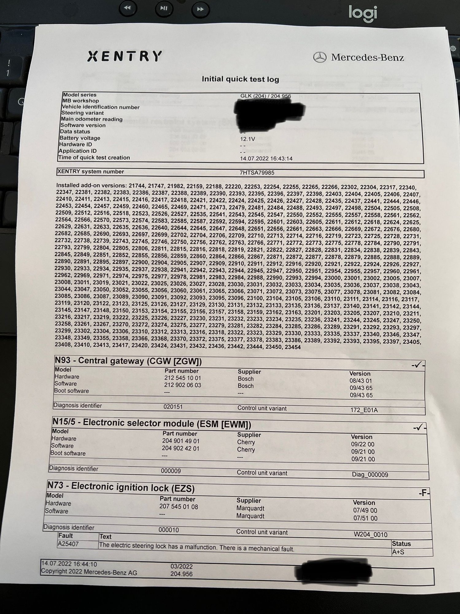

Old Jul 14, 2022 | 11:19 PM
Jett's Avatar
Joined: Feb 2017
Posts: 39
From: Austin, Texas
I drive an '11 C300 and wife drives an '11 GLK350
here is the fault number in the Electronic Ignition lock section of the test so you can see. I'm guessing its that part and software that was replaced and updated. I'll find out tomorrow how much and actual part.
