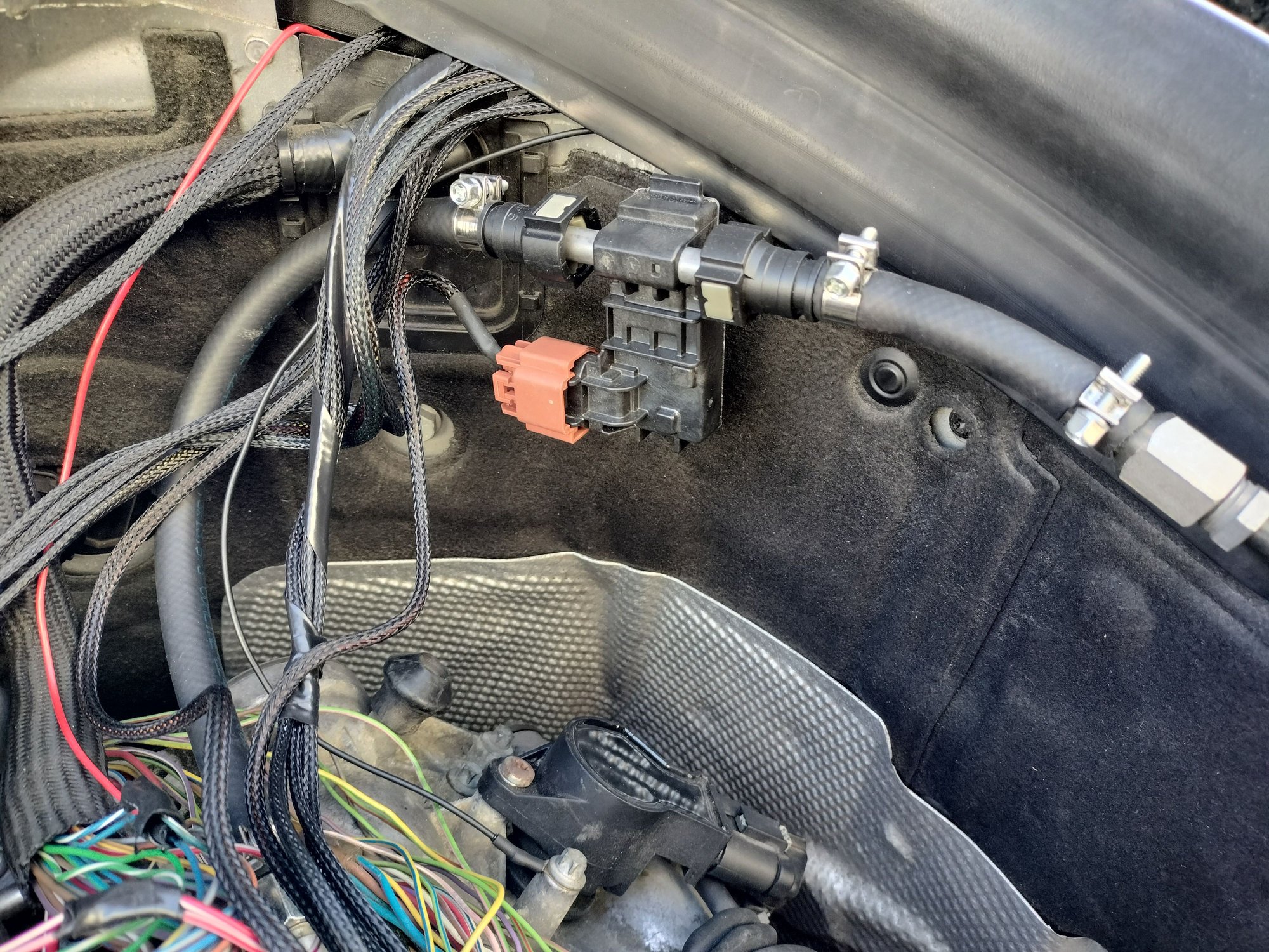

I've been itching to do more tinkering on the GLK lately and that has led to me investigating E85.
Mercedes made the 2008 C300 flex fuel capable, and the only difference I've been able to find in the fuel systems from those to my car is the addition of a fuel quality sensor (standard flex fuel sensor). I can't find any wiring diagrams that actually include this sensor though, and I poked around in the variant coding for the fuel pump control module, engine ecu, and front/rear sams and I don't have anything that mentions the fuel quality sensor.
Since I don't think there's an easy way for me to retrofit this fuel quality sensor and I did find a few forum posts indicating that the ME9.7 ECU had flex fuel tables in it from stock I decided to just try draining my tank and adding a couple gallons of E85 to see what would happen. So I did that and while the engine ran great at light throttle or full throttle (butt dyno felt faster) it would cut out and bog at quarter/half throttle.
So since that didn't work I drained the E85 out and went back to 93 and hit up google for E85 tunes or kits for Mercedes and I found this: Auto Products - eFlexFuel Technology
I ordered it on 3/25 and it was at my door from Finland on 3/28. Can't complain about that.
The install was very simple, they include the harness and connectors to make the new fuel line that includes the flex fuel sensor. Just use your multimeter to find positive on your injector connectors and pin the harness properly for that. Plug in the injector harness, make the new fuel line and install the flex fuel sensor, add ground and plug it in.

I average around 18 MPG on 93, on E85 I should expect around 13-14 MPG. The E85 I bought yesterday was $2.74/gallon while 93 octane was $4.05. If the MPG math holds up it'll basically be a wash cost wise, but I drive so little I'm not really concerned about the MPG hit.
E85 burns cleaner and cooler, while being around 100-105 octane. Converting to E85 opens up the door to a low boost non-intercooled (I have 0 room for an intercooler/heat exchanger) supercharger setup in the future.

I reset my trip meter after filling up the tank with E85. The app is reporting I'm at 50% ethanol now.
Half tank of E85/half of 93 and these are the results after a short trip in town (lots of idling/stop lights):

Took a trip to DC for the Defenders game and averaged 14.9 MPG. 162 miles with a lot of stop and go traffic in DC. Before we hit the traffic the car was reporting I was getting 19 MPG.
