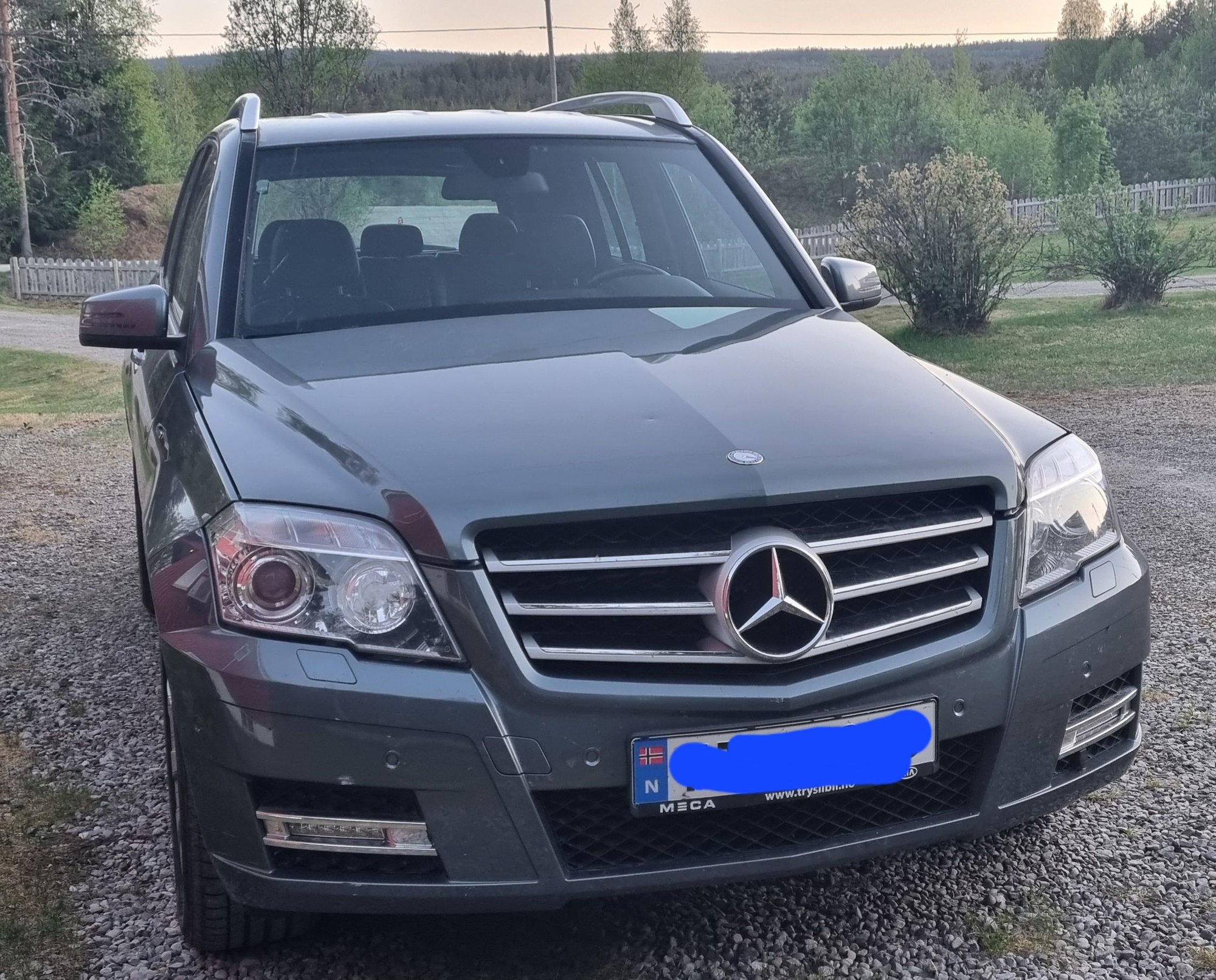

When idle its silent, starts at 1500+, and at 3000+ its quite bad now. Got a couple of clips attached for the noise. And a pic of my old gal, some beauty defects but no rust, and still smoooth driving!
