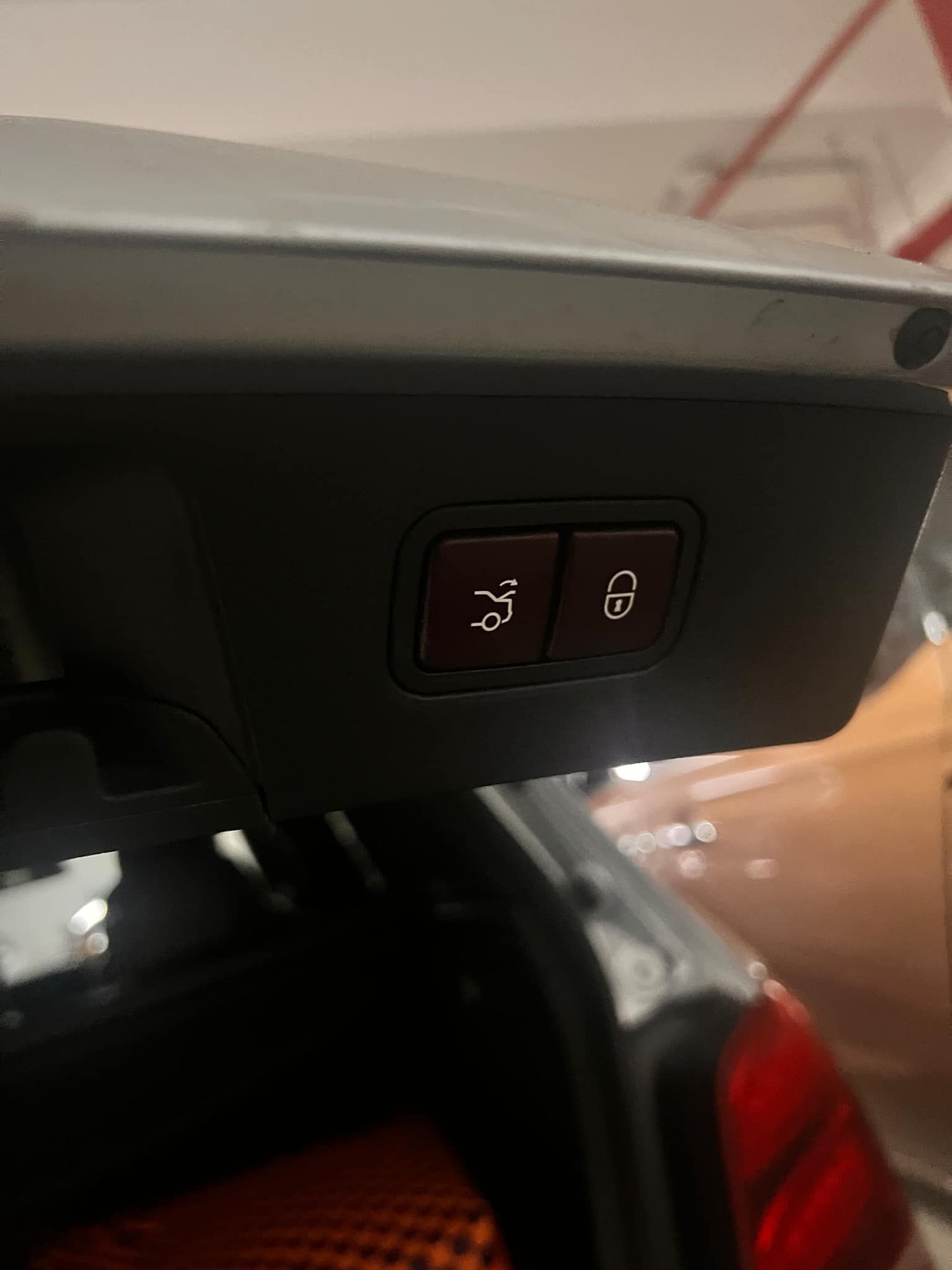

i did a test to make sure the issue come from the key for the hatch button as below:
1. open the trunk by whatever button, then stop it that i could touch the hatch button without the chair.
2. immediately when it stop i click the hatch button and it worked.
3. when it stopped if i leaved it there for such as ?30s, then the hatch button didnt work
i did the same test with other glk car and it work all time no matter how long after all interior lights shut off. i think the issue is not from the key.
the timming for interior light shut off of my car is less then the friend of mine - the one that i test the hatch button, and this car also change all to led. the difference of 2 car now is the main battery as my friend have just replace while my SOH of battery is 36%. i think i will replace the battery before hand.
Does the other GLK have the same retrofitted LED for the trunk light? If they are not the same then maybe the cut-off voltage (current) for the two different LEDs is also different. That would give the impression of the timers being different lengths of time as the LEDs would go dark after a different number of seconds. This is assuming the trunk light is also slowly being dimmed like the interior lights and not just an instant removal of power. That's how it appears in your video as the LEDs start flickering at the cut-off point.
Was any software coding done after the retrofit? If so, maybe something was missed or set incorrectly. If no software coding was done maybe some is needed??
In any event, as you point out, any sort of useful electrical or electronic troubleshooting must start with a strong and stable power source. If by SOH you mean State of Health for your battery then 36% certainly does not sound good, as a basic starting point.
the other glk replace all interior with led. the flicking in the video because recording with phone is difference Hz of led, visible out of video does not flicking.
for sure it have to be code to make keyless go work after wiring work.
I replaced brand new agm batt and nothing change except the interior light lasting longer.
https://youtube.com/shorts/hOkUNmxvAoo?feature=share
Sorry to hear that. On the positive side you have a new main battery, which it seems you really needed.
I did notice in the video you are still pulling the hatch handle multiple times, quickly, instead of just once.
Why are you trying to open the hatch from an already partially open position? Or did the hatch stop in that position because the trunk light happened to turn off at the point?
I opened then i stopped it in the low position that i can touch the button on the hatch. then I waited until interior lights off. I pushed the button on the hatch and it didnt work.
the reason to push multiple time as just show in the video that i pushed it, if i push 1 then very hard to show via video. With the interior lights on, only 1 push it worked. i did similar on my friend car (GLK same year difference engine) and that button worked when lights off.
the reason i have to do that as i have issued when open trunk with keyless fob in my pocket and i could not open with button hatch. i do this (open/stop trunk door in the middle then wait) just to understand the problem come from the button or the proximity off the key. by this test i'm sure that the issue come from the button is flat out of power after light have been off (same as when we locked the trunk) after specific of time.

Today i doa test again: the trunk have to button. When i pressed the lock button then wait for intertior light off then the hatch dont work.
if i pressed the left button the hatch still have power when light off

It sounds like the issue is that the handle won't unlock the hatch whereas the button will. I assume you are saying that if the hatch is locked and you press the "open hatch" button it unlocks the car and opens the hatch. The handle will open the hatch only if it is already unlocked.
If you press the red lock button to close the hatch, can you open it immediately after it closes (before the light goes out?) Once you press the red lock button, if you get rid of the key, can you still open the hatch immediately? (I think you said "no", but I want to be sure.)
I ask, because it sounds like the hatch cannot detect the presence of the key, but there is that brief period of time, while the light is still on, where either you don't need the key, or the hatch can detect it.
Pressing the button on the key does not require the key to be in close proximity.
