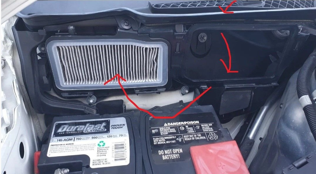

I removed the battery cover and see this fan running - not sure what that fan is for.

Climate control fan (?).
The inside fan is set on Level 2 (2 lights lit on button). I had the inside air on (it's always on) to the grocery and Walmart. But on the way home, I fired up the A/C and bumped the fan speed to 3 ... but turned A/C Off (as usual) and dropped fan speed to 2 as I pulled into driveway.
I find it odd that fan is directly associated with battery top cover. (it has a dedicated tunnel). I just checked (7pm) and it's not running

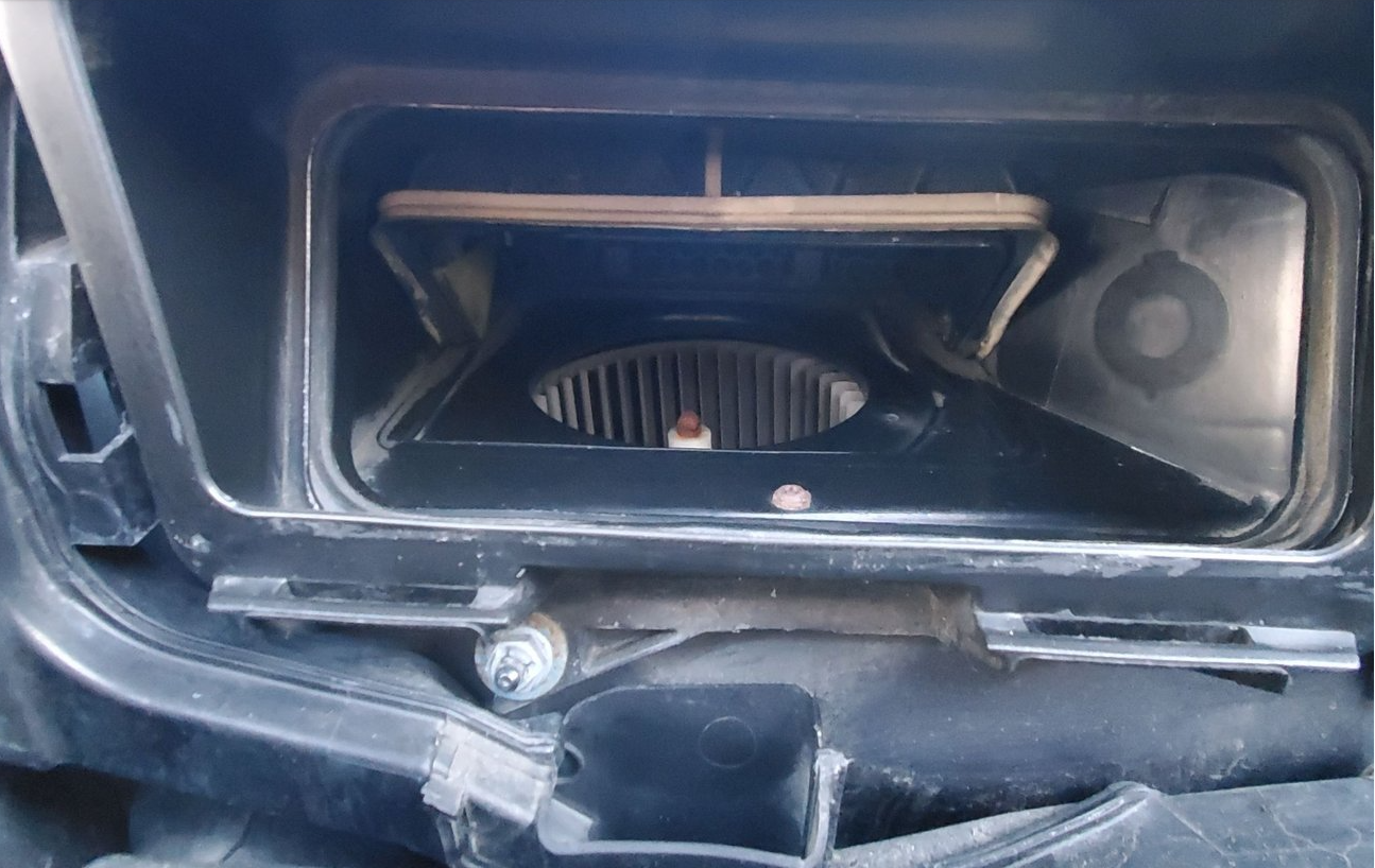

That blower/motor is where the fresh air enters the car. The plastic box installed above the battery directs air from in front of the windshield into it then into the car. so dirty air from the engine bay does not enter.
Can find it in the manual under Heating and Air Conditioning > Description and Operation > Regulation of Automatic Air Conditioning, Function > Part 1 HERE- https://charm.li/Mercedes%20Benz/201...d%20Diagnosis/
Its the Manual for the 2010 GLK350. if you click on the "Mercedes Benz" in green on the top of the page it takes you to different years.

Guess what I discovered (?) ... there is a "door" that closes that fan area. I witnessed it today after the first 5 minutes after shutdown. Then it immediately opened back up after 10 seconds. I will show it to tomorrow. it's easily closed with a finger.

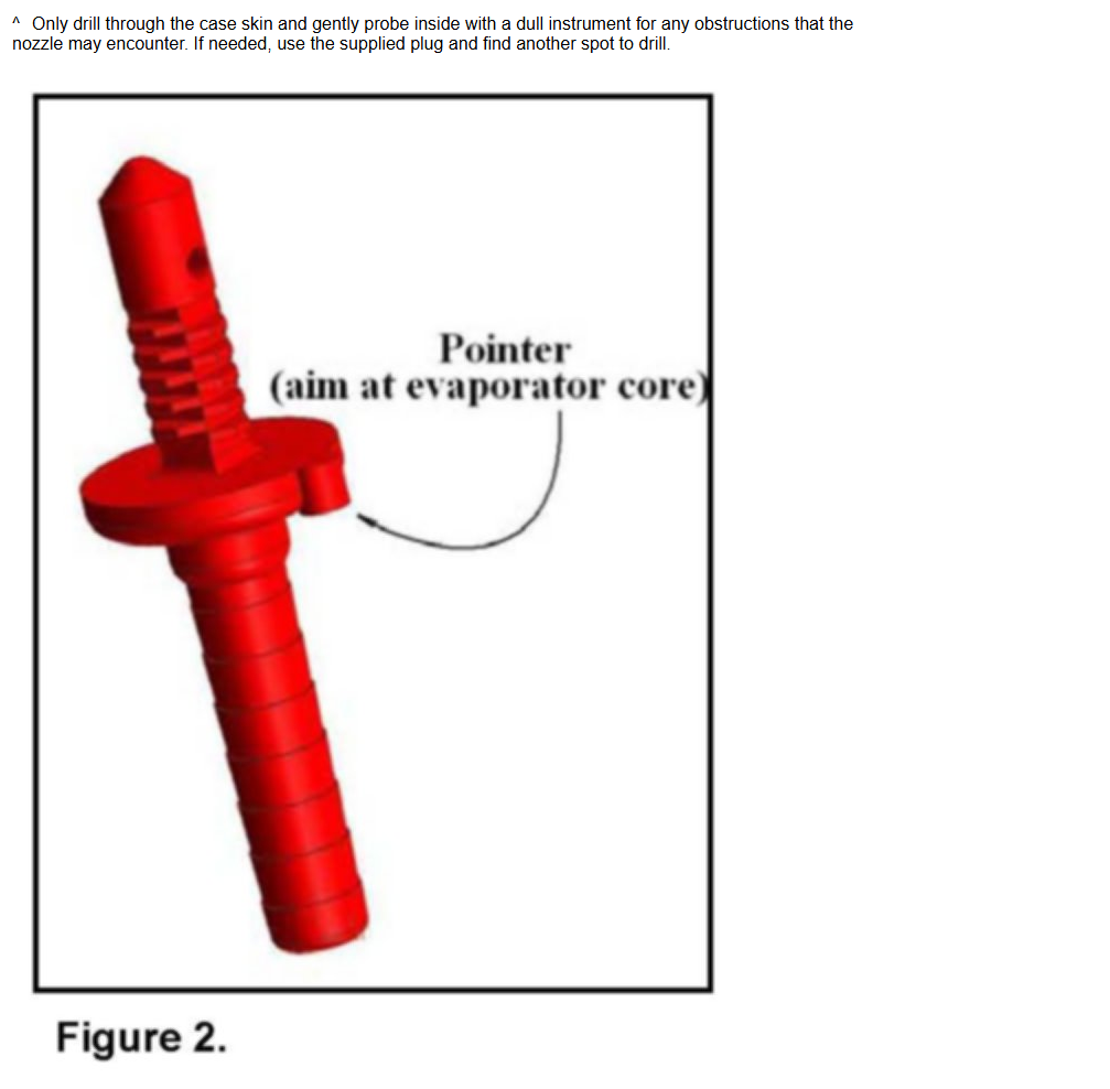

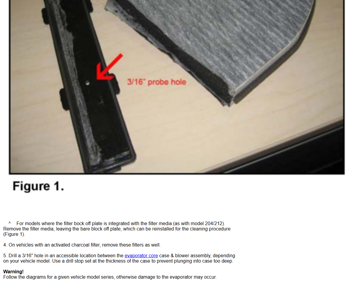

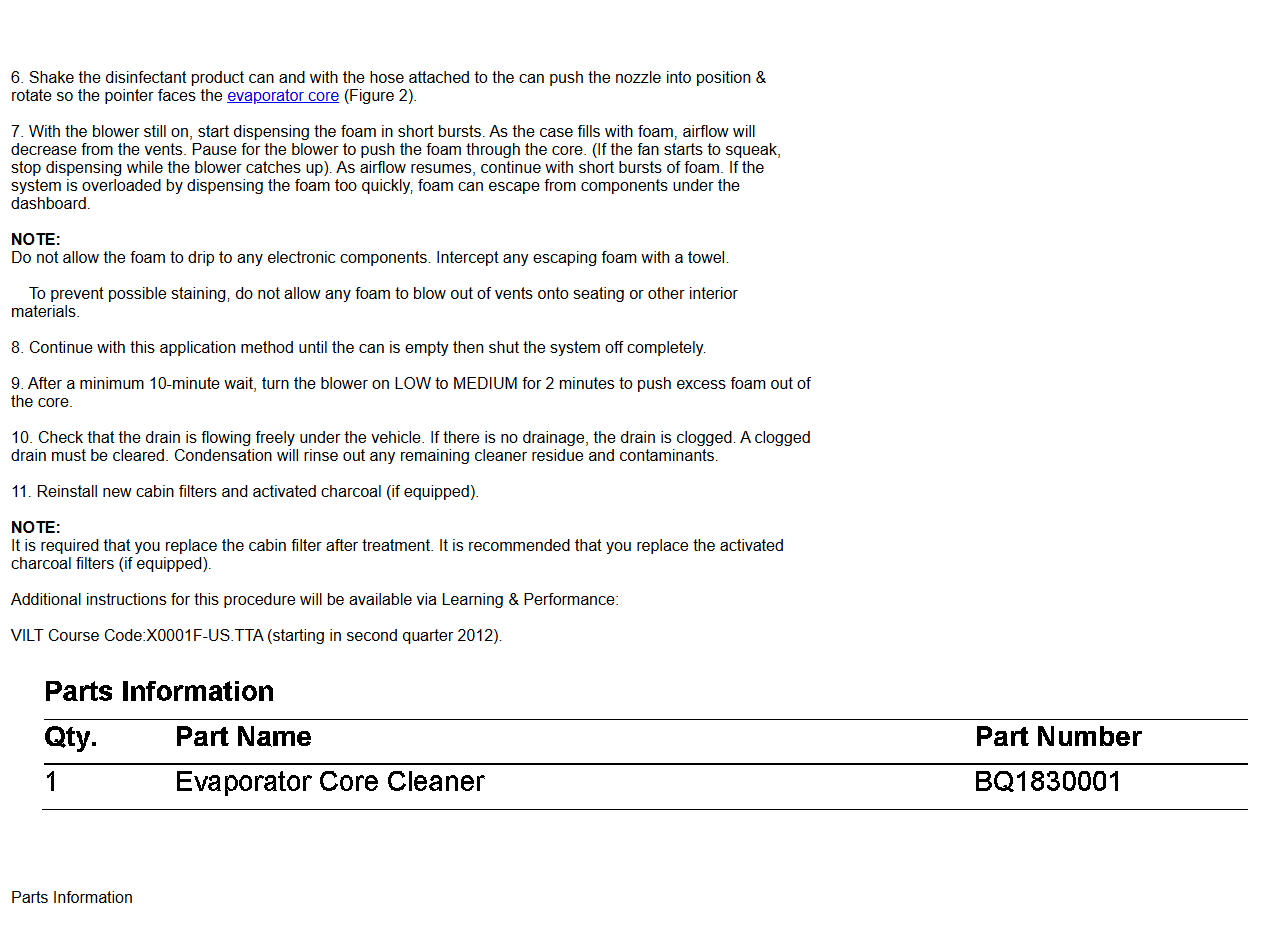

Talking about mold I was looking thru the manual and came across the procedure to clean the evaporator.
Yes, there is, it is meant to close when you are in recirculation mode.

We have never had recirculation mode enabled. So why did that door close, then open seconds later.
That sequence happened after the car shutdown ... then a couple minutes later, I got out of the car, opened the hood , then removed the cover (an obvious 2-3 minutes) ... and about 20 seconds later, I saw that door close... then seconds later, it opened back up. What's the point of closing, then opening seconds later AFTER the car is shut down after a few minutes (?)

I do know that fresh air/recirculation door will close then open on mine after I unlock the car and open the door. I hadnt even put the key in the ignition when it happened. I figure its the car going thru its function checks. I believe it also happened after replacing the battery, a minute or two after connecting the new battery it did a function check. I also hear noises from the front sam and I think noises from the throttle body.
Maybe it has something to do with the front door opening/closing? The more I read the more im amazed at how these things all work.
Theres a motor that moves that door open and closed. fresh air comes in from the front of the windshield down past the plastic trim, goes through the box above the battery then to the blower. To recirculate the air that door closes to the outside and air is then sucked in from the dash board.
Heres how the air flows, shown with the box above the battery removed.
Fresh air comes in at blue arrow above, recirculated air in red arrow.
I had no idea the cabin air filter was in a different location on the pre-face lift model. I'll take it! The filter location/replacement on the later GLK is the most awkward, annoying, frustrating, dumb setup I've ever encountered on a car.
Old Mar 3, 2025 | 05:11 AM
Mmr1's Avatar
Joined: Sep 2015
Posts: 2,585
Likes: 343
2013 glk 350
You’re supposed to filter all incoming air , right? I wonder if the filter in the photo - pre 13 would fit on a facelift Glk . Now I’m sucking in everything. I have not done the interior filter myself but my friend who does mine did say the interior filter was a B
