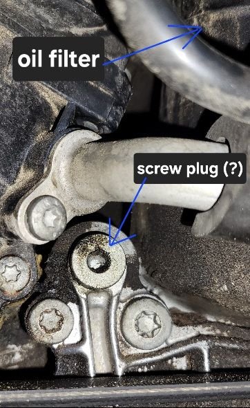

Old Mar 24, 2025 | 06:51 PM
calder-cay's Avatar
Joined: Jun 2021
Posts: 1,013
Likes: 281
From: South Texas
2014 GLK350 base model (active) ; 2001 E320 base (retired); 2001 Wrangler soft-top
Okay, found a few minutes to spare, and removed the front upper plastic engine cover (or is it upper front).
See photo - took me 3-4 shots to get a good one. I also sprayed the area with electronic cleaner (for instant dry time).
I point to what I think is the screw plug, but I'm not confident, because the PDF is a bit grainy. I bumped the PDF to 200%, but still a bit blurry. Anyway, I think that screw is it, because the other two are different, and probably used to mount that plate
(M276 engine)
Old Mar 24, 2025 | 08:27 PM
W205C43PFL's Avatar
Posts: 32,514
Likes: 6,348
(M276 engine)
That might be it, you could ask forum member JettaRed for confirmation.
Old Mar 24, 2025 | 09:59 PM
John CC's Avatar
Joined: Jun 2021
Posts: 1,928
Likes: 523
From: New Hampsha
'17 GLS450, '14 GLK250, Grandpa's Roadster
I found the right manual page and the resolution was no better, but, I think you've got the right one. The piece it screws into covers the oil passage from the oil filter to the block.
Old Mar 25, 2025 | 08:26 AM
W205C43PFL's Avatar
Posts: 32,514
Likes: 6,348
Thanks for confirming.
