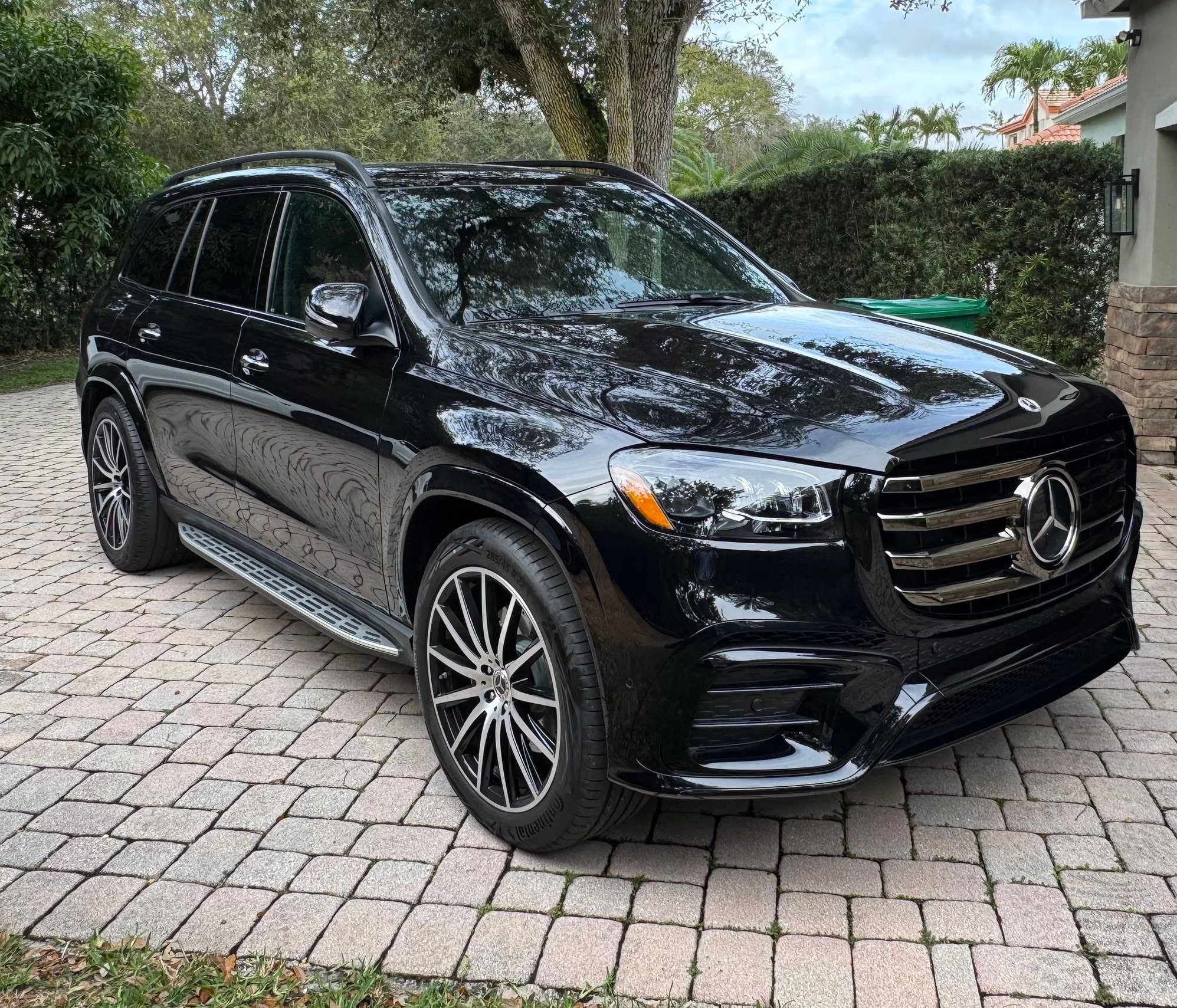

Sold my Tesla X and just drove 300 miles home in the GLS ....
If the Tesla is a 10 .... The MB system is a 6.5 ....
Gets lost on any curves, not bad on straights , ping pong all the way,,,, distance control and braking is pretty good ...
I like that driver can make inputs to the wheel - but MB should be as good as Blue Cruise or Tesla on the highway ...
Just my $.02 ....
