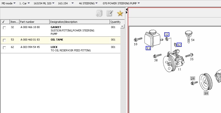

Your problem is not with the pump but with the reservoir. Inside the res. is a mesh screen which eliminates noise. When it fails, the res. must be replaced.
Step one is to order a reservoir, 2 O-rings (in case you damage the first one on installation) and locking C-clip. If you do not order OE parts from the dealer you will have leaks at the res. and the screen will fail again.
Step two, after receiving the parts, is to choose a location where you can install the new res. and be able to raise both front wheels off the ground. You cannot start the eng. after installing the new res.
Suction out all of the fluid in the res. Then remove the C-clip and follow instructions for removal & installation.
After the installation and partial filling do not start the engine. Raise front wheels off the ground, turn the key to pos. #2 (DO NOT START THE ENGINE) and follow bleeding procedure in pdf with aid of someone looking into the open reservoir until all bubble are eliminated.
Attached Thumbnails Noisy Power Steering Pump-2016-01-25_050747.jpg   Noisy Power Steering Pump-ps-reservoir-cut-away.jpg

Thank you very much. I will get an OEM reservoir from the dealer today, already have the o-ring as I thought maybe it could be this. I am done with buying aftermarket parts, I've had nothing but bad experiences with them. I have all equipment needed to do the job and am quite surprised the MB dealer didn't know about this. I was thinking of changing the reservoir but I couldn't imaging what could be wrong with it but did not know there was a screen inside. I will let you know the results.
