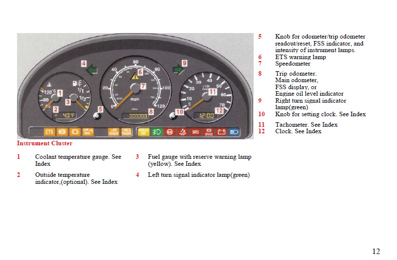

So does that mean that changing the shifter did noting at all. You are having the same problem as the previous owner.
When your turn the key to pos. #2 (not starting the eng.) do all the telltale lights illuminate, especially the CHECK ENG. LIGHT?

At the last position before engaging the starter all of telltales, including the check engine, come on.
