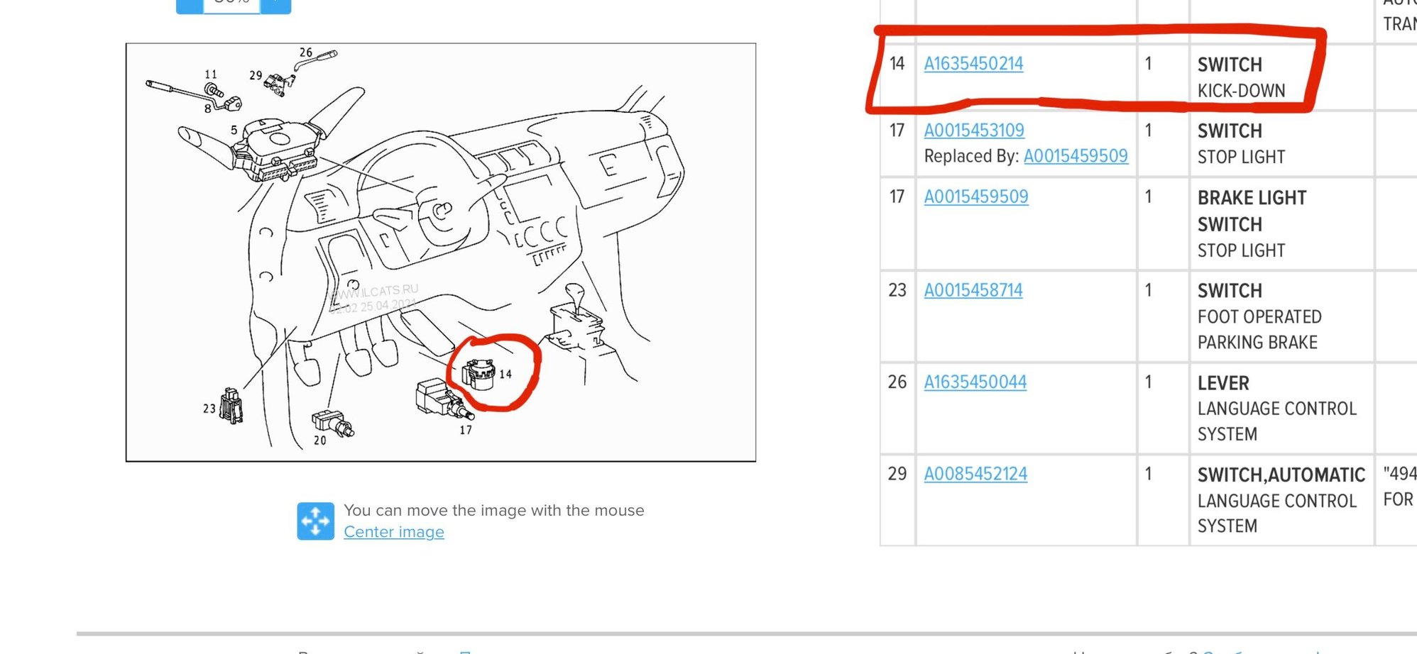

Old Apr 24, 2021 | 07:05 PM
zer0pwn's Avatar
Joined: Jul 2020
Posts: 42
From: Pullman, WA
2003 ML350
This is the diagram I am referring to about the kickdown switch.

Hi Maj. Dundee, there is a bump/kickdown switch under the accelerator pedal which is why I was really confused (two parts were going to the same spot from what I could see from the diagrams). I can press it and feel it when I push the pedal to the floor. I can get a picture tomorrow if necessary. It is weird as I do see the documentation you provided that shows it shouldn't be installed after July 2002.

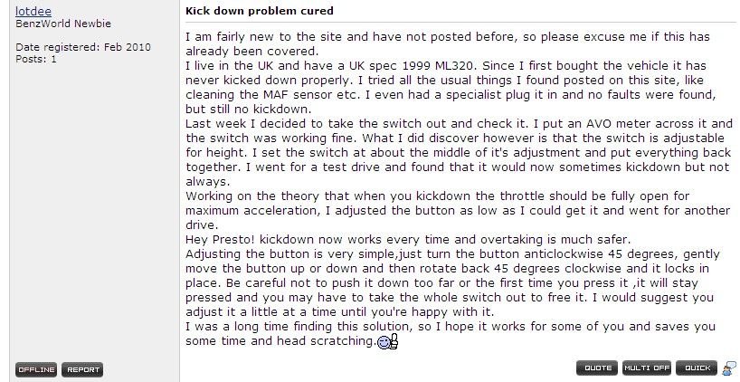

Try this.
Old Dec 1, 2021 | 05:56 PM
zer0pwn's Avatar
Joined: Jul 2020
Posts: 42
From: Pullman, WA
2003 ML350
This was the fix. To help others, the solution was that I adjusted the new kickdown switch a notch higher than the lowest position by turning the button 45 degrees counter clockwise and pulling up by the black post, NOT the gray button. There are some gradations on the black post where you can see some kind of notches. I don't have a picture but you should be able to figure it out by experimenting with it a little bit. You then set it by rotating it clockwise by 45 degrees. You will know you are not in a notch if it won't set. I had to adjust mine higher than the lowest position to get it to work. I have not had any issues since this fix.
