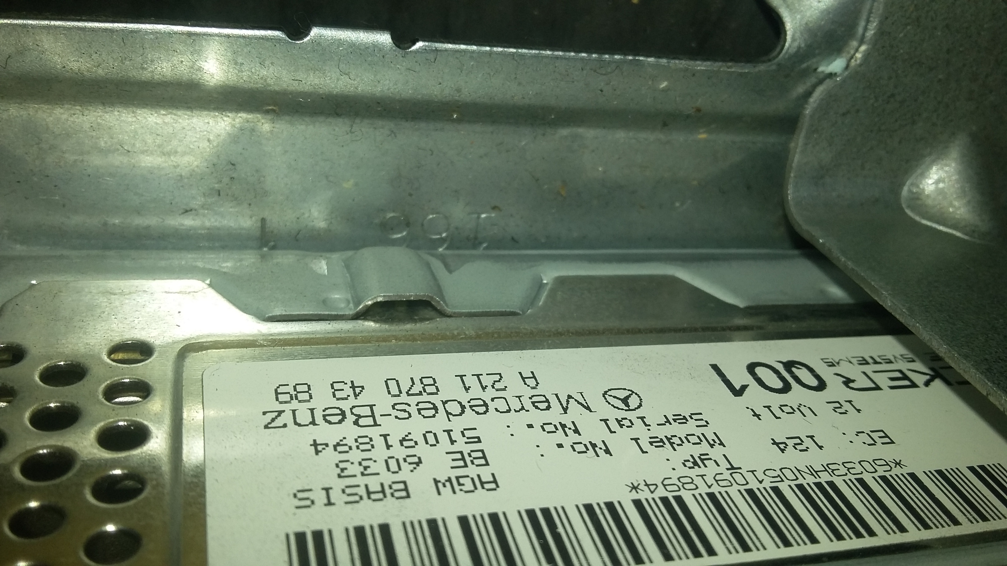

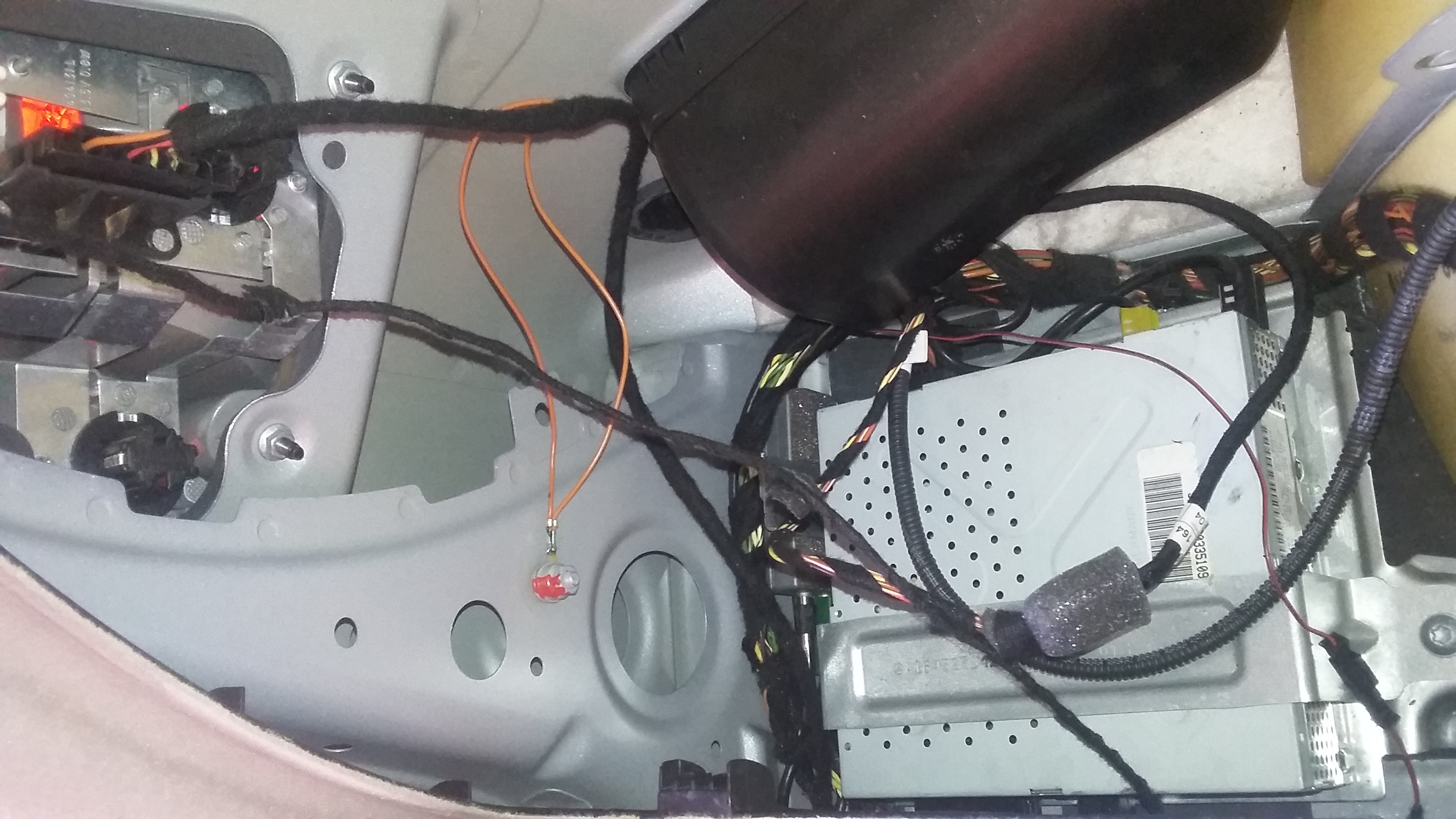

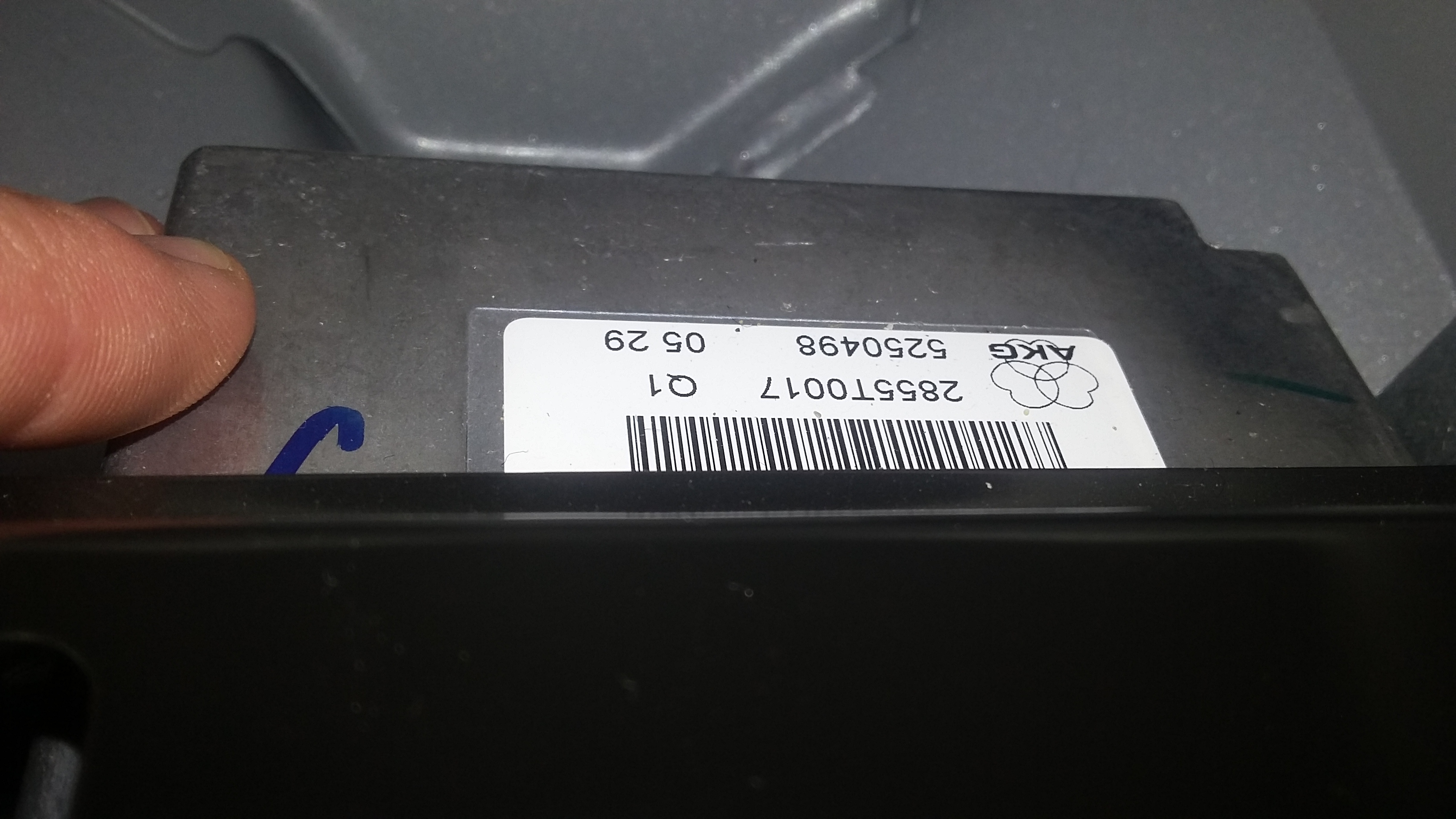

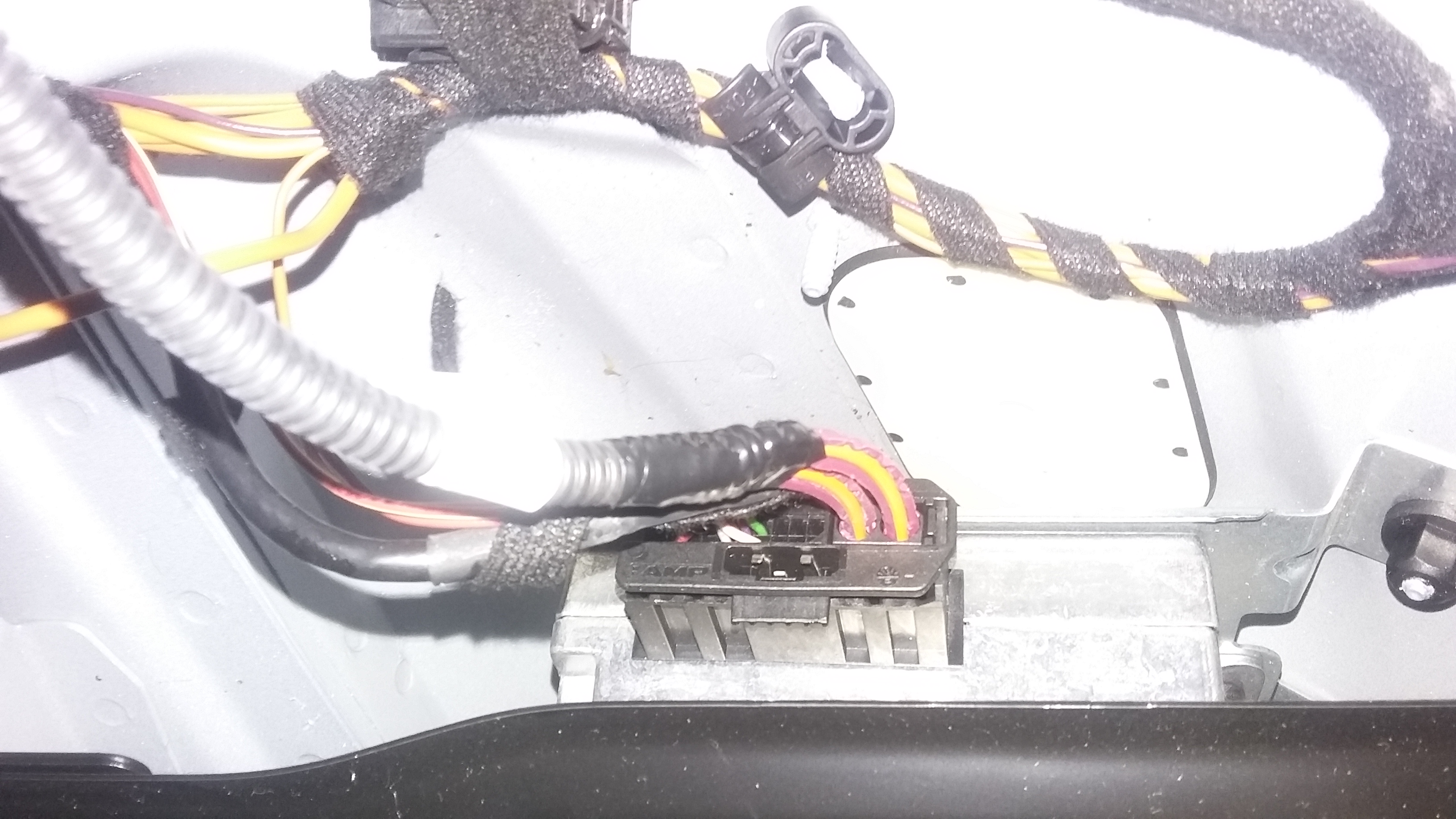

  • Rebooted some unit under back seat (image attached) (https://mbworld.org/forums/m-class-w...available.html)
  • Rebooted a unit that looks like the amplifier in the back (image attached)

Attached Thumbnails ML350 Audio problems after battery change-20151216_140016-1-.jpg   ML350 Audio problems after battery change-20151216_135957-1-.jpg   ML350 Audio problems after battery change-20151216_135659-1-.jpg   ML350 Audio problems after battery change-20151216_135554-1-.jpg   ML350 Audio problems after battery change-20151216_124347-1-.jpg
