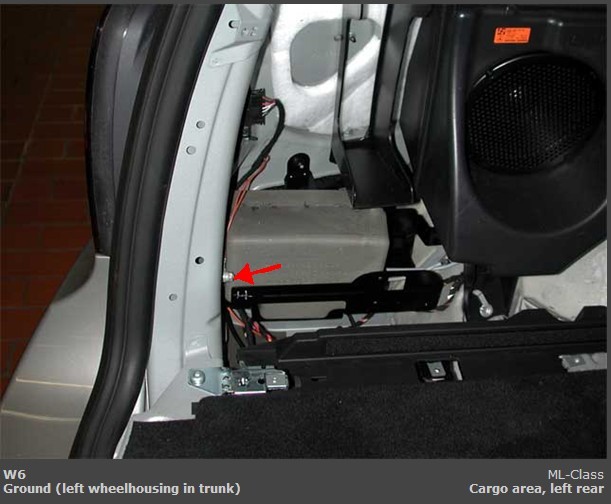

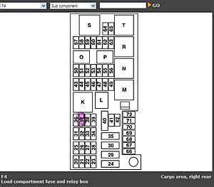

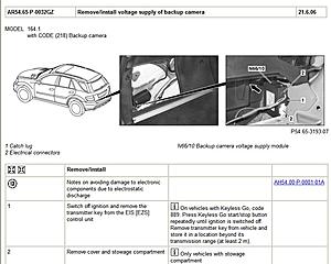

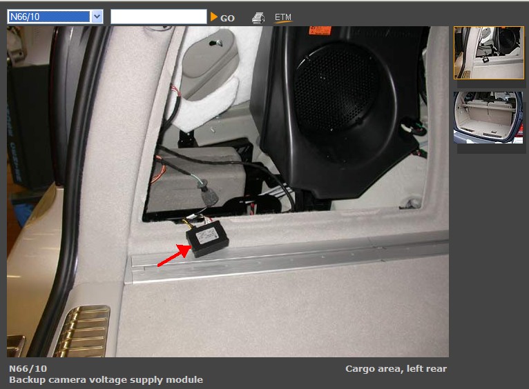

Here is everything I have on the Backup Camera. M/B does not supply any tests as the use the SDS to find and correct problems.
The first thing to do is check fuse #37 in the cargo area fuse box and ground. Other than that, you will have wing it.
Attached Thumbnails reverse camera issue-back-up-camera-fuse-37.jpg   reverse camera issue-backup-camera-ground-w6.jpg   reverse camera issue-back-up-camera-loc.jpg   reverse camera issue-back-up-camera-module-n66-10-loc.jpg   reverse camera issue-back-up-camera-module-n66-10.jpg
