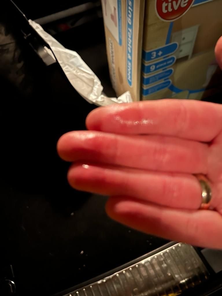

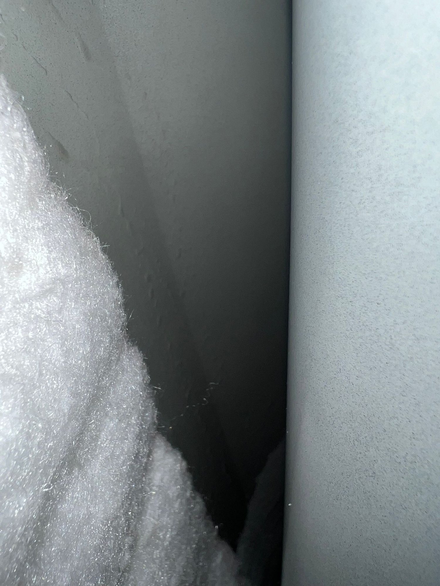

Hello!
​Have a problem with water leak.. already searched in google solutions, but so far nothing.
I have water in my trunk on right and left side (middle is dry), but not at the bottom of trunk, but only straight under quarter glass. Most of the time even isolation is also dry, but everything betweek quarter glass and isolation (that yellow foam and white thing) is in water.
Already changed taillight seals.
Any ideas?
Please help!

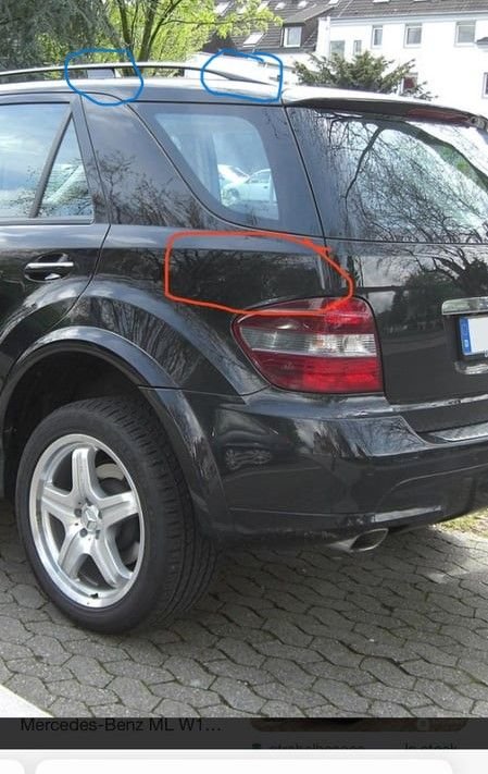

Not sure on MLs, but GLs leak where the roof rack attaches to the roof. The seal is not very robust.

Originally Posted by johndizzy
Could you send me photo please of exact place which you think about?
The two places circled in blue. I assume the seal on MLs is the same as GLs, which is to say a thin rubber sheet that tends to leak over time.
