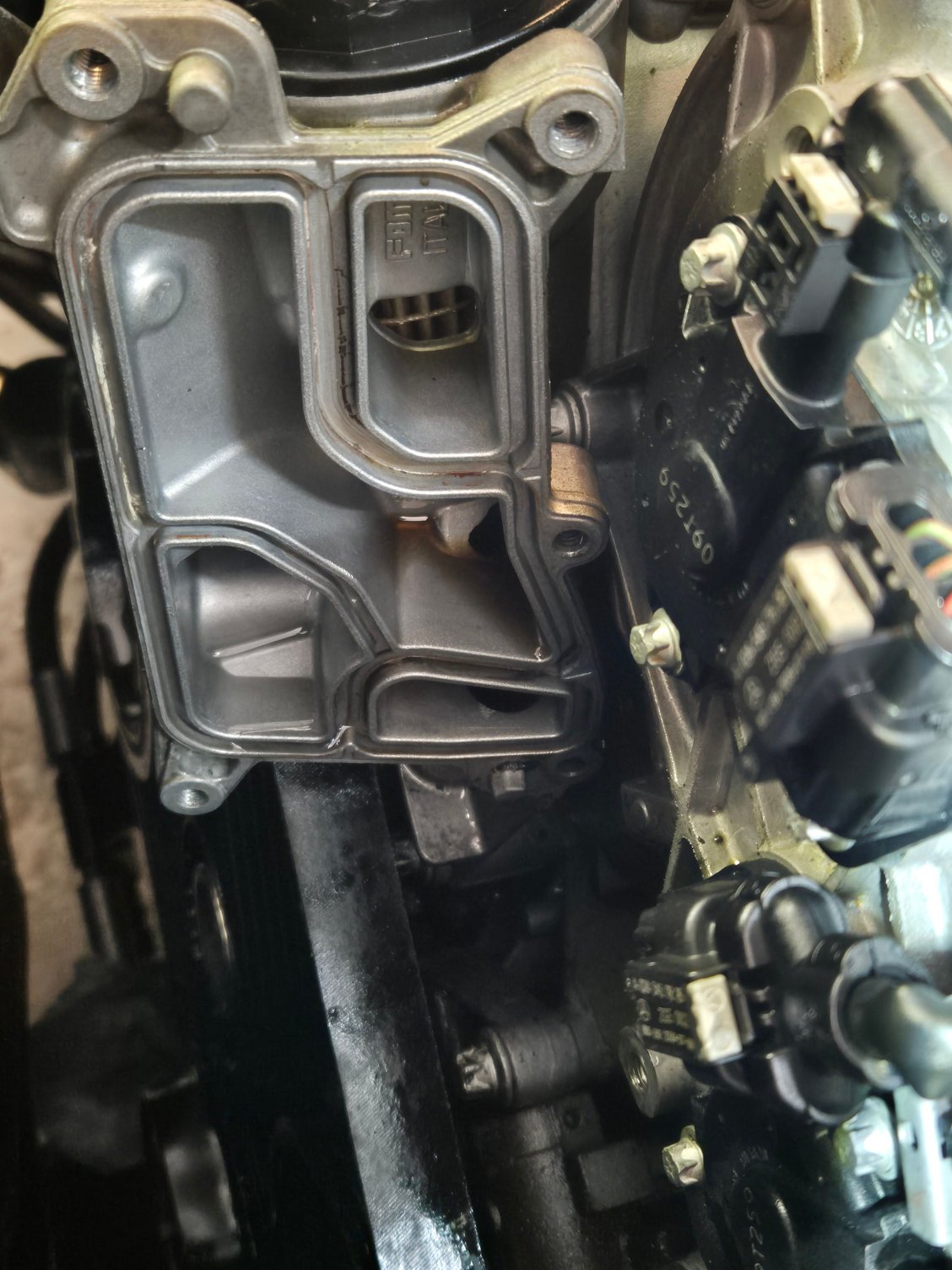

Cleaned internals of Oil Cooler

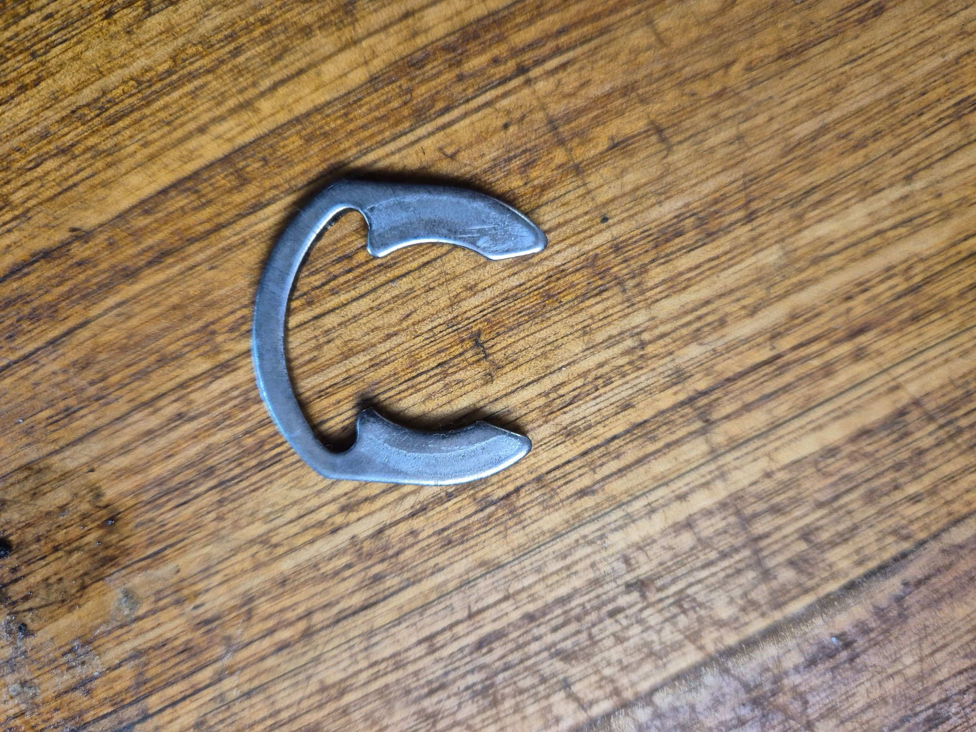

circlip at rear of Reservoir

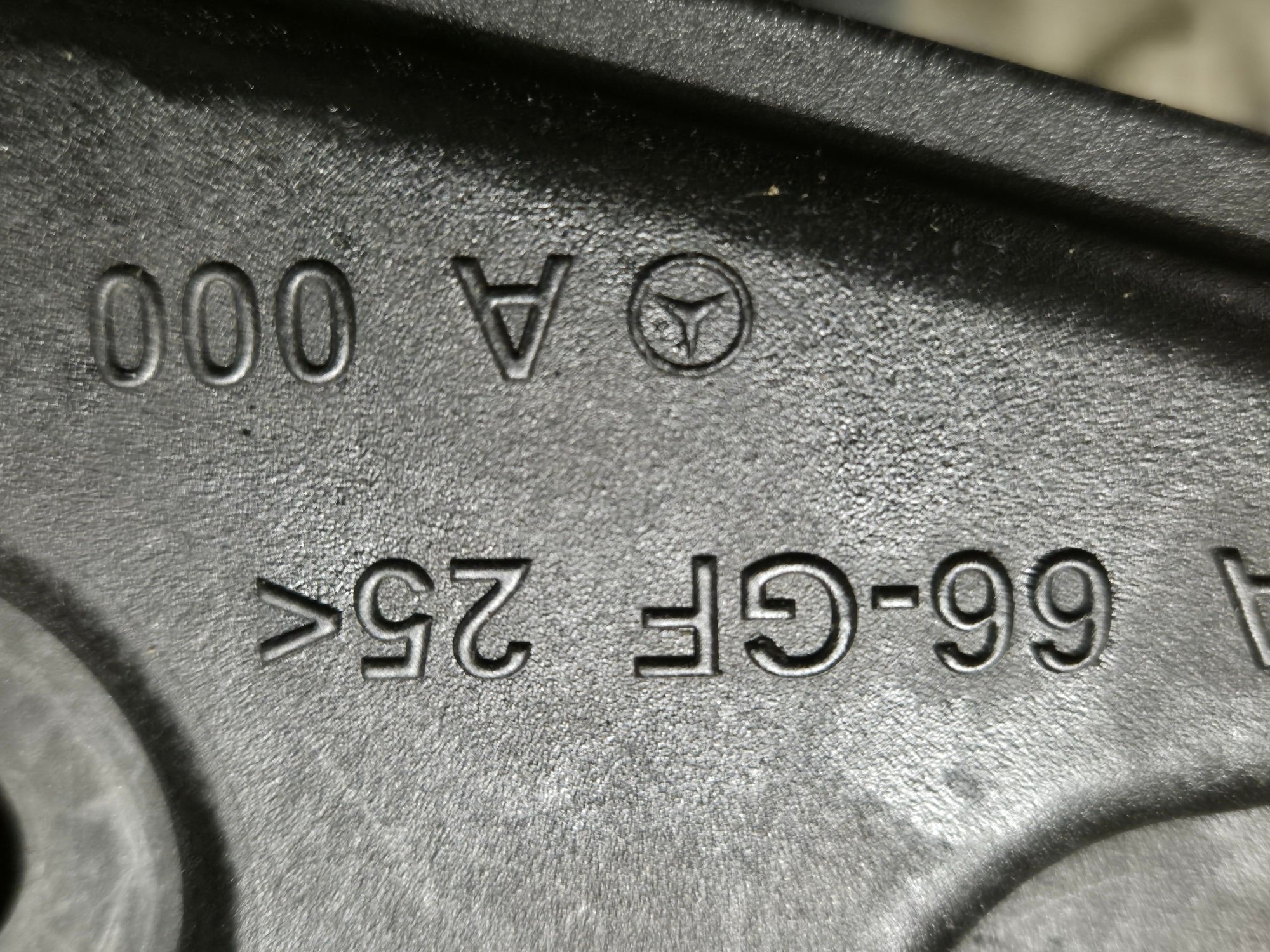

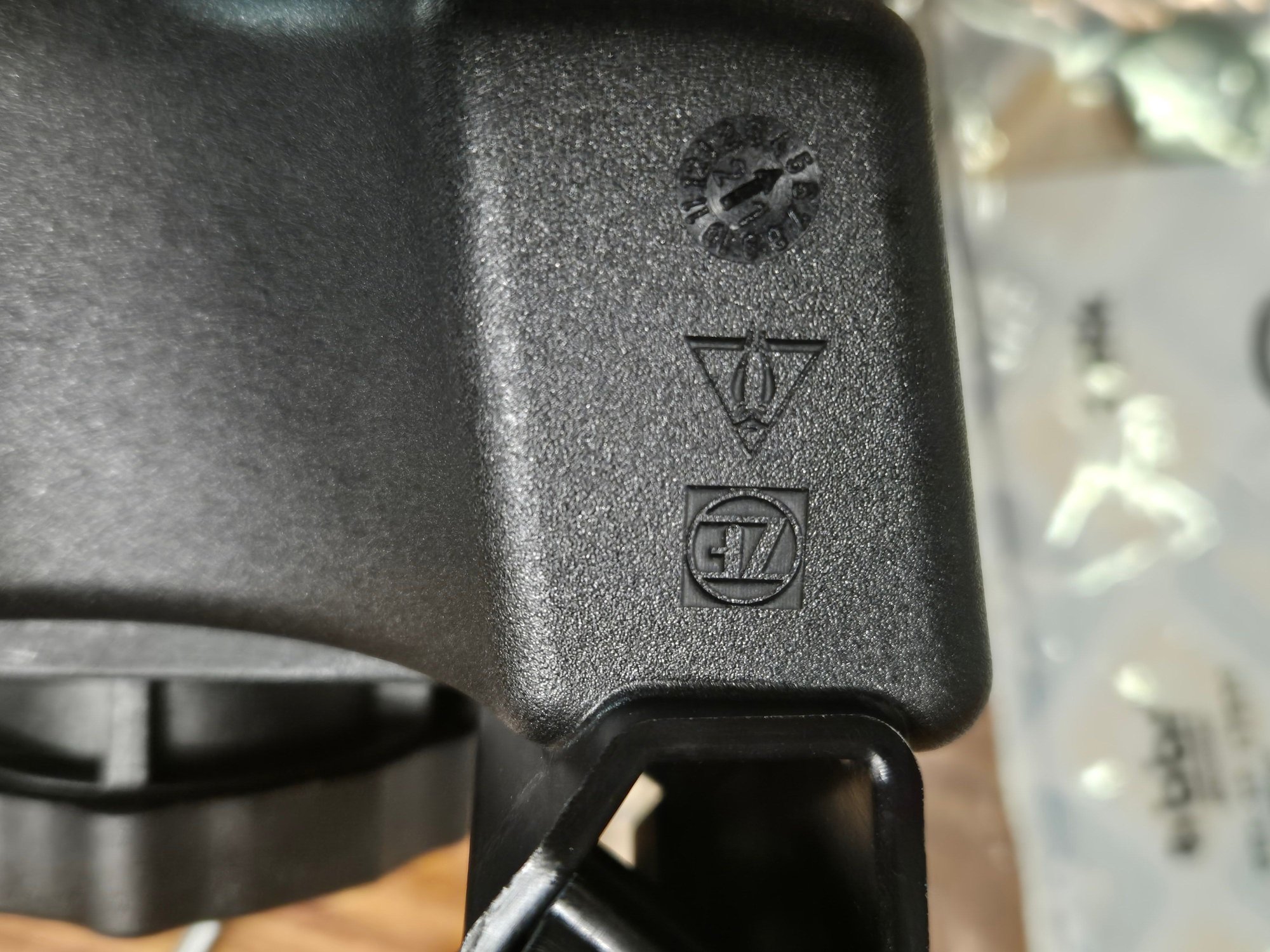

MB Logo sctratched out of Lemforder Part

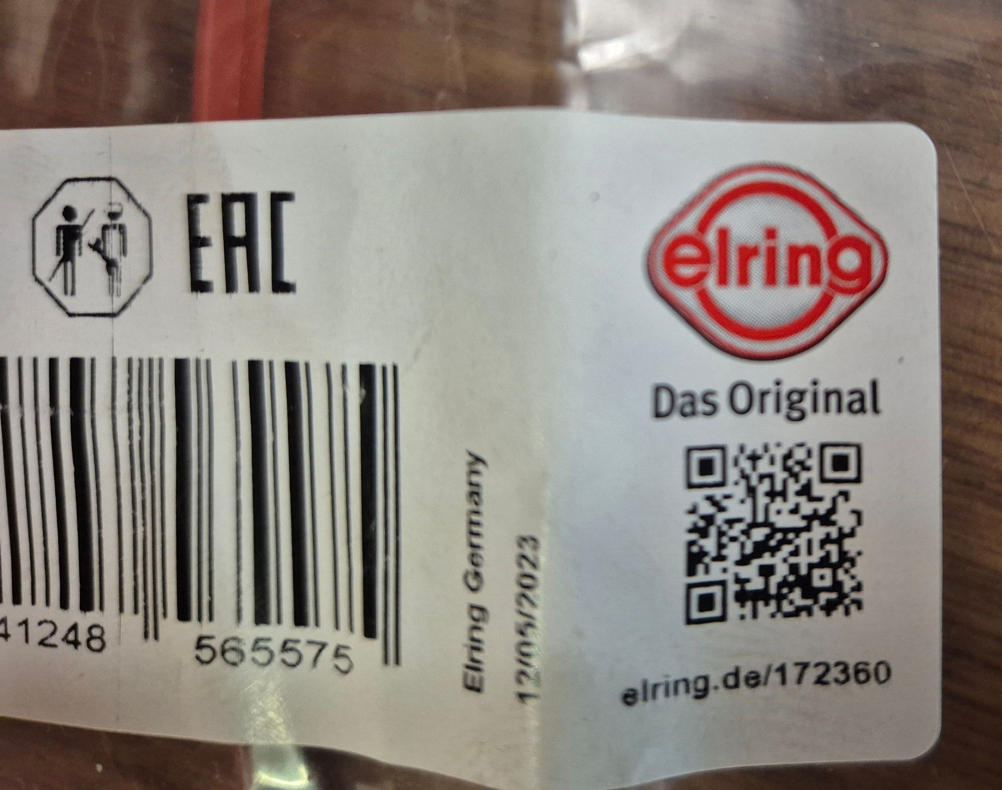

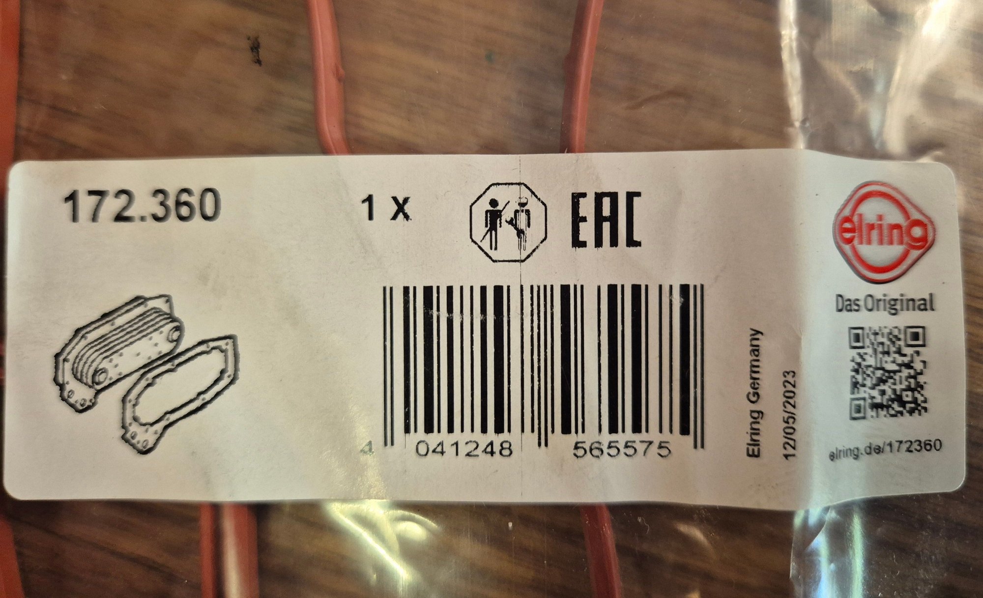

Elring Seal Part No.

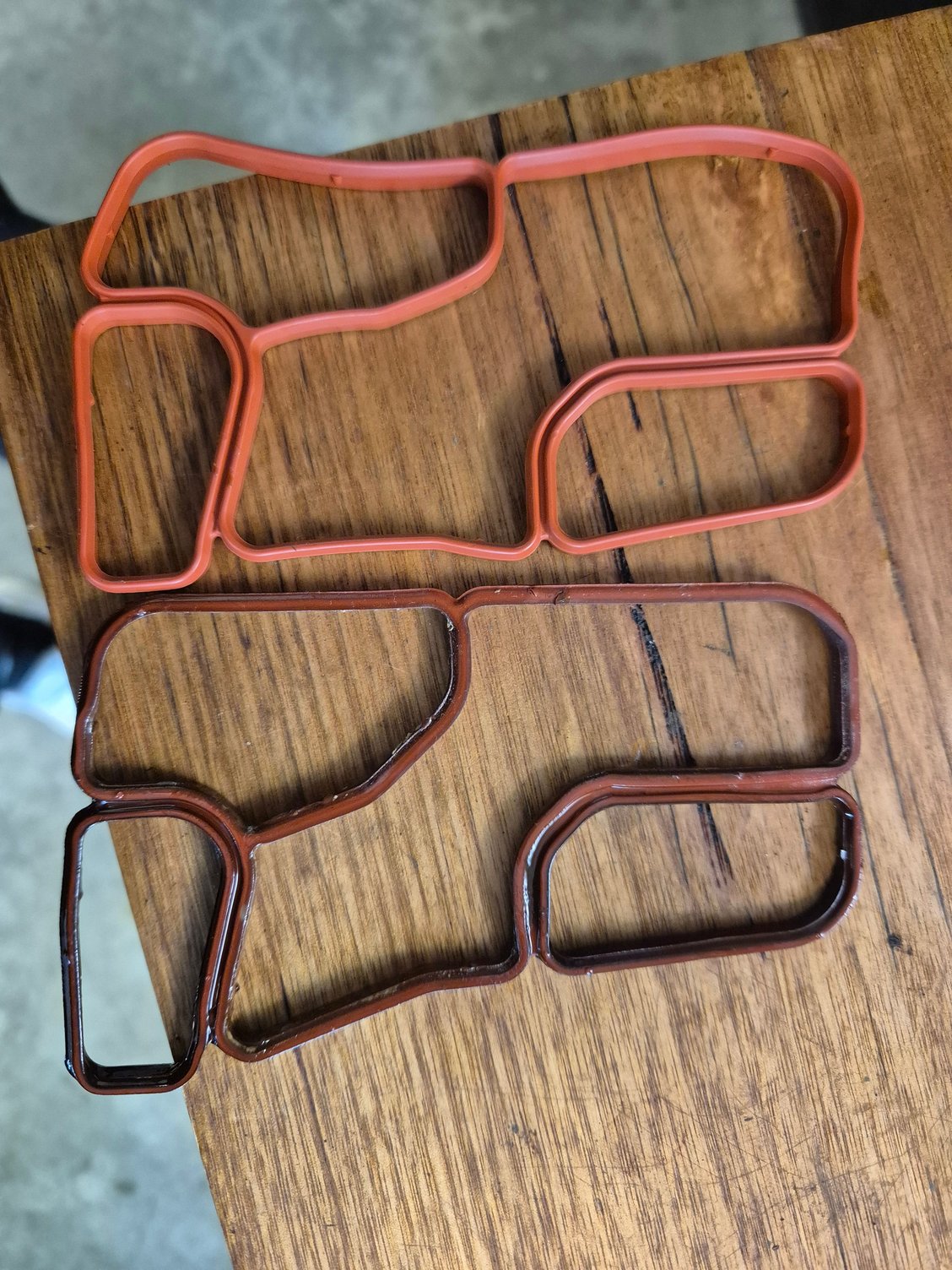

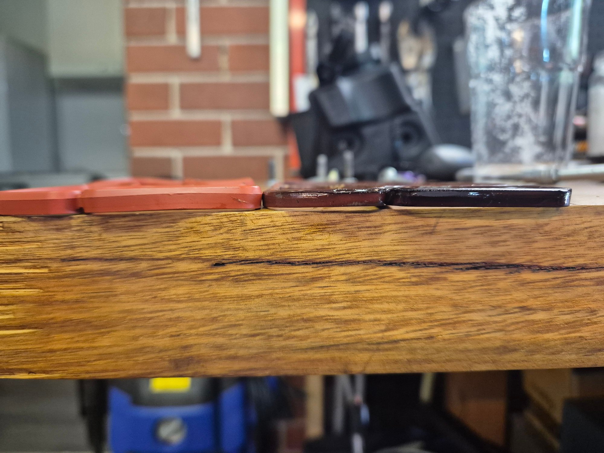

New Seal (top) v old seal
New seal (left) v old seal tbickness

Remove the circlip at the back of the reservoir. I got it out with a pick. Cpuldnt get enough purchase on it with long nose pliers. It's a tight fit so the pick gave me the leverage.

Now you can get at the oil cooler. 5 x torx nuts and it's off. Clean the grooves that hold the gasket and install gasket. I cleaned the surface of the cooler with a nylon sponge and soaked it in part cleaner to flush it before hot water and soap and allowed to dry.
The new seal was an Elring part (see below).
I'd done this job previously and could only find a Chinese branded seal - that's why it failed inside 50,000km.
Torque Setting for the oil cooler screws are 12Nm

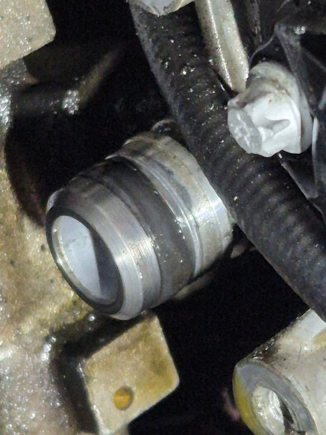

I emoved the old seal from the inlet to the power steering pump and cleaned the housing. Install a new O ring - it's flatter than the usual O rings and I added some steering fluid to give a smooth seal on the reservoir.

Push the circlip back on at the rear. Reinstall the camshaft sensor. and the the radiator hose making sure to put the clip on the thermostat housing before you push the hose back in.

The reservoir I bought was Lemforder which is the original part. Even had the MB Part Number on it with the MB logo scratched out - see photos.
