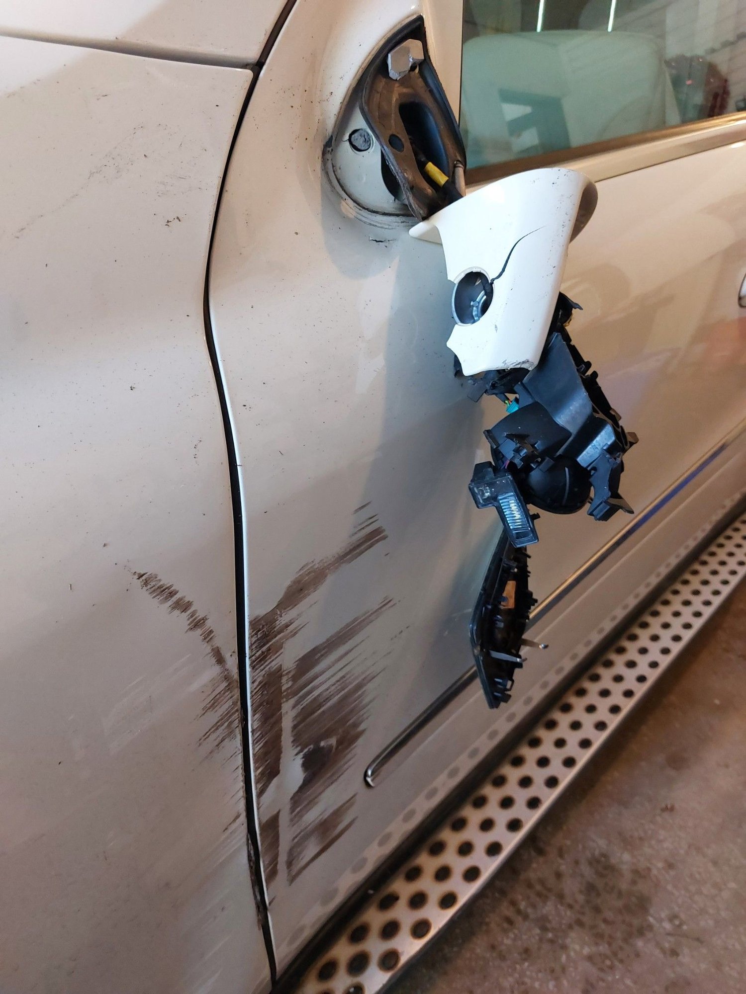

While parking her car, my mom unfortunately had a mishap where she made contact with the wooden garage door frame. She loves the car as is devastated and I'm trying to help her figure out a solution.
The first priority is to get the driver's side sideview mirror replaced. Then start with a paintless dent removal place and see what they can do because the contact was with a wooden garage door frame.

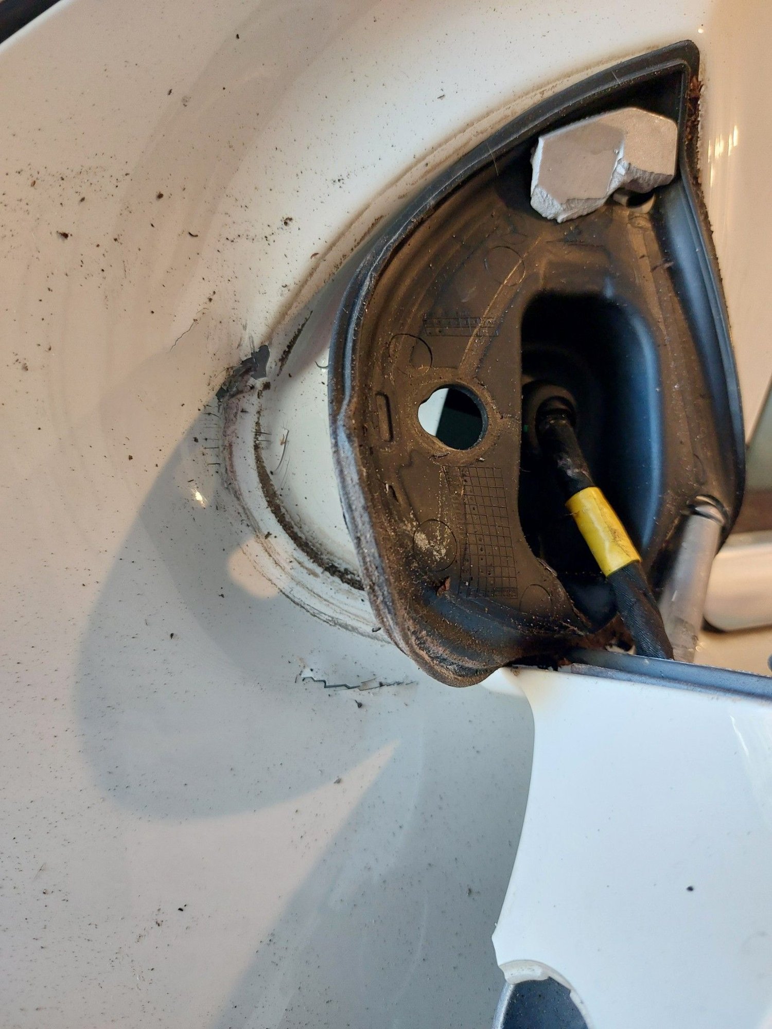

Can someone please take a look at the enclosed photos and give me some idea about the best way to proceed? Is there a straightforward way to remove the sideview mirror assembly that is now dangling? What would it take to get this fixed? Do we have to buy any parts to replace the attachment point of the sideview mirror? Any idea on the cost to get the sideview mirror fixed and working again?

you have couple bolts from inside,get one from junk yard for prob 300-400,new one will cost you 1000 probbably oem its obviously w164 facelift 2010-2011

Thanks! Can you tell from the photo if any interior mounting point is broken and would any other parts besides the mirror need to be purchased?

no thats a 2007,there are couple style mirrors for facelift but 2011 is most likely its this style,double check part numbers when you take it off,and compare to pass side
https://www.ebay.com/itm/31556119966...mis&media=COPY
honestly if i was you id go with this whole chinese assembly its so cheap

Not that it's any of my business, but I have learned that "cheap costs more". I can appreciate trying to save a buck or two, but unless you have some degree of experience working on M/B's, I'd take it to a reputable body shop and have them make the repairs. The door and fender will need to be prepped and refinished......

I posted this in another thread. I went through the same thing wiht my 2010 ML. The mirror is very expensive. I did this:
Just an FYI- the mirrors on my 2010 had wear and some light damage. The mirrors parts (and the mirror itself) were way to expensive to replace. From what I remember, the mirror doesn't come as one assembly- all the parts need to be bought separately (motor, housing, mirror glass etc...)...No thanks
I went to Amazon and bought both the left and right for $160. The mirror glass on these had a distorted look so I bought a mirror glass replacement and 3M'd it on the unit.
If you want, this may be a better option. Replace both with new mirrors.
Here is the mirror glass- you will need part numbers 5478 and 4421

And here is the actual unit:
Amazon Amazon
Not sure what specific mirror you have, but these are not heated or have blind spot monitors....
Took me about 15/20 minute to install on each side. Pretty straight forward. A few YT videos on how take door panel off. very easy
These are the instructions for the GL but very similar. You don't have to take the door panel off- just pry anough to be able to get to the connector to unplug it- you can lay on the ground and look up and put your hand in there to disconnect and reconnect new mirror. Give it a shot. I'm not a big DIY'er but this was simple to do
