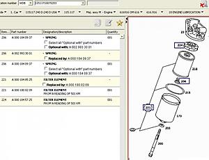

Answer

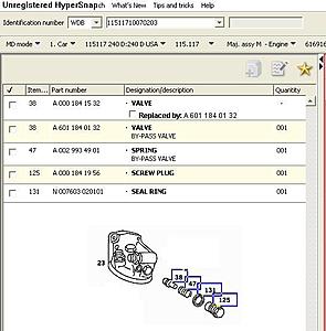

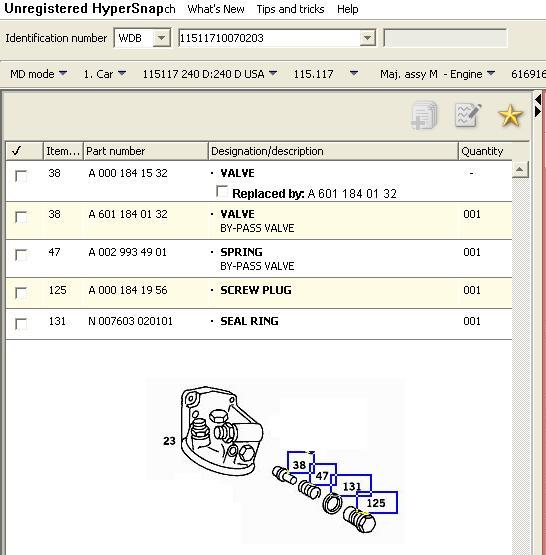

My concerns would be:
#1. The BYPASS valve may be damaged or stuck open.
Requiring the following parts to repair it.
Valve MB# 6011840132
http://www.pelicanparts.com/cgi-bin/...40132&x=11&y=9
Spring MB# 0029934901
http://www.pelicanparts.com/cgi-bin/...34901&x=14&y=5
Seal ring MB# 007603020101
http://www.pelicanparts.com/cgi-bin/...0101&x=15&y=10

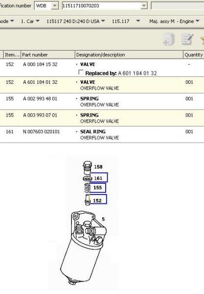

#2. The OVERFLOW valve may be damaged or stuck open.
Spring MB# 0029934801
http://www.pelicanparts.com/cgi-bin/...34801&x=15&y=8
The correct oil filter number is
Oil Filter Kit
MB# 0001800209
http://www.pelicanparts.com/cgi-bin/...0209&x=14&y=13
You probably also need these additional parts that get lost.
Oil Filter Screen (Nylon Pre-filter)
MB# 0001845725
http://www.pelicanparts.com/cgi-bin/...45725&x=15&y=9
Spring
MB# 0001840937
http://www.pelicanparts.com/cgi-bin/...40937&x=14&y=9
