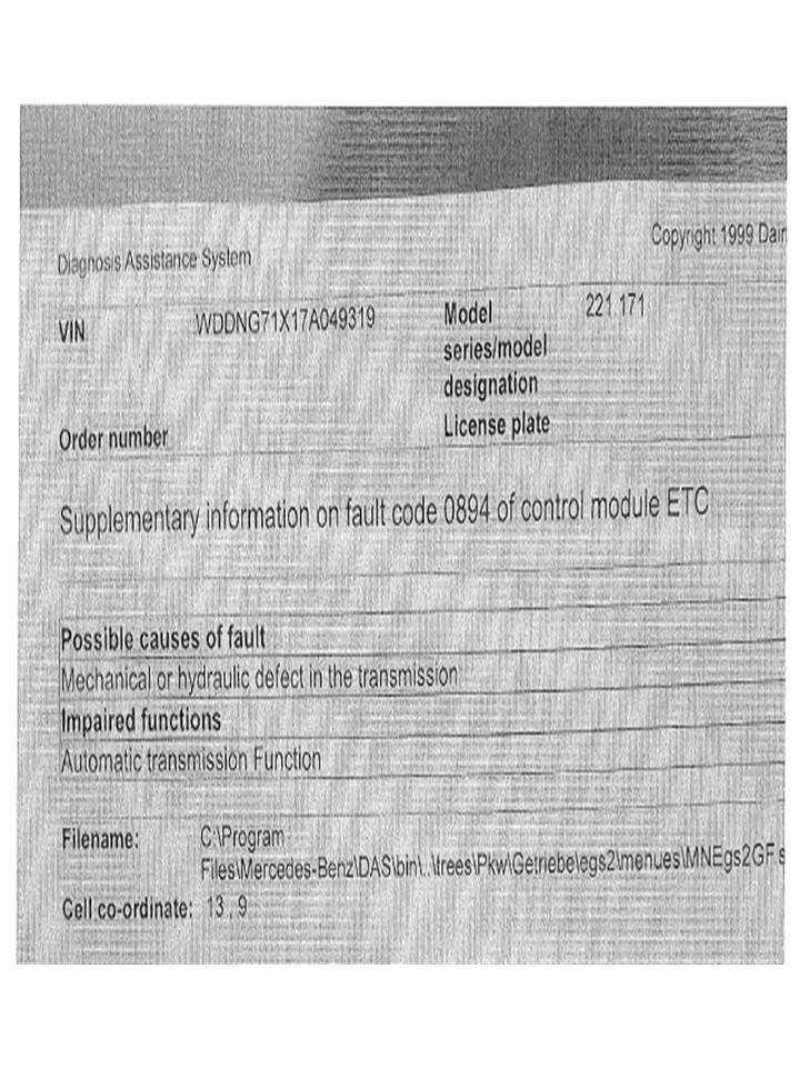

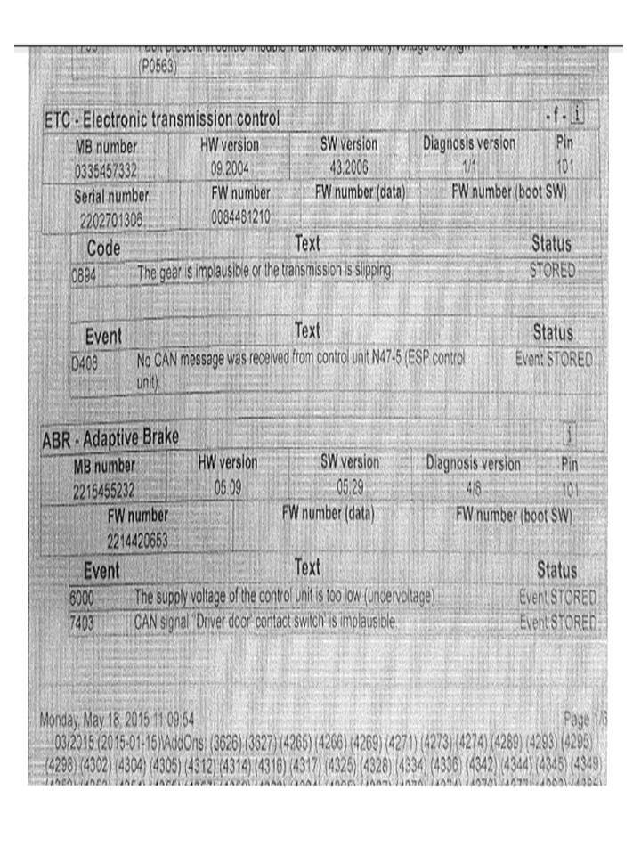

This is exactly what I ended up doing, attached are the results. Anyone know what could be the possible problem to this? I am just interested in the transmission stuff... Kind of hard to see, but Code is: 0894 with Event D408

How many miles and when was the transmission serviced last? As others have said, I would have a diagnostics run while you are there.

The first step I would be taking for this one is to check the oil level in the gearbox.
You're getting a bit ahead of yourself jumping to replacing valve bodies without doing the basic diagnosis steps first.
