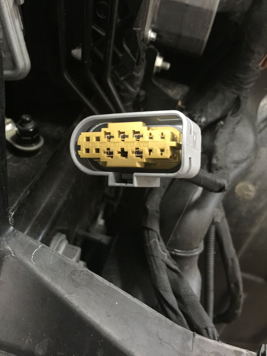

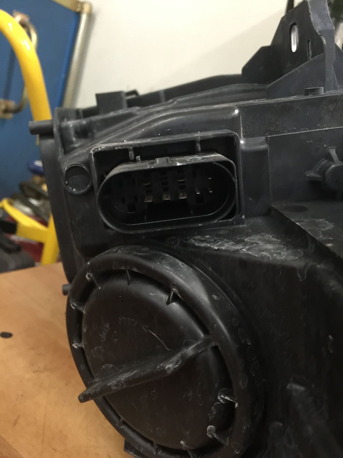

I have bought new LED front lights for my 2014 Mercedes A250 (W176)
My car was standard fittet with normal headlights so we are talking no Xenon.
I have bought "expensive but pretty" the new 2016 LED headlights and I can not get them to work.
They have the same socket as the old lights but it dosen't work when I plug them.
CAN SOMEONE PLEASE HELP ASAP.
Here I have some pictures so everybody know what I am talking about.
Picture 1: the yellow socket in my car for the front lights.
Picture 2: how the old sucket looks like in my old lights.
Picture 3: a picture from the sucket in the new lights.
WHO CAN HELP ME.
LOOK SO MUCH FORWARD TO HEAR FROM YOU.
Picture 1 : sucket in car.
Sucket old head lamp
Sucket new heaflamp

Maybe the lights are defective, try supplying power to test them without plugging in. But on a different thought, I looked into LED , I couldn't find any that got a good review, my installer liked or were made by company with known quality. I went Phillips hid and am more than happy (aim your lights down with HID) so you don't blind people. I've also heard of error codes when trying LEDs , since they use less watts

I have all my aftermarket work done at a good local stereo shop, find a mechanic that can text the lights and Harness, I've bought cables with pins in the wrong place, who knows, everying has to be tested. Leds draw less power , maybe that's affecting the computer?

I would verify the light works and the + - pin location by getting it to light up outside of the car, on a bench, with a separate battery, then find the +- terminal pins on the car lighting harness. See that they match up. I got a " Mercedes " Iphone Jack that had pins crossed wired up, and a few pins missing. I think your light doesn't work , or the wiring isn't correct. To get no light, no dashboard warning, doesn't make sense.

You're going to have to get a wiring diagram of your car & the 2016. And then compare pin locations. I can try to find them on my Mitchell computer system, but you have a European benz. I don't think I have acess to those. I wouldn't put power to them on a bench unless you know which terminals are power. Run the car without headlamps hooked up and see if you getting a dash warning. Then pull the bulbs out of old heads and plug them in. Definetly should get a warning lamp.
