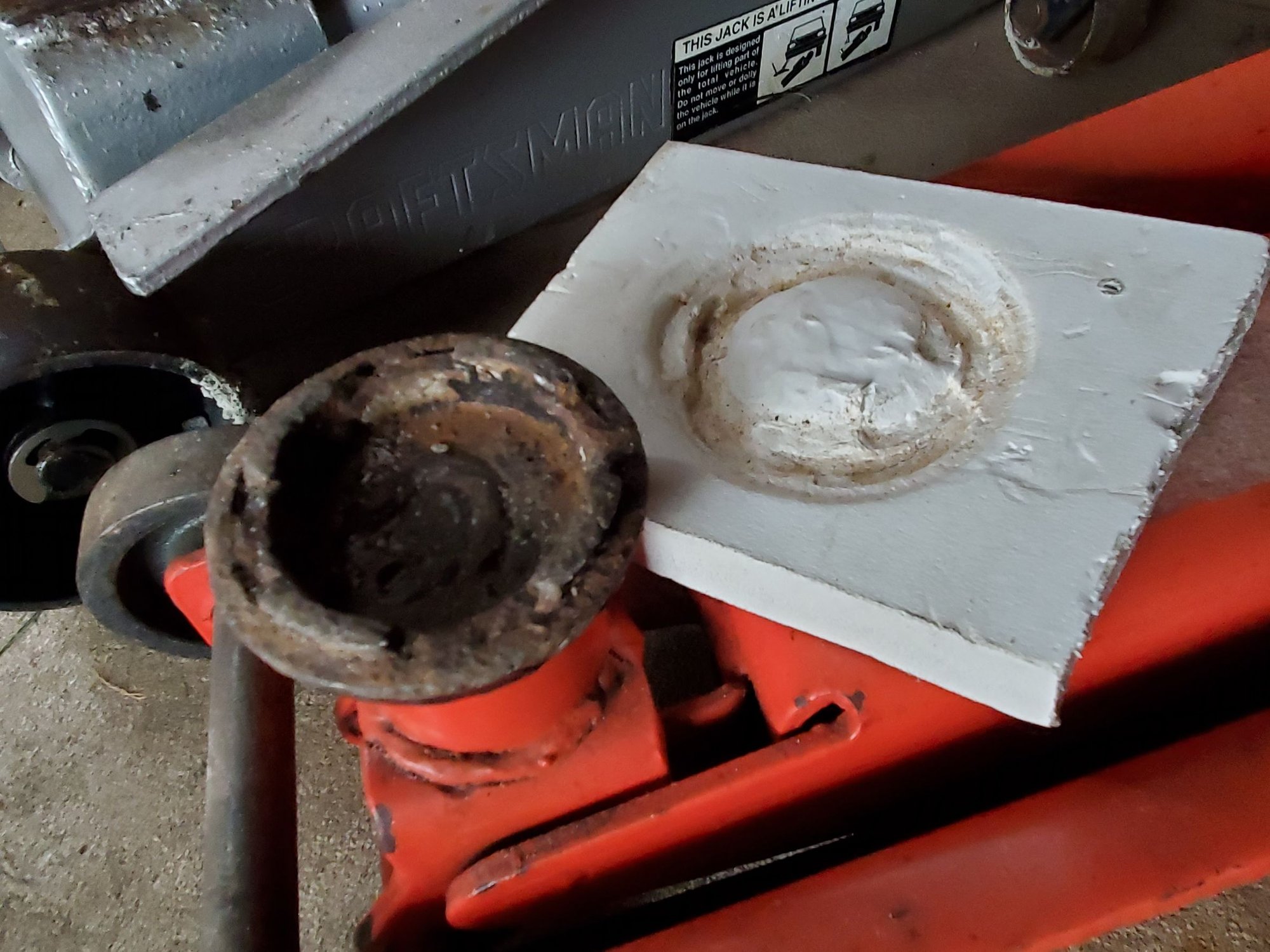

I have an old Craftsman floor jack that still works great. It was leaking fluid at one point so i went ahead and took it apart to measure the o-rings to order new ones and oddly enough it stopped leaking, I think just removing the o-rings and reseating them solved the leaks. I still have new o-rings i ordered if needed. Then I have a Husky suv type floor jack that I got at Home Depot around 2004 that still works great, that just has an additional pipe adapter for height.
I use scrap pieces of azek composite trim to put between the jack and the car to act as a cushion, it compresses a little without cracking so I dont ruin the jacking pads on the car.
My local Lowes has a 50% damaged wood cart i'm always picking thru, sometimes they just tell me to take it for free because they want it gone.

Originally Posted by Chevota
I do like TimC posted, a wood ramp (pix below), but my ramp is simply bigger. I used 2x12 boards stacked 4 or maybe 5 high? They also have a ton of long screws bolting them together, so no chance of coming apart. I cut the leading edges at a 45 to make it easier to drive up. Also, like the picture, the steps need to spaced far apart or my cars front lip will hit before the tire. A store bought ramp would never work for me, the body would hit long before the tire does. But I would NEVER trust a store bought ramp anyway, especially a plastic one.
I don't really care for jack stands on cars like the benz because there aren't a lof of safe places to put them. I think the solid wood ramps or large wood blocks are the way to go. No cinder block bricks either! I've seen that, which is sketchy at best.
Two stories: One, when I was ~16, a friend used a bottle jack to lift his camero up for a look-c. He jacked the frame up at the front center, then slid his skull under and BOOM! the jack slipped off the frame, and lucky for him the jack caught the radiator support, which it bent to Fk, but stopped the fame from popping his skull like a hammer to an egg. If I recall correctly, the frame pushed his nose leaving a black grime mark on it. Had it not caught the rad support, and "if" he survived, he would be hating life.
Years later I bought a fancy new aluminum racing floor jack. It was sweet, light, but made in china... I jacked up my Benz, from the front center, thought about sticking my skull under there, but Hmmm, better get some stands. I turn to get them and BAM!!!! It dropped the car. I don't mean lowered it fast, I mean dropped it like the jack instantly vanished. So now I'm exponentially more paranoid of getting under a car, hence the super wood ramps I made. I've had a few other jack fail stories too, like using a small floor jack to lift my current car up by the diff, only to watch the car slowly move to once side and fall. So don't think that's safe either. Plus misc similar stories with bottle and farm jacks.
When I work on my truck, I don't need to jack it up, but if I take a wheel off I'll stick it under the axle in case it falls, for whatever reason. When I do things like the brakes on my car, I'll use a floor jack, but at all times I position myself so if the jacks does that drop trick it won't get me. If I need to get under there for any reason, the wheel goes under first.
Somewhat unrelated story: I was guiding a 3200lb load to a truck bed, that was being lifted/moved via a rather large crane. 3200 was nothing for this puppy, like you holding a soda. When the load was pretty much over me, the cable snapped!!! No clue how that was possible, but it did. It broke at the spool and it had some sort of safety feature to grab the cable when this happens, which it did, and the load only dropped a couple feet. Fyi, sht happens.
