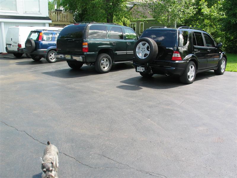

I removed the spare and all the hardware. Saved the air pump and placed it in the right side by the cd changer. I bought a full size spare and mounted it on a Bonarue spare tire carrier the slide into the receiver hitch I also have installed. In the extra space I have installed the third row seats.
You can't mount a larger spare to the factory bracket without spacers (I've tried) and if you did you will not be happy with the loss of space (almost half the width back there). The cover will not go over the full size spare.
I do not carry the spare with me, just the pump. My full size spare goes with me out town only. I figure if I pick up a nail the pump will do for a slow leak. I keep the small spare at home and the large at work so if I would need it I have someone bring it.
I have mounted the spare carrier back in temporarily without the covers for one state trips, but for longer trips I only want the full size outside with cargo area available for luggage or third seats.
The Bonarue spare carrier will still allow you to tow while installed on the rear.
Here's some pics while I was performing the surgery. The last is after arriving in Nova Scotia, no problems with the setup.

WOW, I LIKE THAT!!! Where did you purchase that? Did you put the tow hitch on yourself?
Old Mar 13, 2005 | 05:18 PM
mbenzman's Avatar
Joined: May 2003
Posts: 784
From: Ga.
All of them!
The tire is a Dunlop, wheel is by AMG, carrier made by Bonarue, trailer hitch is from special order Mercedes for the ML55 only.
I did all the work myself. If it was the tire carrier itself you were referring to go to bonarue.com or do a search as you can only buy it from them. A friend of mine bought one for use on his lifted 4x4 excursion with 35's.
