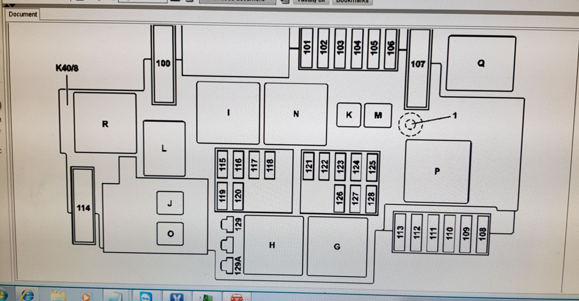

Found another fuse. Initially I checked Fuse 111 which runs to the starter solenoid.
Then I checked the circuit diagram and found another fuse (129) which is just before the starter relay, turns out that was the culprit
Fuse diagram attached, hope this helps someone in future
