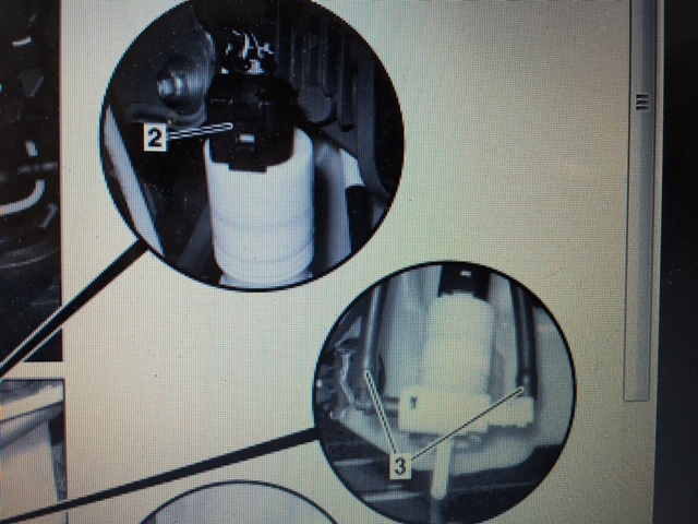

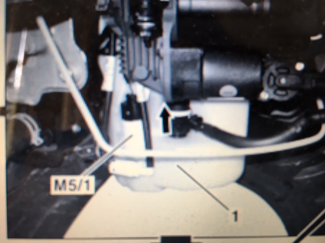

I would think the front water pump motor is dead. My other vehicle has same problem. There are 2 tubings at the bottom of the reservoir, swap them around to see if the front works and the rear is not then you know it is the water pump is dead.
Attached Thumbnails Windshield washer fluid not coming out?-img_6107-1.jpg   Windshield washer fluid not coming out?-img_6107.jpg   Windshield washer fluid not coming out?-img_6108-1.jpg   Windshield washer fluid not coming out?-img_6108.jpg   Windshield washer fluid not coming out?-img_6109-1.jpg
Windshield washer fluid not coming out?-img_6109.jpg   Windshield washer fluid not coming out?-img_6110-1.jpg   Windshield washer fluid not coming out?-img_6112.jpg   Windshield washer fluid not coming out?-img_6111.jpg
