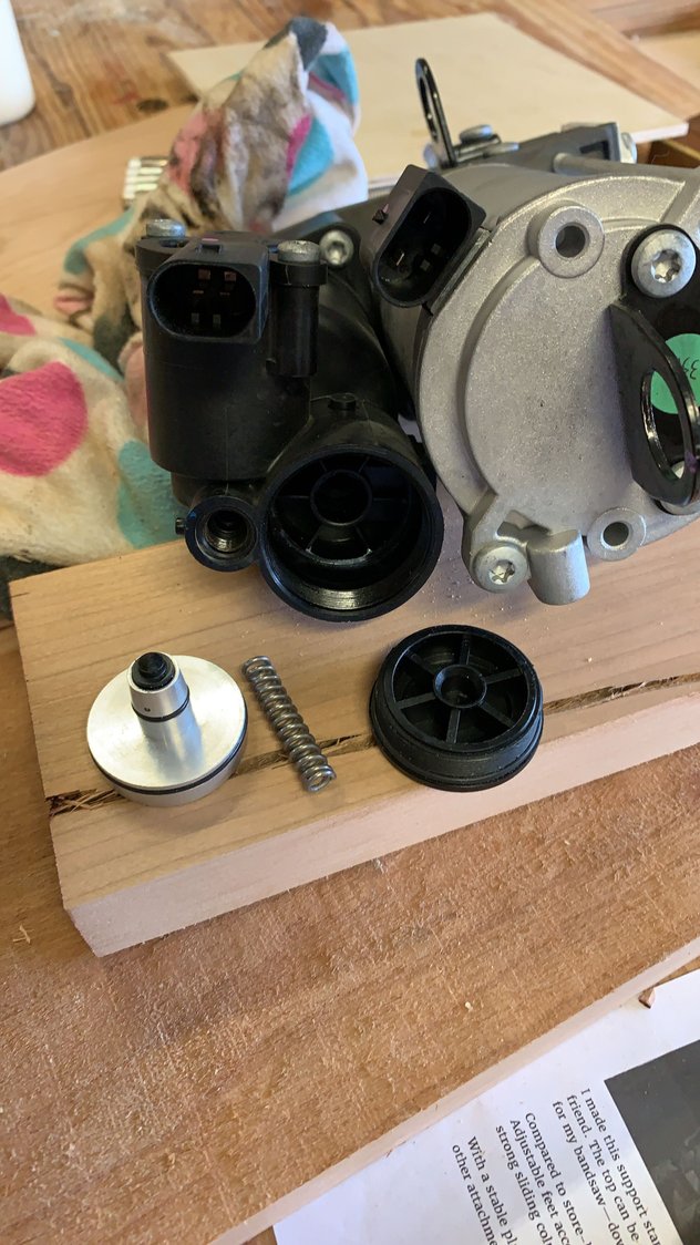

Well there’s yer problem! The compressor failed! Got the wheel liner loosened and out fell the spring, aluminum valve and black cap. Props to FCPEuro as they are rushing a replacement pump out now.
In the mean time I reassembled and tightened things back up. Seems to be working and holding air as designed. No clue as to origin of the failure.
