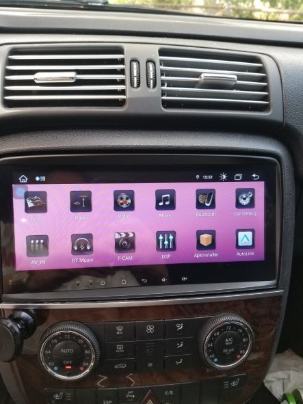

I had a perfect 2008 Silver/Black R with 78K mi, but it was totaled when a woman turned in front of my wife going 30 mph. I found this one in Texas and it needed work but it was the best one I could afford. The body was rough and it lived outside most of its life, but I am slowly trying to make it perfect
2011 81K \
Black / black tex
6 passenger - no center console
Add tow hitch
Aux plug in glove box .

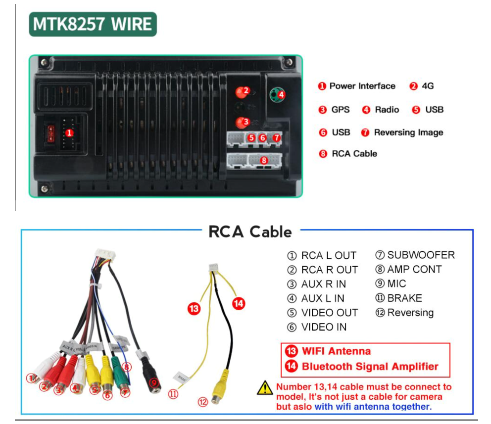

I recently switched to 20" rims - thanks to threeMBs. I am in the process of updating the COMMAND with a 8G ram 128G radio. I have not sorted out the details yet: Anyone know:
  • How to connect the bluetooth - there are 2 blue wires on the new unit - not sure how to connect them
  • sirius raido - not sure where the antenna is
  • I cant seem to figure out What is the Green Fraka, Blue Fraka, and the yellow fraka, plugs.
  • Also not sure what to do about the brown fiberoptic cables with the red lights.
I love the R350 and I use it to tow my race cars - any help with the radio would be most welcomed
Tim

this is the 2nd part of the wiring diagram i got online

Hey tim nice R-class! Nice headunit too! Looks factory installed.

My daughter has a 2008 R350 that she bought last winter. It's been a bit of a money pit, tbh, but with the used car market being what it is, at least it's a clean, comfortable, safe car with plenty of room.
One thing it needs is a reasonably priced modern head unit with Car Play (hopefully wireless) and which supports her rear view camera. The one you're installing looks great. Do you mind sharing more about it?
Old Jun 4, 2022 | 03:13 PM
tim gaffney's Avatar
Joined: Jun 2018
Posts: 27
R350
https://a.aliexpress.com/_mKEOrAK
I bought the 8 GM ram, 128GB, it was $467, but I have seen it a bit cheaper.
I had to buy 2 more cables that connect the camera, the other was to connect the in car GPS.
Everything is working except I have not figured out the Sirius directly thru the radio. I can get it when i mirror the phone on the head unit.
It really is a big upgrade to the interior
