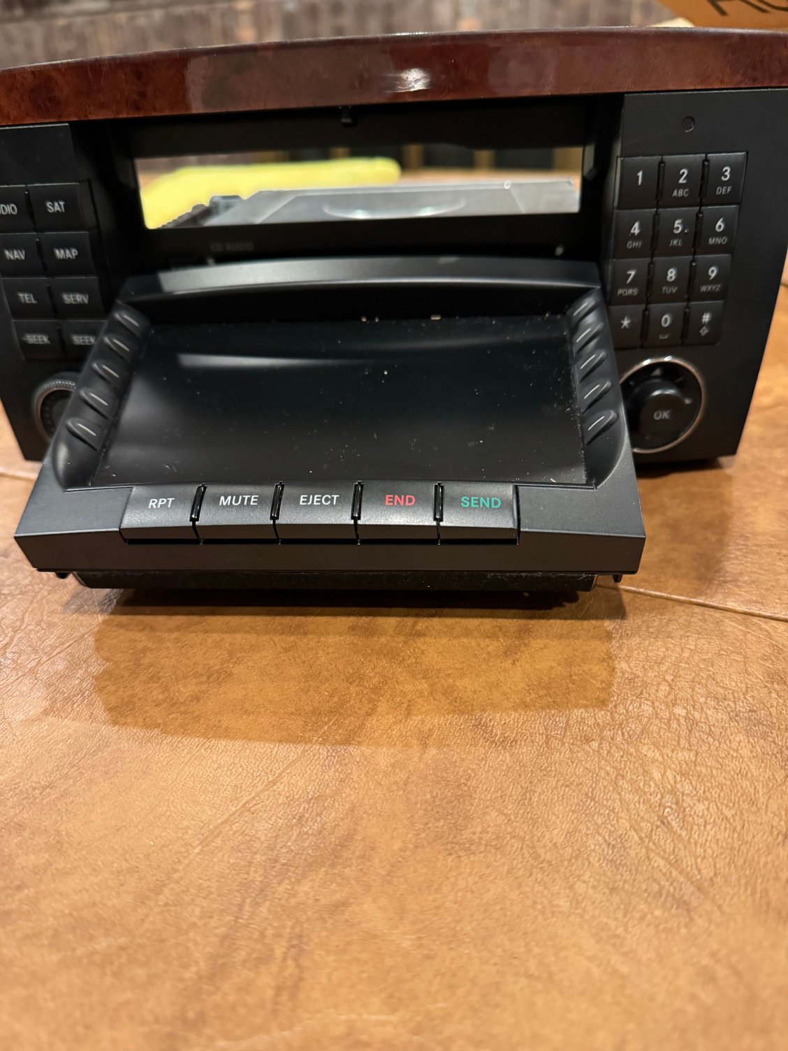

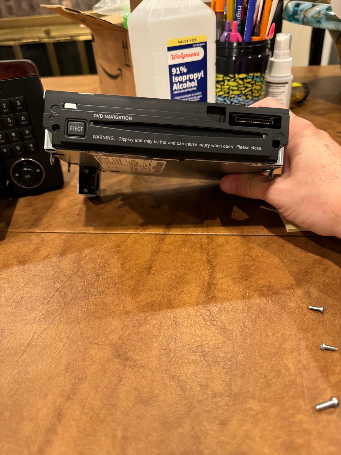

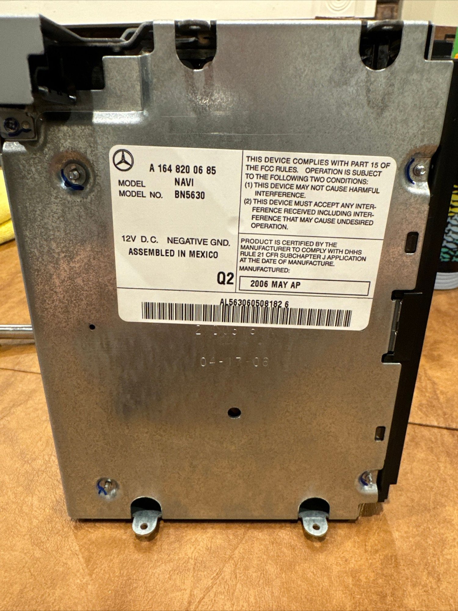

***UPDATE - Did some searching online and found that the NAV\DVD Drive\Computer on the unit itself is typically what causes this issue. With a bit of work, I was able to pull the radio, I broke one of the locking clips as it was not sliding down, but was still able to get the radio out. After, I started unscrewing lots of stuff till I got the entire metal casing for the Nav drive OUT. Plugged it back in, this time, no GPS antenna, and it works, I have radio and COMMAND back. I guess I don't care, I use my iPhone for Navigation when needed anyways!

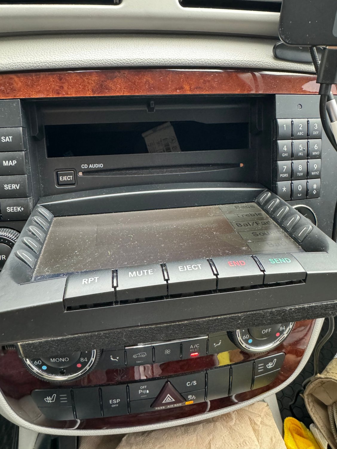

I was wrong. There is a CD player below the nav. My car is 06. Same system 06-08 I believe. Now my car has a cd changer also in glove box. maybe that was an option. See pic below.

I don’t recall the lower cd player being removable. Look at used units on eBay and the pictures should be clear enough to tell if can be dismantled. I would just buy a used unit. Was going to do that, but once I got it working just left it alone. Downside, with no Nav now I can’t change the clock time. Probably could fix with some programming, but I don’t have access to that and not worth it to me to fix right now.
