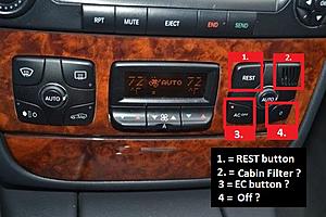

Thank You Jeff.. I didn't know where to find the EC Button.. But I guess Google images helped me... can you please confirm if my assumptions are correct (see attached image) ?
Also by "ambient air temp" - Did you mean the set auto temperature on display or outside temperature ?

Yes, button 3 is the ec button I reffered to.. The temp displayed on the cluster (outside air temp)..

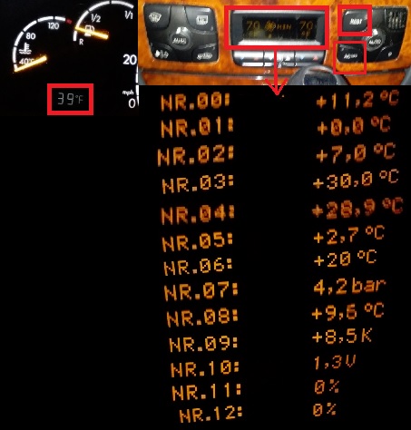

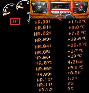

Thanks Jeff.. Attaching my results..

#1 is your in car temp sensor. It is reading 0.. the climate controll thinks the cars interior temp is 0 deg.. you need to replace the cabin air temp sensor. The evaporator temp is very cold like it should be. Because the car thinks it is colder in the car than it really is it is queing the duovalve to open and let warm engine coolant into the heater cores. Fixing cabin temp sensor will alow duovalve to close and back to cold you go! Hope this has been helpful. Keep us posted...
