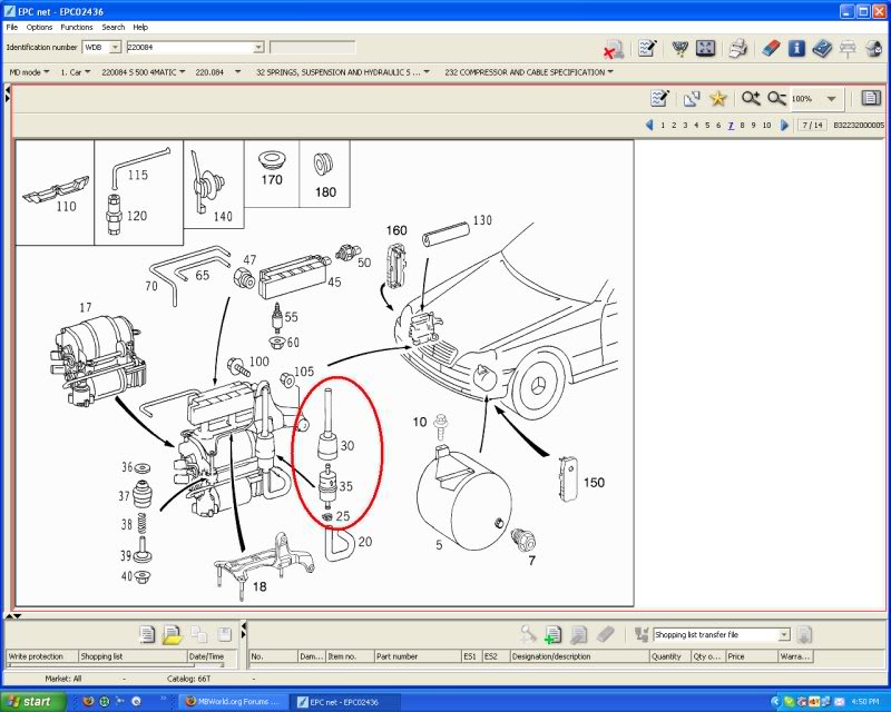

There is one small line for the outside air that enters, and for the system air that exits, the pump for the system. The line from the pump should run to a filter that is essentially a small in-line fuel filter. The filter and it's line run up into the chassis near the pump, to protect the line from ingesting water from the road, but it should still be easily visible.
http://www.benzworld.org/forums/w220...ce-filter.html

Had the afternoon to myself today and weather was good so decided to see what's going on.
The problem was the rubber mounts being worn, and the springs that support the compressor being weak.
The filter Wally mentioned was there (35 on diagram)
So by replacing items 36 to 40, I no longer have a problem.
Just for reference, you can and always will be able to hear the pump when its running.
It shouldn't be obtrusive, and you definitely shouldn't feel any vibration.
But the pump is a small electrical compressor and will be audible if you know what to listen for.
That's not my opinion, but the opinion of 3 trained mechanics from the Mercedes dealership.
