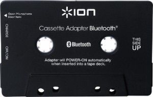

Then this is your friend:
$25 at Best Buy
It's not a "perfect" solution but compared to the cost of an integration module from Grom or MoBridge it's worth the extra hassle. That is that it contains a battery that needs either to be permanently connected to power in the car, or ejected every few days to be recharged.
Permanent power is doable with some minor surgery. You need to remove COMAND (6 #20 Torx Screws), then remove the top cover of COMAND and run the micro USB power cable up and back so the cassette mechanism can "swallow" the cassette while its attached to the power cable and still close. It'll make sense the minute you see it. Route the cable back out into the cabin to a 12v receptacle.
You'll have phone and streaming BT audio once paired. Sound quality is very good, however between tracks you may hear some hiss. The cassette playback head is relatively "hot" impedance wise so you'll get the sense the Bose is more powerful for music. Engaging Dolby noise reduction can kill any hiss but will cut treble as well.
You may also hear the sound of the cassette players motor working.
