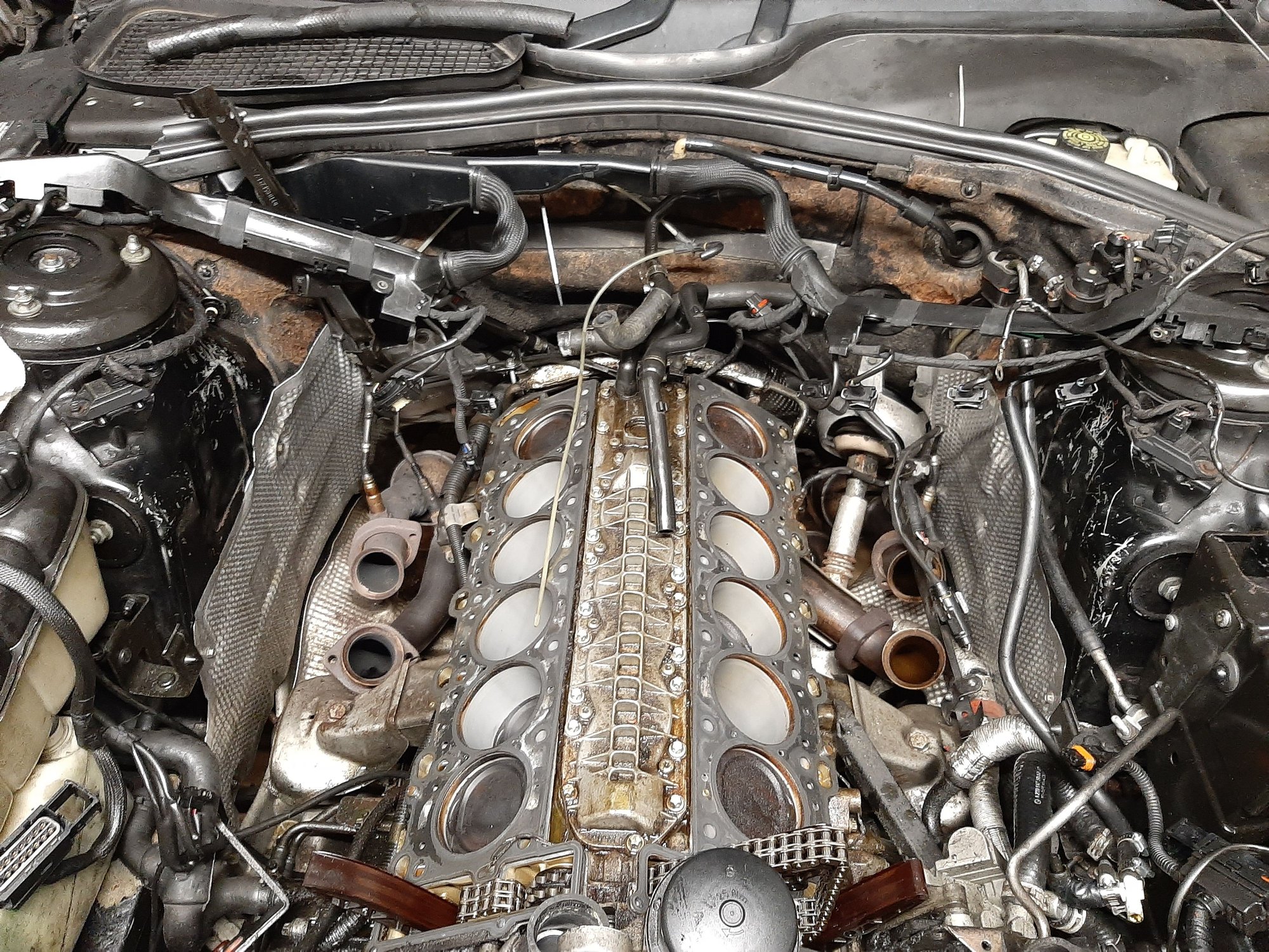

Attached the view of the hoses at the rear.
A hint: make sure the crankcase vent (low speed) venturi in the front right valve cover was taken apart and cleaned as per the MB Service Bulletin.
When it cloggs, it is the cause of the oil cooler failure (MB never acknowledged that that).
Search for my posts/comments on this.
Again - you are now a member of the "Oil cooler" club!

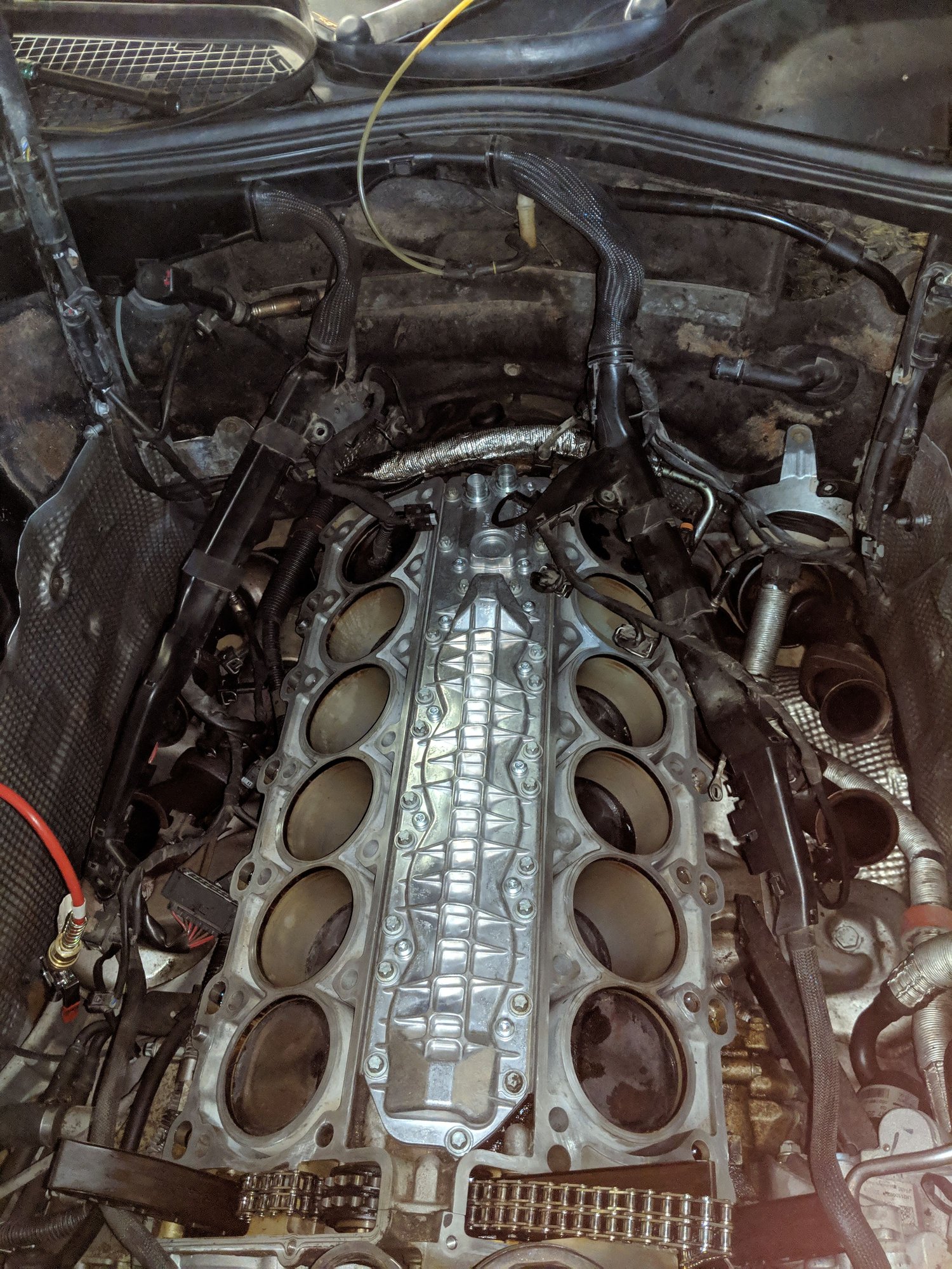

2001 S600 right cylinder head off
Thanks a lot Sir. I just took off the right side but I think that I took too many pins (4) all together. I will try to put them back hopefully I dont run into any problems.
2001 S600 right cyl head removed. Doing the dreaded oil cooler job

That engine looks brand new inside !

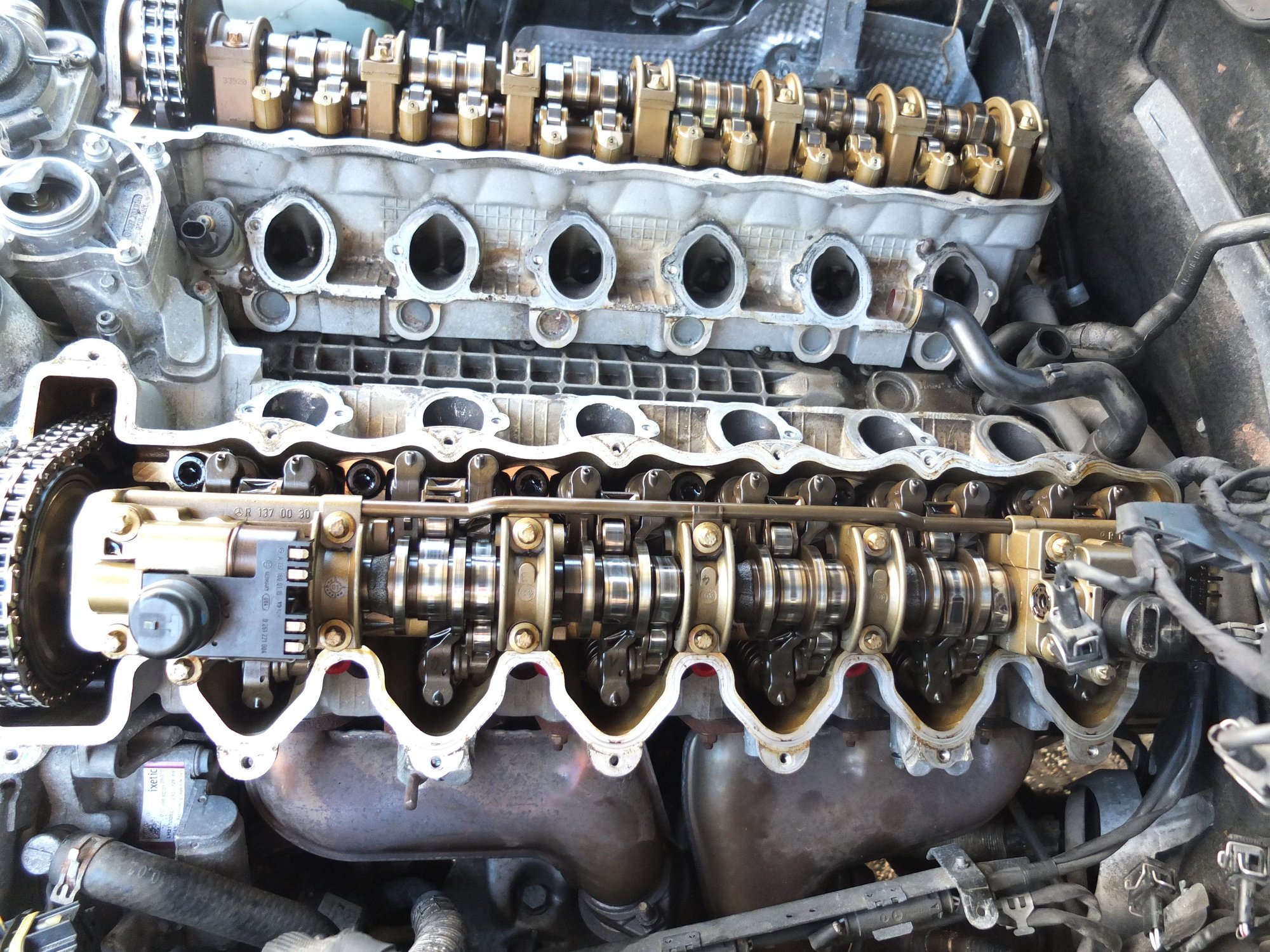

Yes Sir, Tusabes. It's great to hear from you. You are one of the best in the MB Forum. I learned a lot from You in the past. Yeah I bought my car a few years back with 57K miles on it. It has now 80K on it. The oil cooler was leaking really bad and killed many coil packs. This coming Wednesday, I will remove the Left Cylinder head and finally get to the oil cooler. I will keep you posted. I already made a couple of mistakes, I took out too many Guide Rail pins hopefully I can put them back and also I forgot to mark where the short Cylinder Head bolts go. I dont see where they go in the WIS program. Hopefully you can help me.

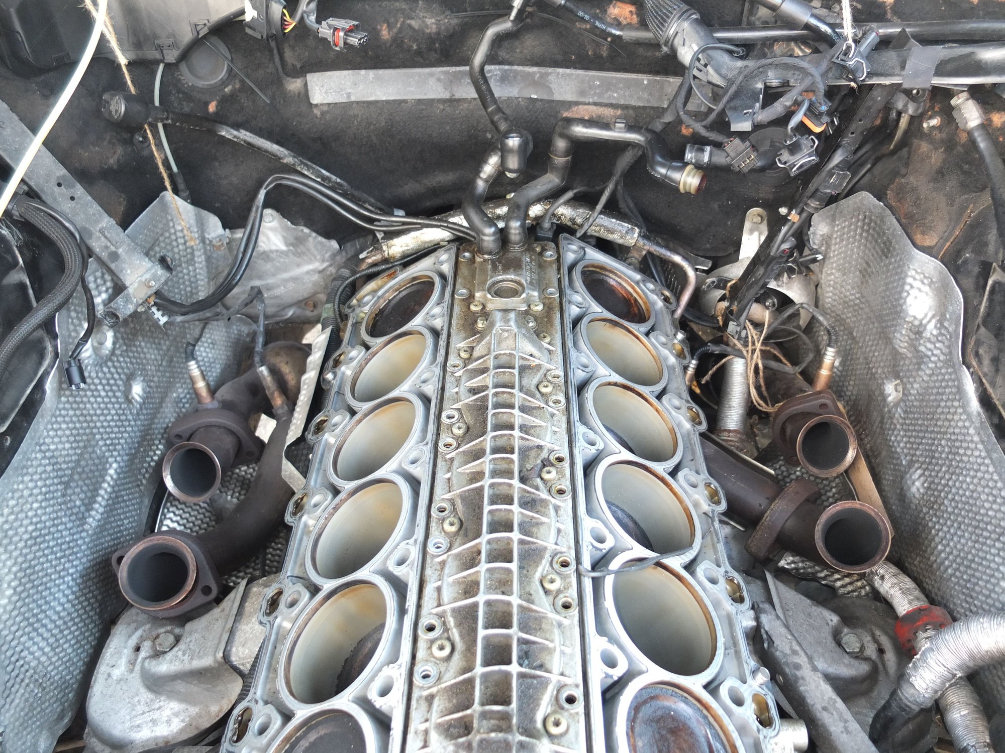

Update 2001 S600 both cylinder heads off
Hi there Tusabes, Kraut56 and everyone else. Both heads are off. I will remove and replace the oil cooler Monday as I work this weekend. In the meantime, dont hesitate to let me know what gasket sealant/silicone RTV you guys used when you did yours. My new oil cooler came with it's own seal. Is there another seal to replace?
