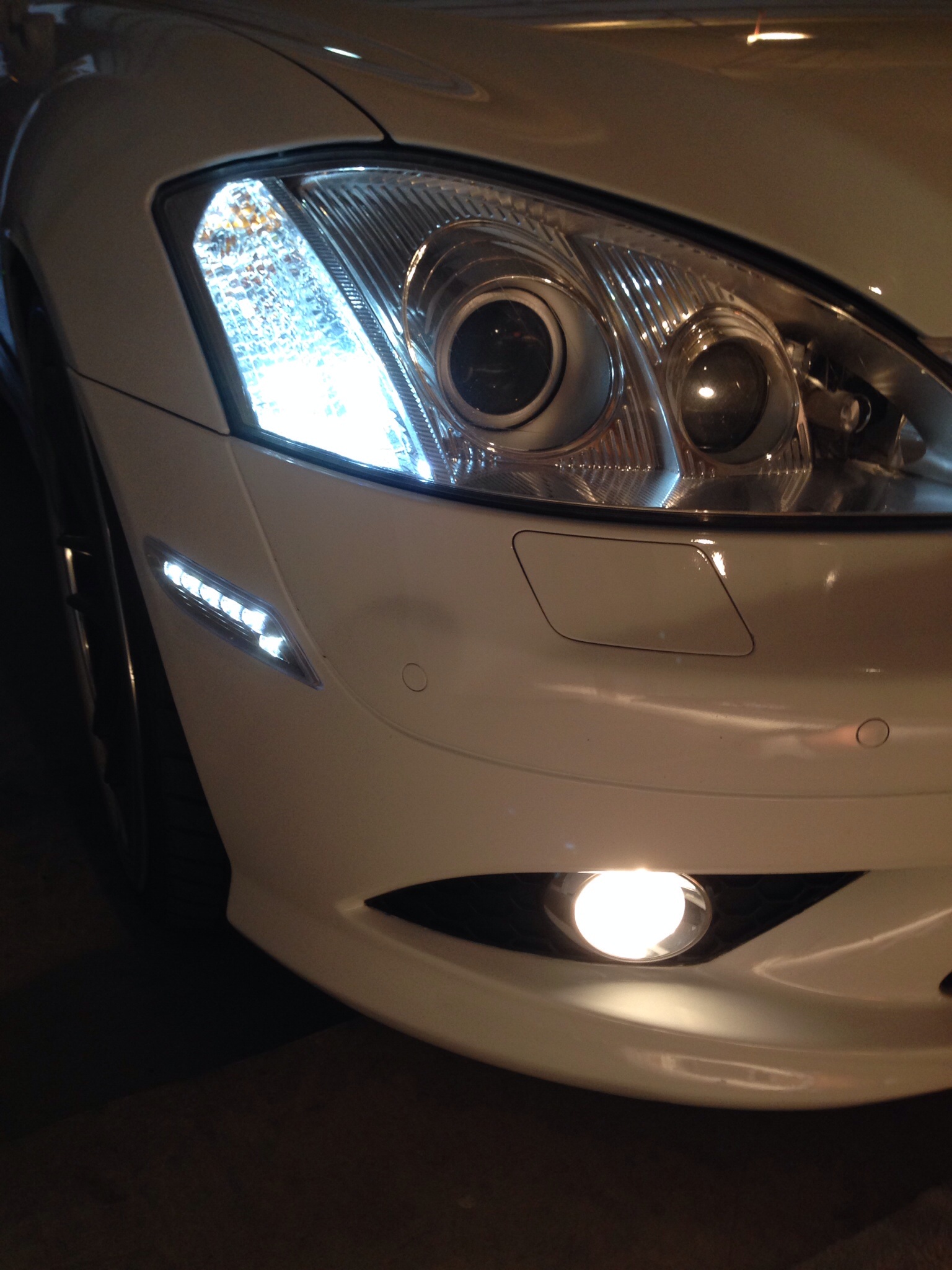

I'm in the middle of redoing my lighting on my car. I went with white led bumper markers and white led running lights to match. Question is, should I go with HID foglight kit or just LED bulbs for the fogs? Not sure which route to go and looking for feedback and pics on your setup.
Heres a pic of the led running lights and bumper markers. Opinions are welcome. Picture does make the color look more blue than it really is. It's pretty white in person.

I think they look good. Which parts/vendor did you use for those?
I'm interested in switching my fogs for LED's too but I haven't found anyone selling them. Let me know what you find.

Like it. How did you access the running lights?

It was sort of a pain but pretty easy. I turned my wheel all the way inward and removed the pin and screws holding the mudguards in. That allowed me access to the running light and from there I just felt my way to the connector. It's a twist connector so you'll have to feel your way to it and twist it out. It took me a second to figure the best way for me to grab it and twist but pretty simple and made a huge difference in my book.

Certainly improves the looks. But does the led serve the purpose of a fog lamp?
