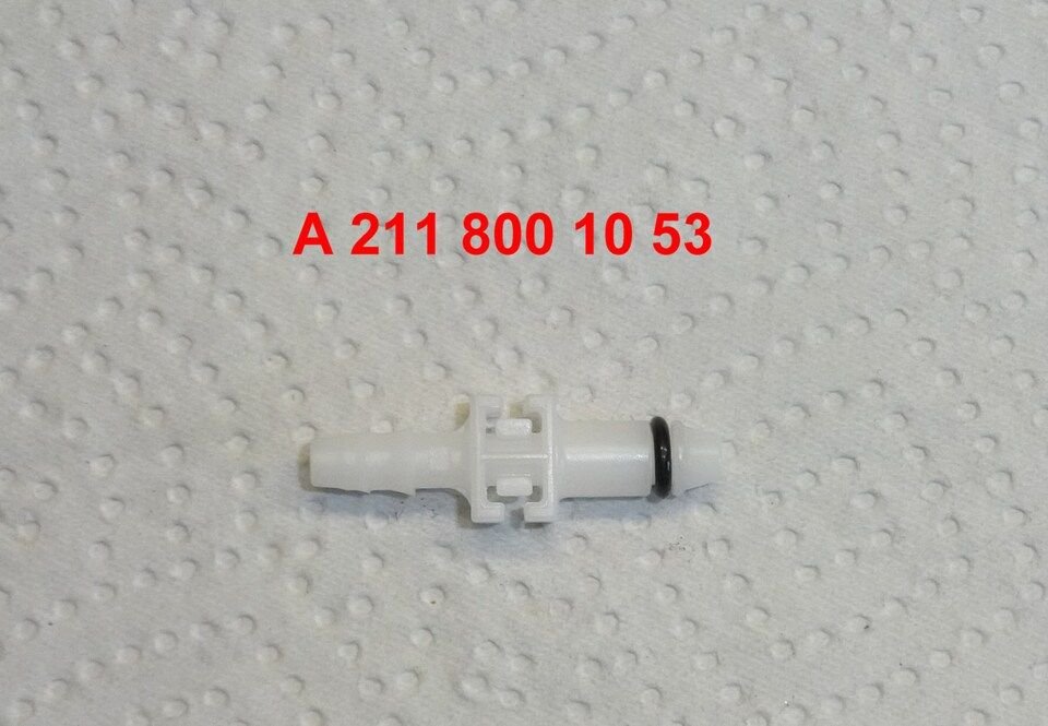

Some part numbers
FYI I found some part numbers for hose lines that includes the connector from E220 Bluetec. The repair items are for other hose connectors but included them if anyone finds this
A0008002015 HOSE LINE
BETWEEN BASE AND VALVE
A0069973989 RS PLUG CONNECTION
REPAIR SOLUTION, CONNECTOR 001
A0069972389 PLUG CONNECTION
FOR REPAIR
Edit:
Also found the actual connector on a German forum:
A 211 800 10 53 Multicontour hose connector

Be aware the smaller lower spec cars (I guess lower air flow rates) have fittings that look the same but are half size... with the OD of the pipes on small cars fitting inside the ID of the big pipe fittings as used on W221 seats
