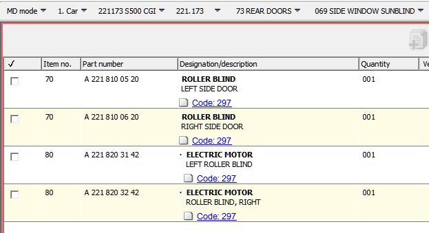

Remove door panel: http://workshop-manuals.com/mercedes...d_replacement/ + next page
Remove blind: http://workshop-manuals.com/mercedes...nd/page_19389/ + next page
