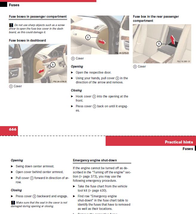

You can check 143 at rear fuse panel if fine, long shot pull for several minutes in an attempt to reset. If this fails most common fix someone may need to reset using MB DAS (diagnostic system).

Ok, maybe I'm still recovering from Thanksgiving drinking but how do you access the fuse box in the rear? The instructions say simply 'pull' in direction of arrow but the access hatch doesn't budge. Will a screwdriver or another tool work without breaking this hatch?

Thanks konigstiger, I was able to 'finally' open up the rear fuse compartment, checked the fuses and they look good.

Rear SAM: http://workshop-manuals.com/mercedes...on/page_11235/ + next pages, also see attachment.
Since fuse seems fine and pulling doesn’t help, best bet is to have someone check it with MB DAS again, may be as simple as reset.
