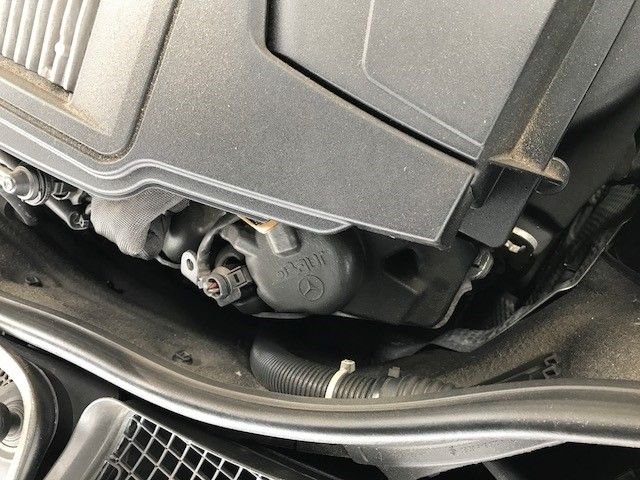

let me see if i take a pic and post it so everyone can see...i have no dip stick
Old 04-21-2017, 01:22 PM
g4life's Avatar
Join Date: Apr 2017
Location: New Jersey
Posts: 13
Received 0 Likes on 0 Posts
2012 S 550 4matic
No Dip Stick - front left side - as per manual
No Dip Stick- front left side - as per manual
No Dip Stick - rear left side - as per manual
No Dip Stick

Should be a dipstick tube rear left (looking in), possibly someone removed dipstick - part # 2780101472.

Its a blue handled dipstick and you have one. I have the same car. These cars burn through oil a bit and need an occasional top off. Pull over and throw in a quart of mobile one at your next stop.

I have a blue dip stick on the back of engine on drivers side but isnt that transmission dip stick

No, that is the oil dipstick, there is no tranny dipstick.

I promise you, it is the blue stick. Tranny on this car is sealed.

Correct. no filler/ dipstick on your 722.9 tranny.
Pull it out and see what's on it. If it is oil and smells like gasoline - it is your oil dipstick. If it is just a plug you have a 722.9 with a filler tube. I have seen a few of those unicorns. Very very rare.
