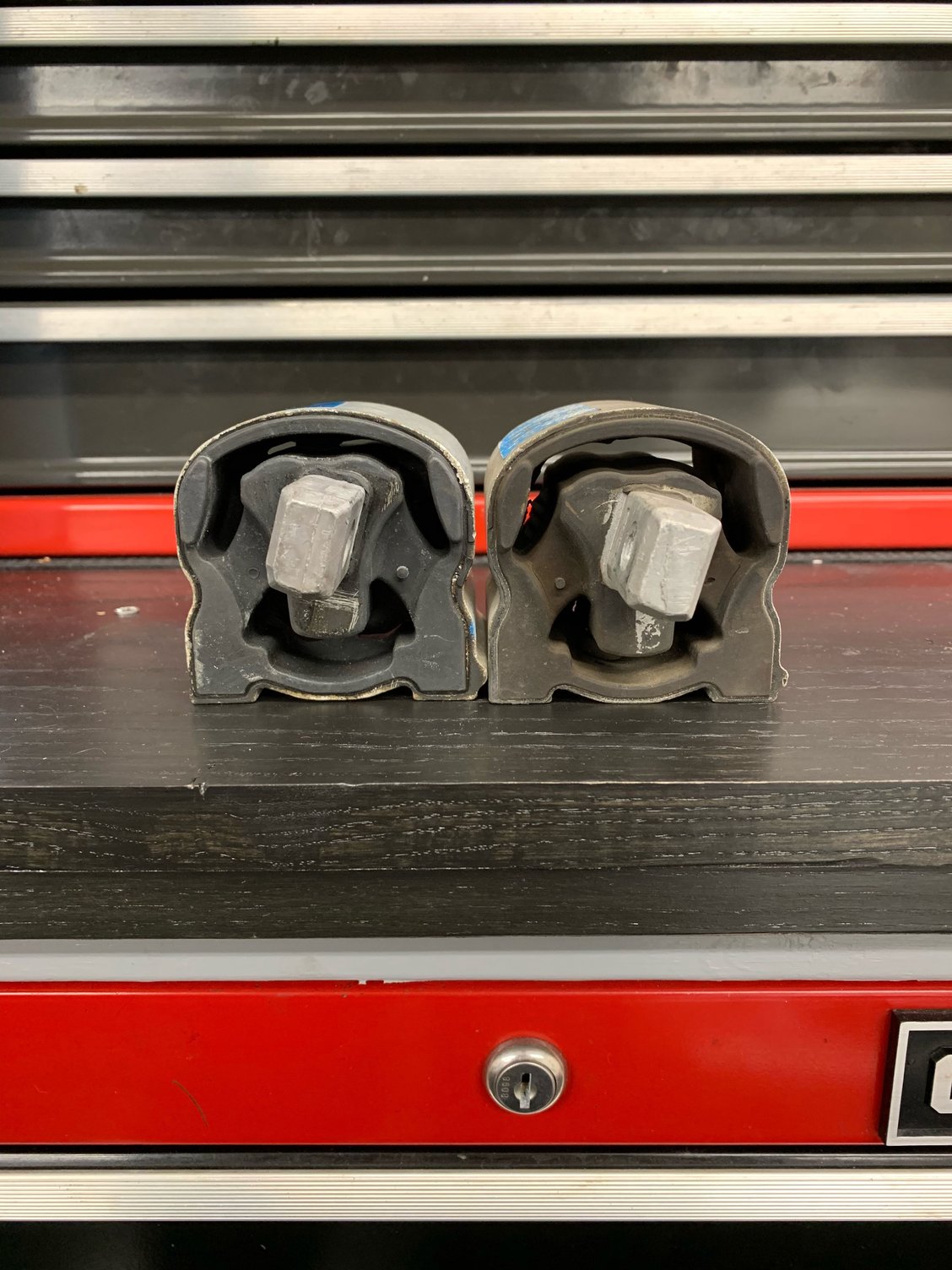

Tranny or rear mount changed
Changing the rear or tranny mount is a walk in the park.
Drop the cover panel using 8mm socket and the mount and crossmember are exposed.
My mount didn’t look too bad, I just went off a recommendation from a local shop telling me it was low. I took a before and an after photo, as well as profile of both side by side on the bench. The old one did feel a little more flexible than the new one and I’m sure I have improved the car.
The same shop also recommended the two engine mounts be changed. I doubt they are awful, however, they are now 10 years old and I bought new ones so I’ll get after those now. See photos.
Original mount
New mount
New on left
