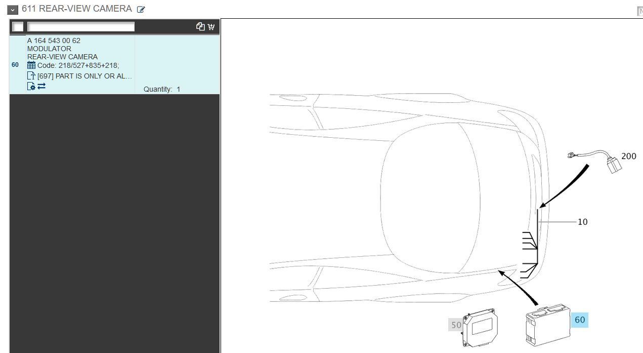

Mine has a blank screen with the guide lines showing so it would suggest a broken cable. I set about stripping the boot interior, checked the cable and found nothing amiss. Whilst in for service at the dealers, they ran a diag on it and it showed a fault with the modulator (Part No. MA164 543 00 62/62).
Could this be the relay? (I checked the fuse behind the armrest and it seemed good) Before I shell out for a new modulator and rip the boot apart again, if it could be the relay, that would seem to be a cheaper and easier fix. (1st rule of troubleshooting - do the easiest thing first!)

IMHO if fuse is fine, cable fine, and dealer diagnostic code confirms module, replace module. Search 1645430062 used i.e.: https://www.ebay.com/sch/i.html?_fro...acat=0&_sop=15

What is physical location for the modulator?
Old Oct 9, 2019 | 12:14 PM
konigstiger's Avatar
Posts: 15,901
Likes: 4,632
From: North Scottsdale, AZ
'71 Pinto
If you’re referring to 2010 CLS550 4M…

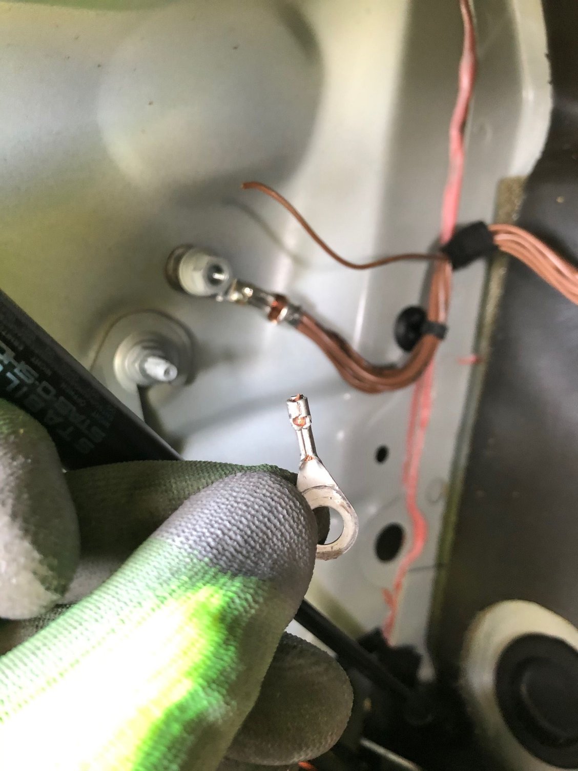

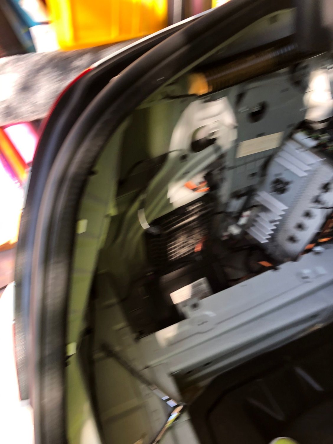

I had the same issue with a blank screen and only showing guide lines so I checked the fuses and all the connections were secure. The last thing I did was take the trunk apart and that is when I found this broken wire at the ground connect base. I stripped the wire and did a reconnection with electrical tape and it works perfect again. Here are the pictures of the location of the break. Taking the trunk apart is a little tedious, but it was worth it.

wire breaks are normal on merc rear cameras
