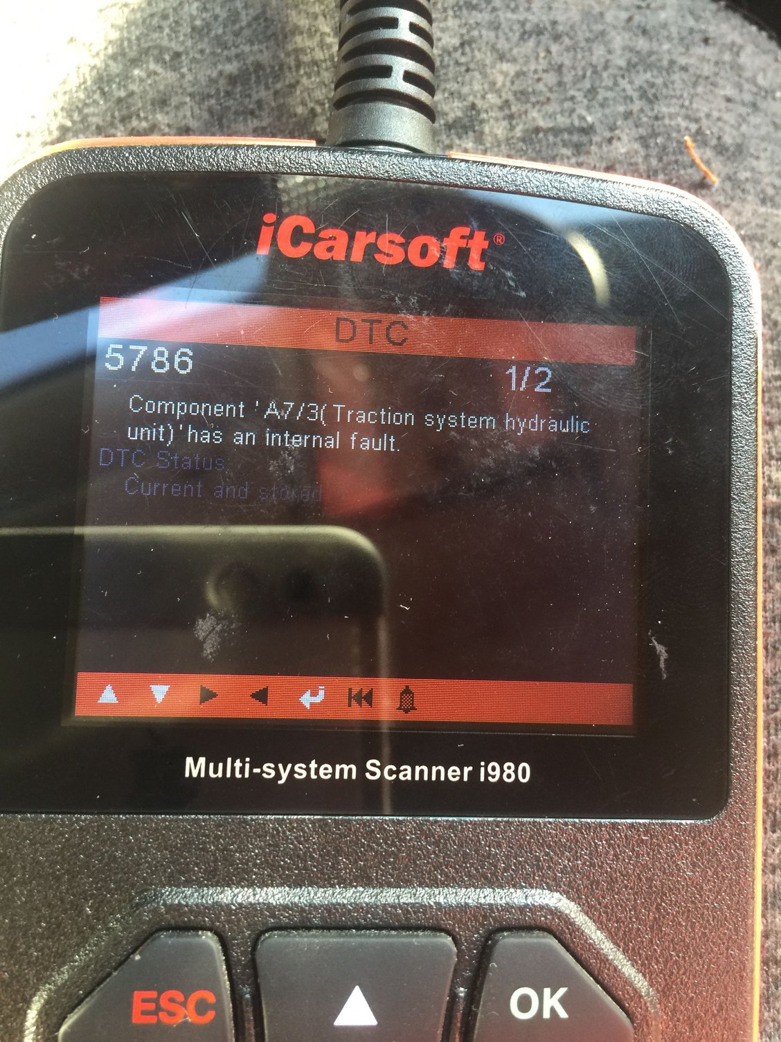

well i got the traction control error error from my anti-lock braking system. It says internal error. Needless to say has anyone encountered this issue and if so did you have it rebuilt or just bought brand new? Attached is the picture of the scanner with the code for it.

If all you need is the hydraulic module (pump, block) I have one here. I bought one with the controller because the seller swore it could be programmed for my car (he lied). This is the one that was originally on my S600, it’s fine. PN is A2214310512 — that’s the pump module, not the controller.

awesome shoot me an email at clabruno147@gmail.com . I attempted to recalibrate the unit not sure it’s going to work but it’s worth a try.
