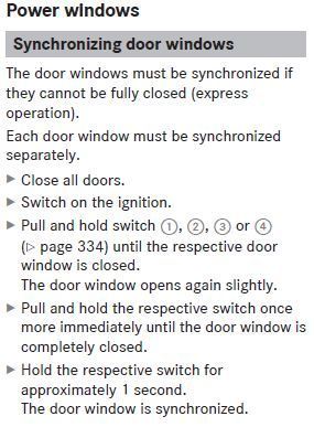

When I fully close my driver's window it will automatically lower to maybe 2/3 closed.
I didn't find any obstructions. Does the mechanism need to be re-initialized?

Resynch. If first attempt fails retry several times. No success have someone check for door control module software update SDS menu path: Control units - Seats and doors - DCM-XX – Door control module (Choose DCM with the issue) - Control unit adaptations - Control module programming.

Thank You! Worked like a charm :-)
