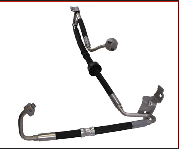

Originally Posted by vettebk
My main hose gave out (the silly thing is 300 psi)
Is this the main hose on your S600? Help!!! Power steering blew up!-photo170.jpg
Do you have to remove any other components to get the hose off?

Originally Posted by DrDoe
Is this the main hose on your S600? Attachment 426068
Can anyone tell me the part number of this hose?
Old Jul 29, 2020 | 03:36 PM
DrDoe's Avatar
Joined: Jun 2016
Posts: 589
Likes: 60
From: Snowville, ID
W212 E350; W166 GLC300; W164 ML550; W164 ML63; W221 S65; W220 S430; Escalade ESV
That's Pump to Front Axle Valve Block
P/N: 2213203672 Rein Automotive
