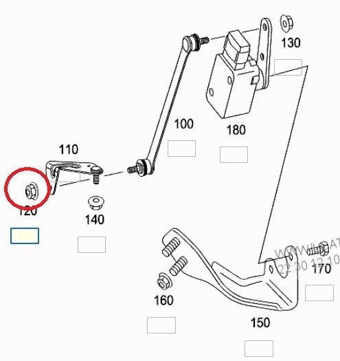

We must be talking about different parts. I replaced the bar in the picture below by only removing the bar (labelled 100) and the sensor (180). Left the brackets alone (110 and 150) as they weren't damaged. Getting the bolt in red off was a pain as it's up against the suspension and hard to reach, and very rusty.

not sure that's the correct drawing.... but lets go with it. 110 is the bit that breaks and is almost impossible to fit on the rear anti-roll bar.... it gets stressed when the ball joints on part 100 seize and must be replaced
